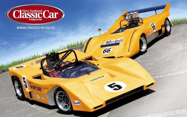

Well the proof is in the printing as they say, finaly got the artical into the magazine and am now feilding calls `why is your Mclaren called a McCopy`. Cover shot and 8 pages and yes I know I am biased but so much more kudos for the McLaren name could have been made if they had accepted that the car has been built as a tribute car, nothing else. I think the cartoonist summed it up pretty well. Silly thing is that a lot of good energy has been lost, never mind I am now enjoying the fruits of my endeavors and it will be interesting to see if the car is allowed any where near next years McLaren reunion here at the new Hampton Downs race track just South of Auckland where they are expecting many `genuine` Mclarens from overseas to compliment the customer car M12 and the rebuilt M8 A that the Mclaren Trust has. Funny it looks just like mine..:lipsrsealed:
Dave
I have had so much fun and positive reaction by calling it the `McCopy` that it almost seems right. Certainly the establishment has lost out on a heap of good will.
