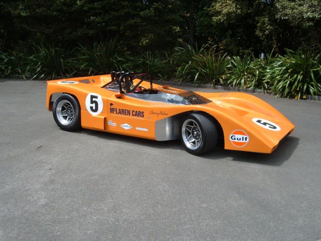

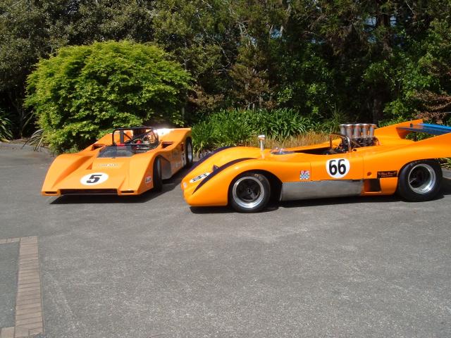

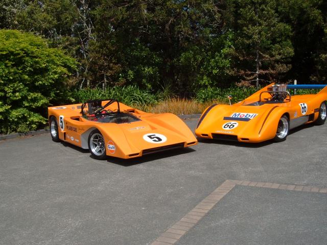

Just had the car photgraphed today alongside the Brian`s M12 and it was interesting at the size comparisons. My car looks smaller but actually has a 50mm longer wheel base and is just a bit narrower accross those FAT rear tyres. Both are painted`Mclaren orange` and both are a different shade!!

car looks absolutely fab in pics mate, you should be very proud, cant wait to see it in the flesh.
regards john
Hi Russ,great photos and you must have been chuffed to have them taken together like that.And yes that great "Mclaren Orange" colour,it seems everyone has there own shade.Cheers Leon
