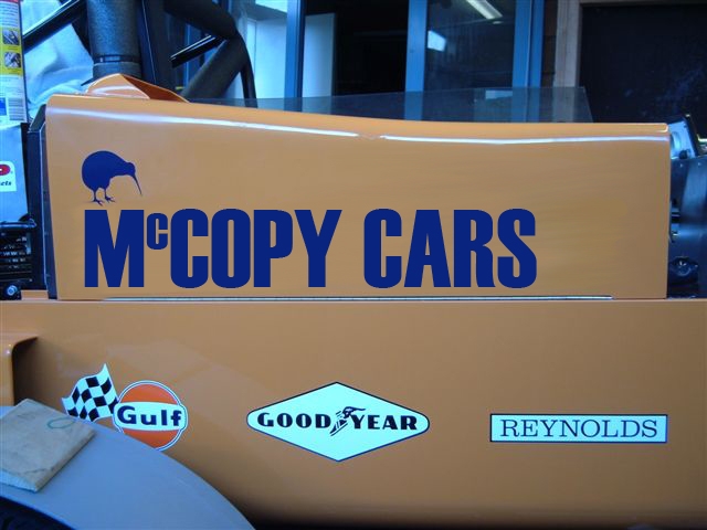

Well I have had my high tea and bikies with the Mclaren trust who are a little concerned that there is considerable confusion with my car being mistaken for the real thing by an important person who I shall not embarass! and was also informed that Ron Dennis has asked for me to change it. Not wishing to cause them any grief, I have made a suttle change for now. It will now be quite a discussion point as to why when people see it so just for fun...
Your comments have given me further amunition.

Russ, I like the McCopy ! Ron Dennis should be more ashamed of that than McLaren Cars sign you used. It's a shame it's come to this though. If Bruce was alive today, this crap wouldn't happen I bet ! I met Bruce and Tyler Alexander a number of times back in the '60's when they came to Tyler's parents house in Hinham, Massachusetts. Did some fiberglass work on one of their cars. Great times !!!
McLone / McLaren / McCopy
I'm with Bill.. Bruce would have seen this as it is - a Tribute!!!!
Pete McCluskey.
Russ, look upon it as a tribute to your skill and the job you have done in constructing the car. Such pettiness from Mclaren, a shame.:sad:
I agree Pete! It's a shame.:!blank:
