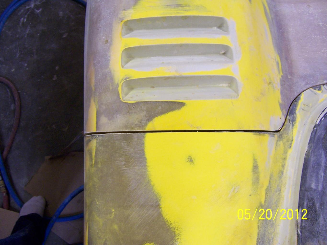

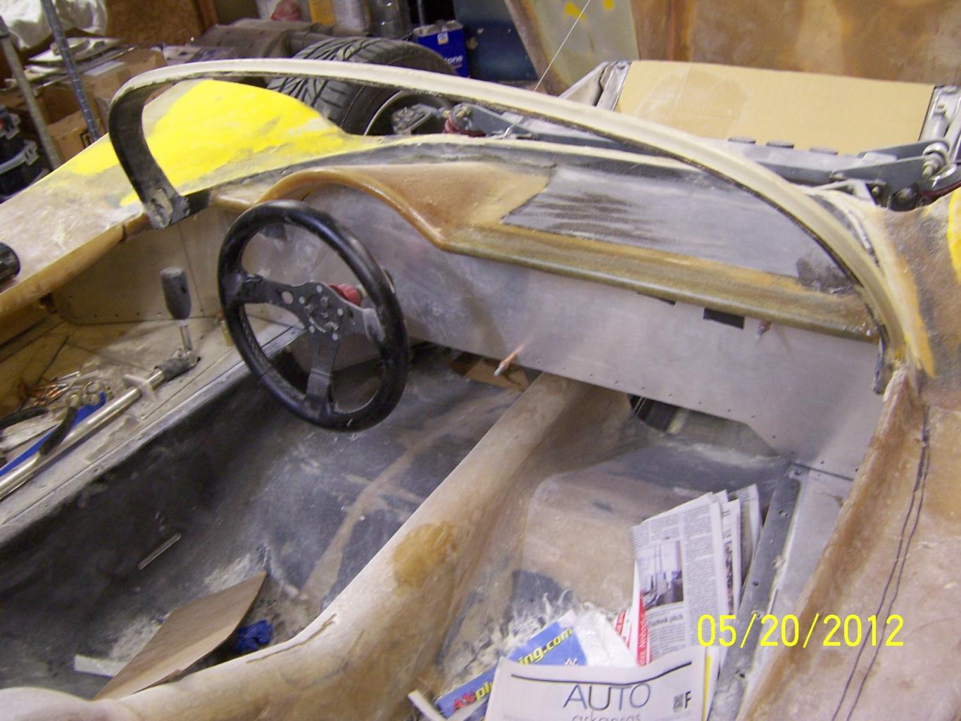

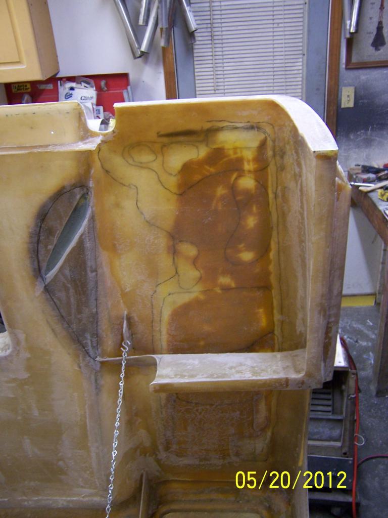

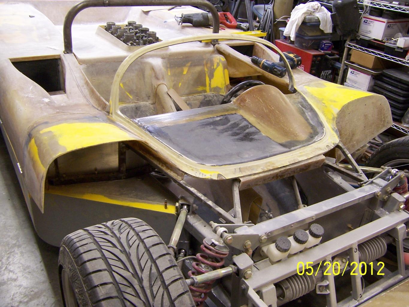

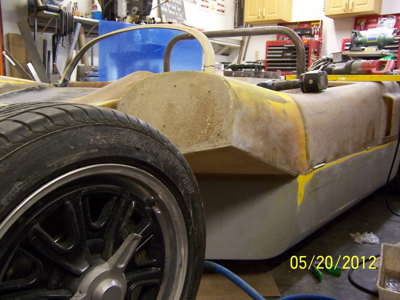

I've slowed slightly on the work...due to work...but the type of work I'm doing is the very time consuming under-body work that makes for the functionality of the body. It's taking as long to do all of this as it did to simply build the shape. This includes all the flanges used to locate and mount the body, reinforcements needed to keep the body rigid at speed, keeping all gaps at 1/8", and dash-cover work to make the car more appealing for the street. And least we forget the windshield for the street portion of the driving (I'm having to compromise on that being there is just not a lot of options out there for that. So even though it looks like nothing has been accomplished from the outside, looking under the body shows my last 8 months work.
