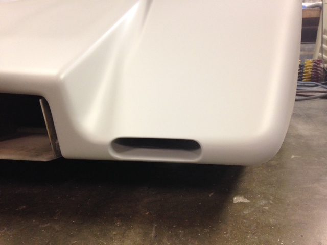

Making progress on sealing the bodywork. The scoops have finally been finished into the nose corners, and a lot of time is being put into ensuring all gaps are even and adjacent panels perfectly aligned from one panel to the next. This is where the time is getting consumed on attaining that last 10% of quality in the body details, fit, and finish.
I'm still wresting with the headlights. I want (need) them on the car being this will be street driven. There is little chance of night driving, but local requirements dictate working headlights. There isn't much tire clearance under the panel for retractable headlights, even with the small projection units commonly available. It would be easy to simply insert a headlight bucket and cover it with acrylic, but I'd like to keep the front nose visually "clean" of any fixed headlights.
Can you provide some receivers and electrical receptacles to plug in some lights? You can just snap them out and store them during the day. You could argue it is no different than pushing a button to open the headlight doors on an old Stingray, only you are getting out of the car to do it manually.
Terry,
You have about the same slant that the old Lotus Turbo Esprit had. You could fix a flip up light like they used(or find them on ebay and glass them in). Looked terrible when they were up but during the day they were hidden and didn't break the visual appeal of the front. You should be able to do something like that. If it was good enough back in the 80s it should hold for today. If you need it for registration then you have to do something. Otherwise you don't need them exposed to drive around during the day. Half of them never worked right anyway.

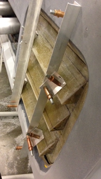

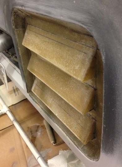

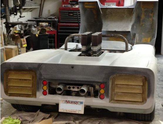

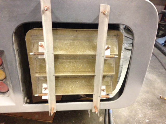

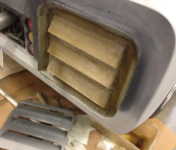

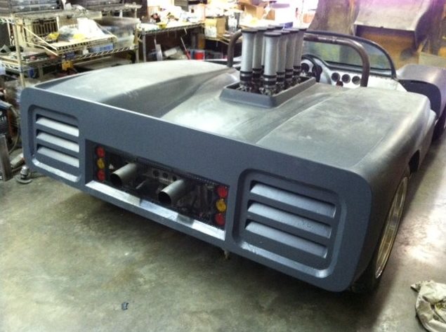

The more I looked at the rear vents on my project, the less I liked them. They did resemble the later M8 series rear venting, but this project needed the early vent design. So I set out to spend a weekend fabricating some rear vents that actually do justice to the early M8 series rear vents used on the McLarens. I molded the individual slats, bonded them to a plate, and then cleco'd the plate to an aluminum frame that held the fiberglass vents perfectly in place while I bonded the picture frame around it.

Hey Terry, I like what you have done with the vents, every time I see your car i keep thinking there is one piece missing ??? I think it needs the little rear hip spoiler that the M8As had, I think a big M8B wing would be too much but the M8A spoiler would look good. I'm thinking it's probably starting to cool down over there now so do we have to wait till next summer to see it painted??
I have been pottering away in the workshop but nothing to really show and I know how you like pictures, i have been sorting selecter rods and shift forks on the T/A so not much on the car as such. I want to get the B/H cast so I can get this thing to rolling chassis stage which was the goal for the end of this year could still happen with luck. Keep up the orange car front for the rest of us mate. Cheers leon

Leon, Yes, I've got some 3/8" and 1/2" foam sheet used for composites that I've set aside solely for the purpose of the "A" rear spoiler. I agree that the wing thing would be too much, and the the "A" spoiler would be a good balance between too much, and not enough. So with the cooler weather, I'm returning to the mechanical issues that need to be taken care of (sway bar brackets and bars, dry sump modifications, head lights, and perhaps exhaust modifications for the mufflers.
