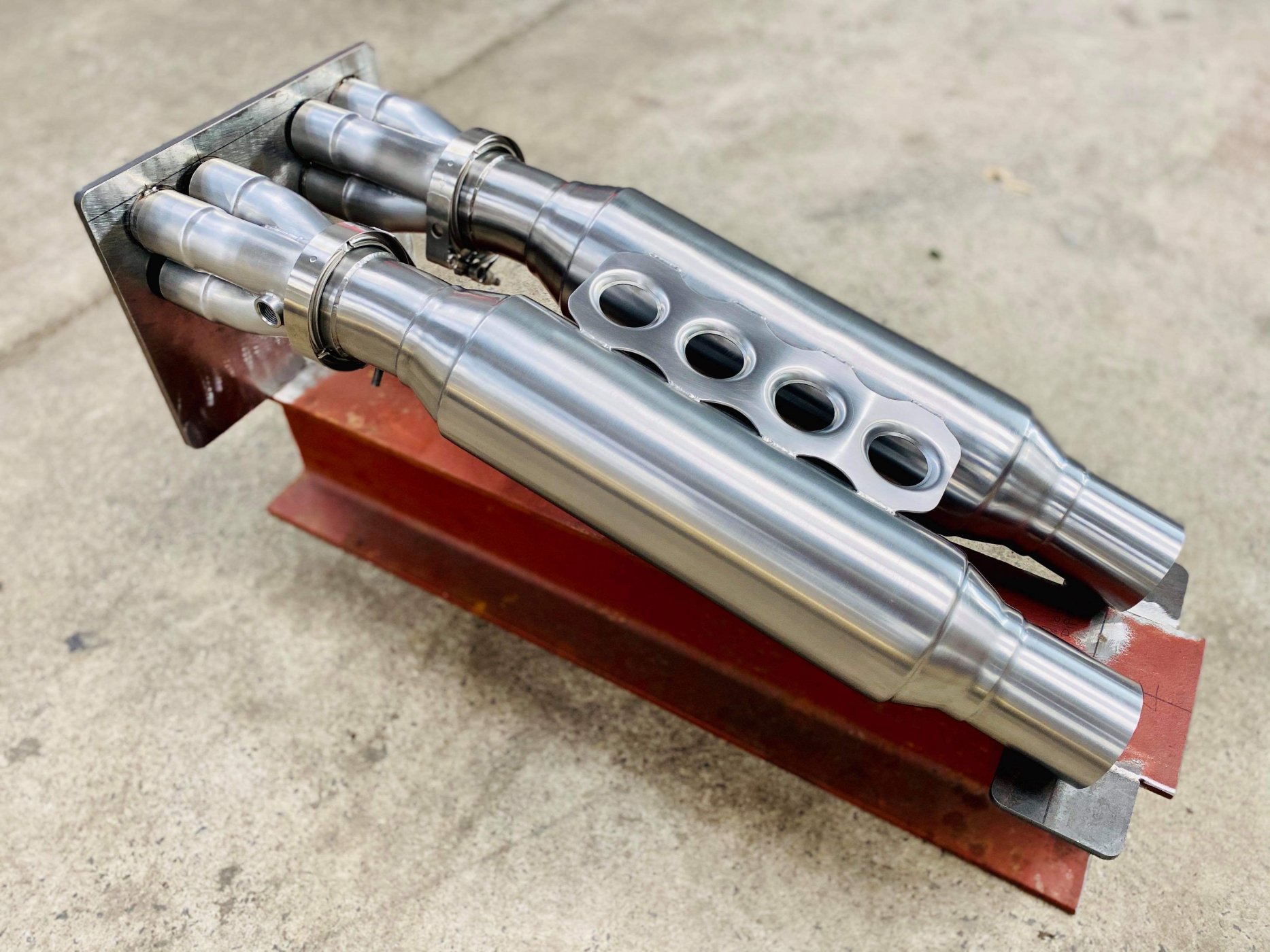

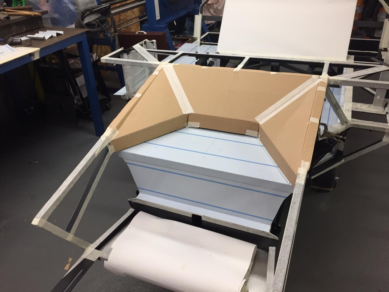

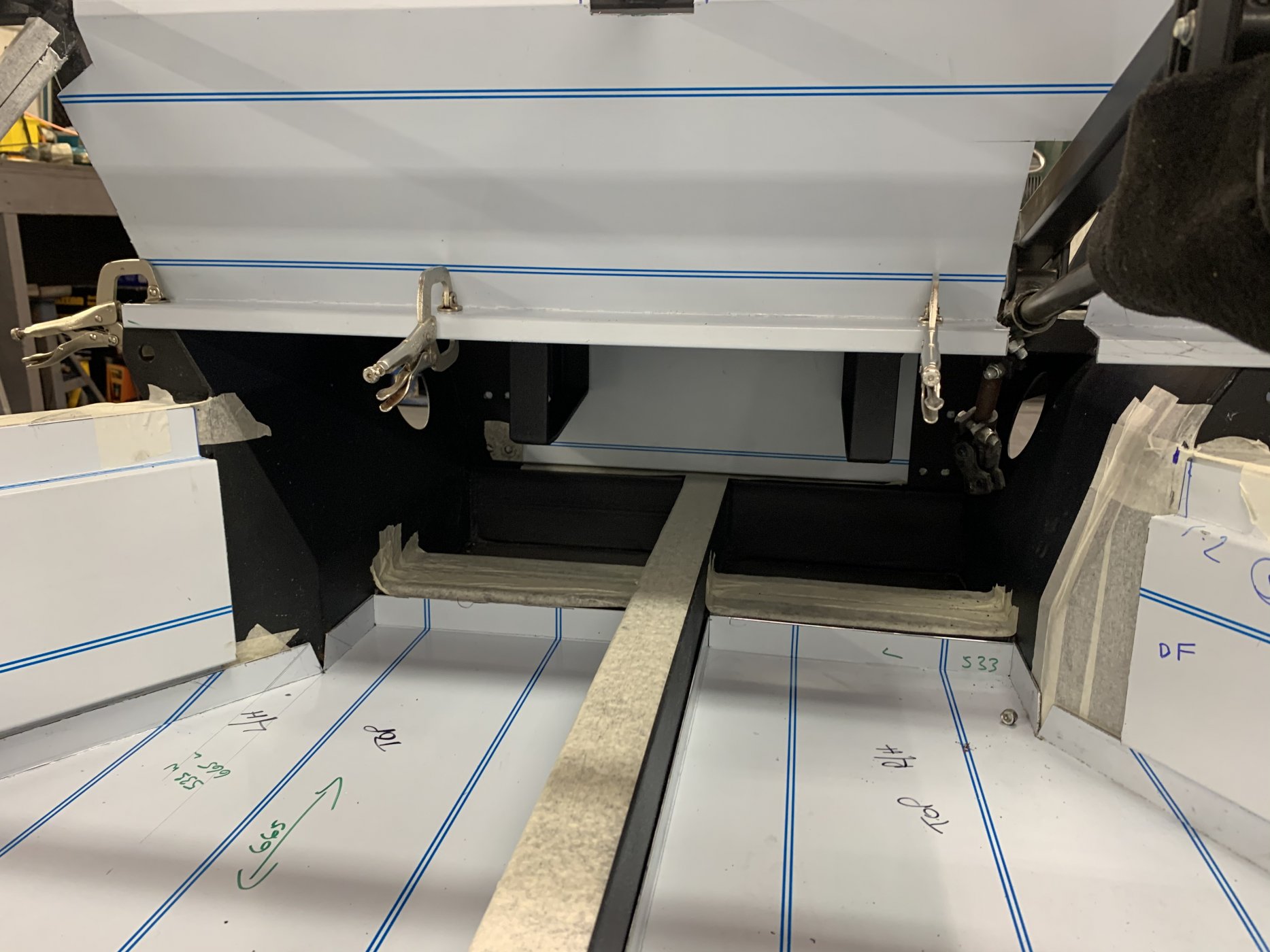

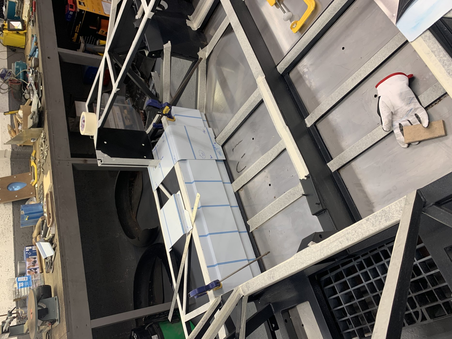

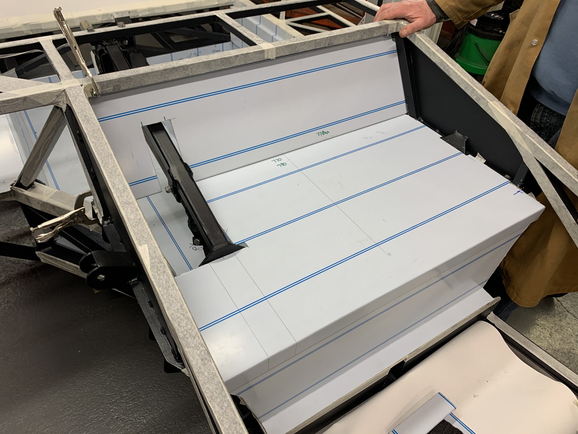

I’ve been busy trying to create nice shapes from aluminium. I am rolling the inside edges on the sill panels to mimic the centre tunnel. I’ve also decided that in the front area I am going to replicate the curved panel as is in the originals. I believe this is where the spare wheel was. The hours you can lose in a build like this is unreal.

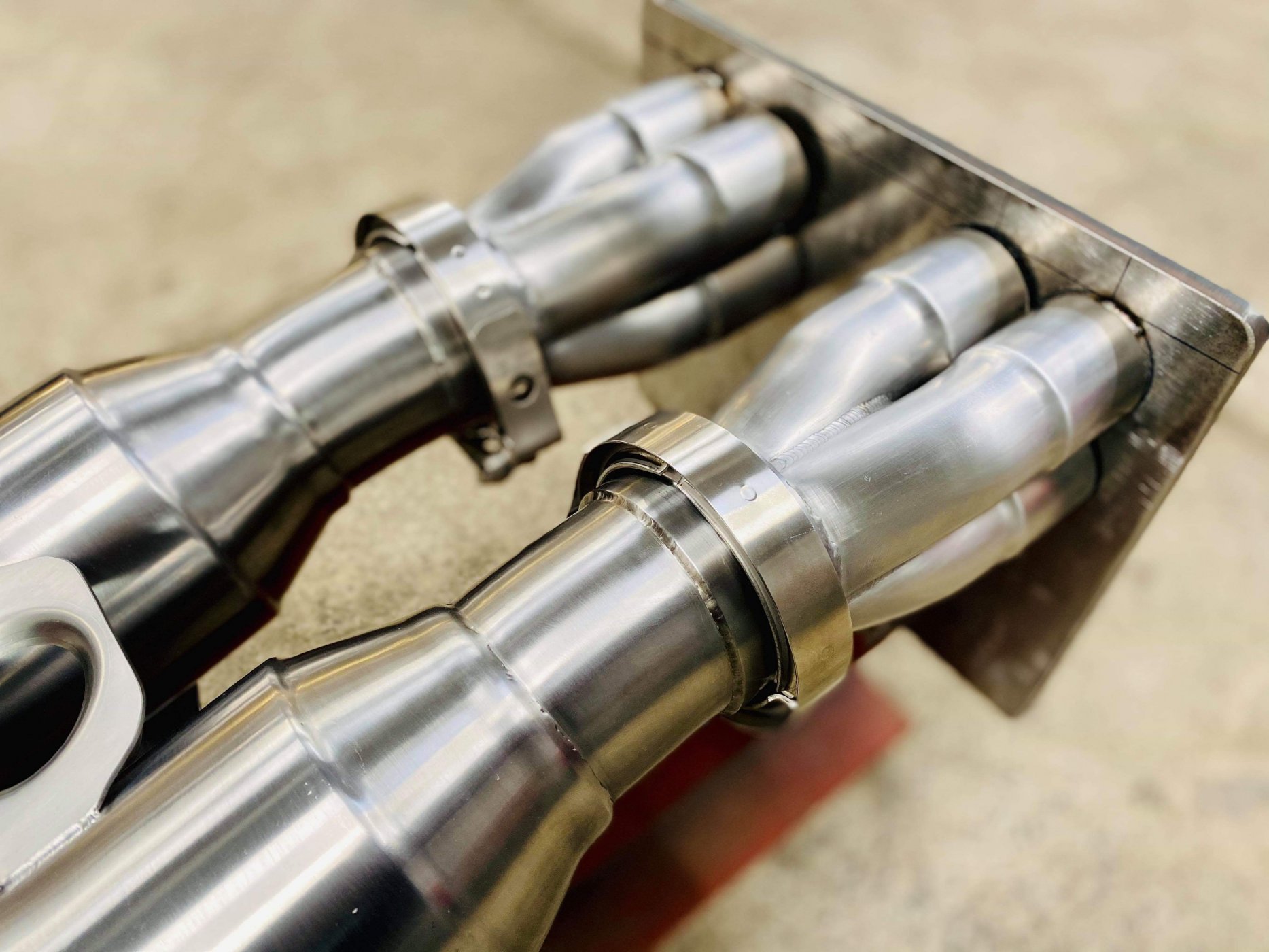

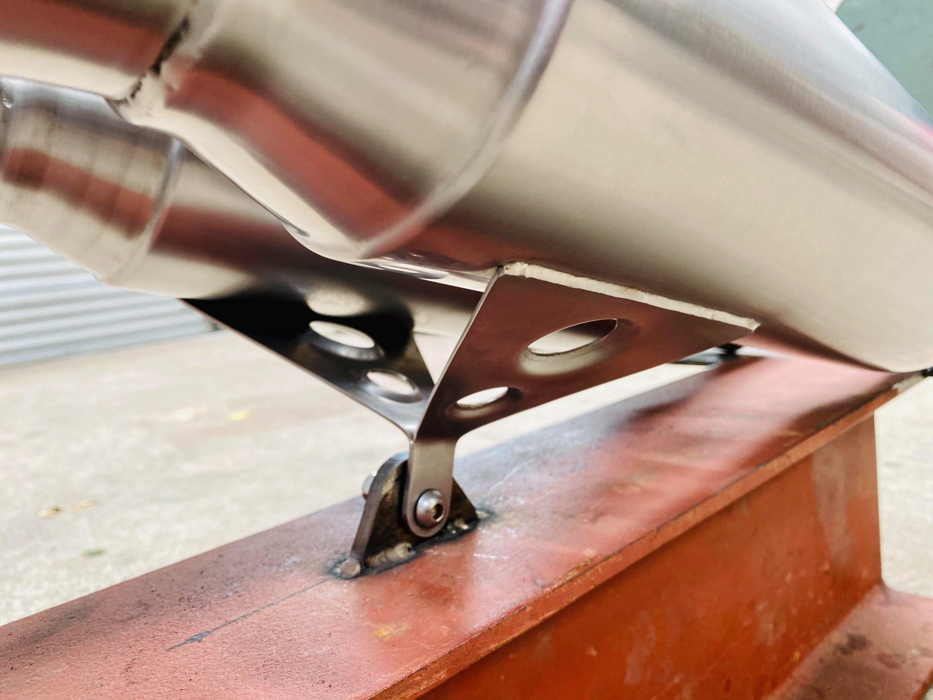

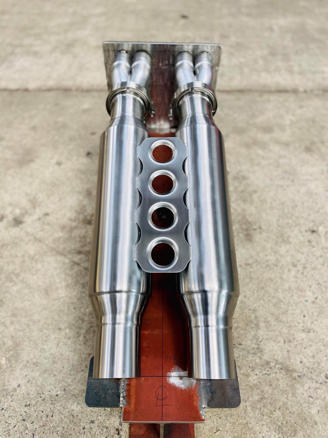

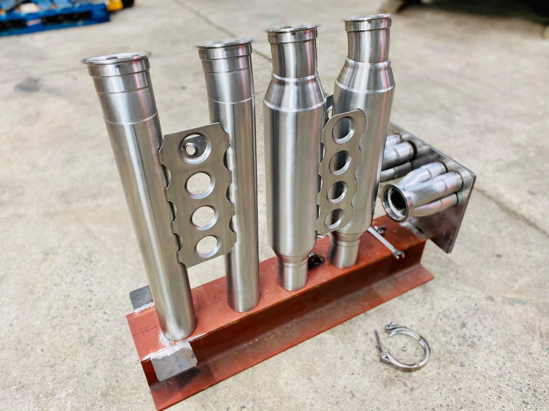

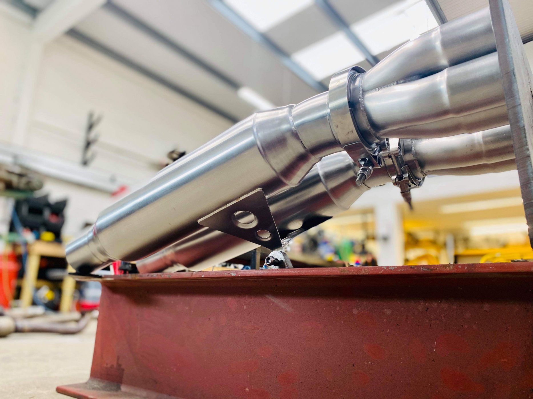

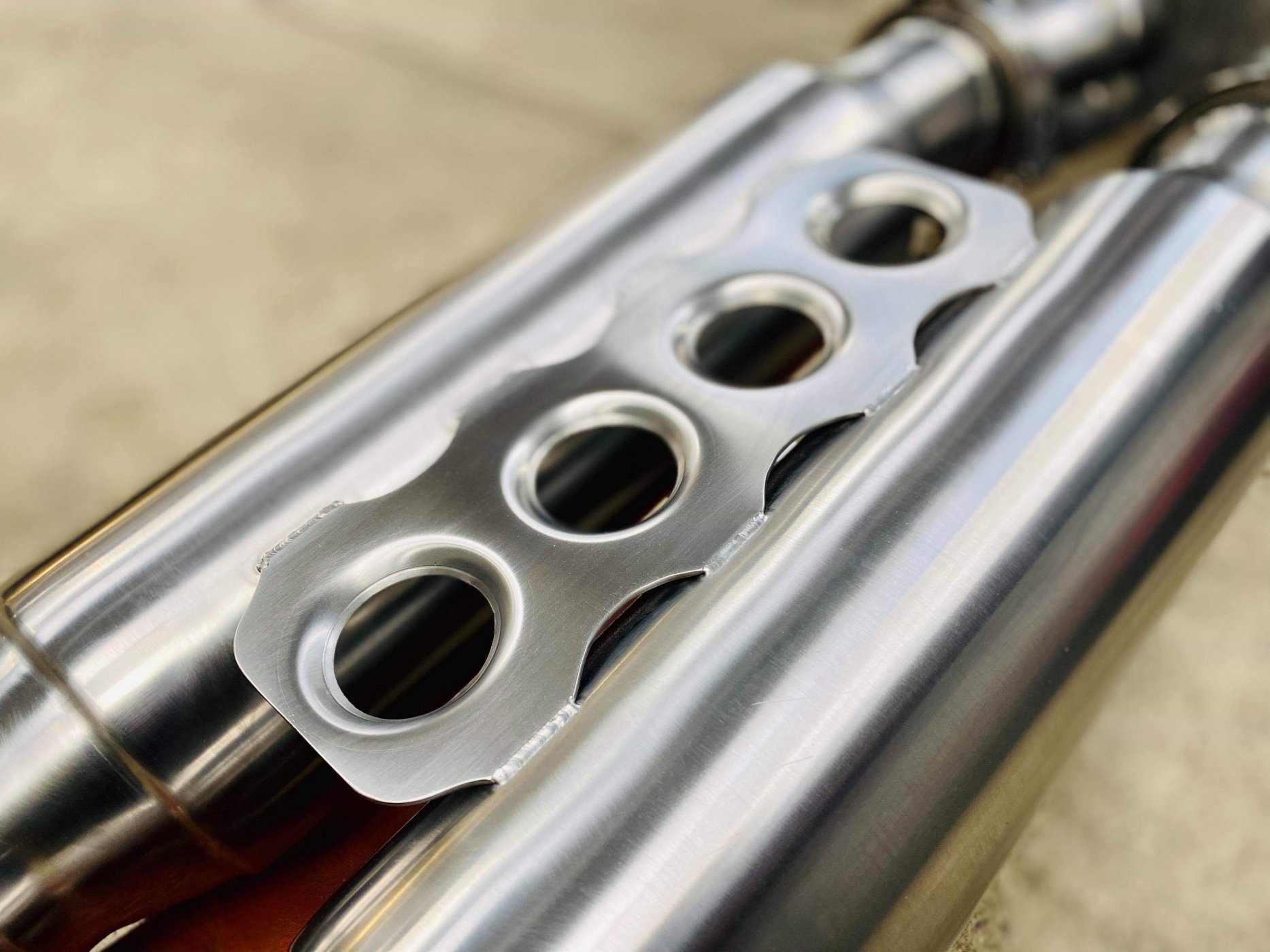

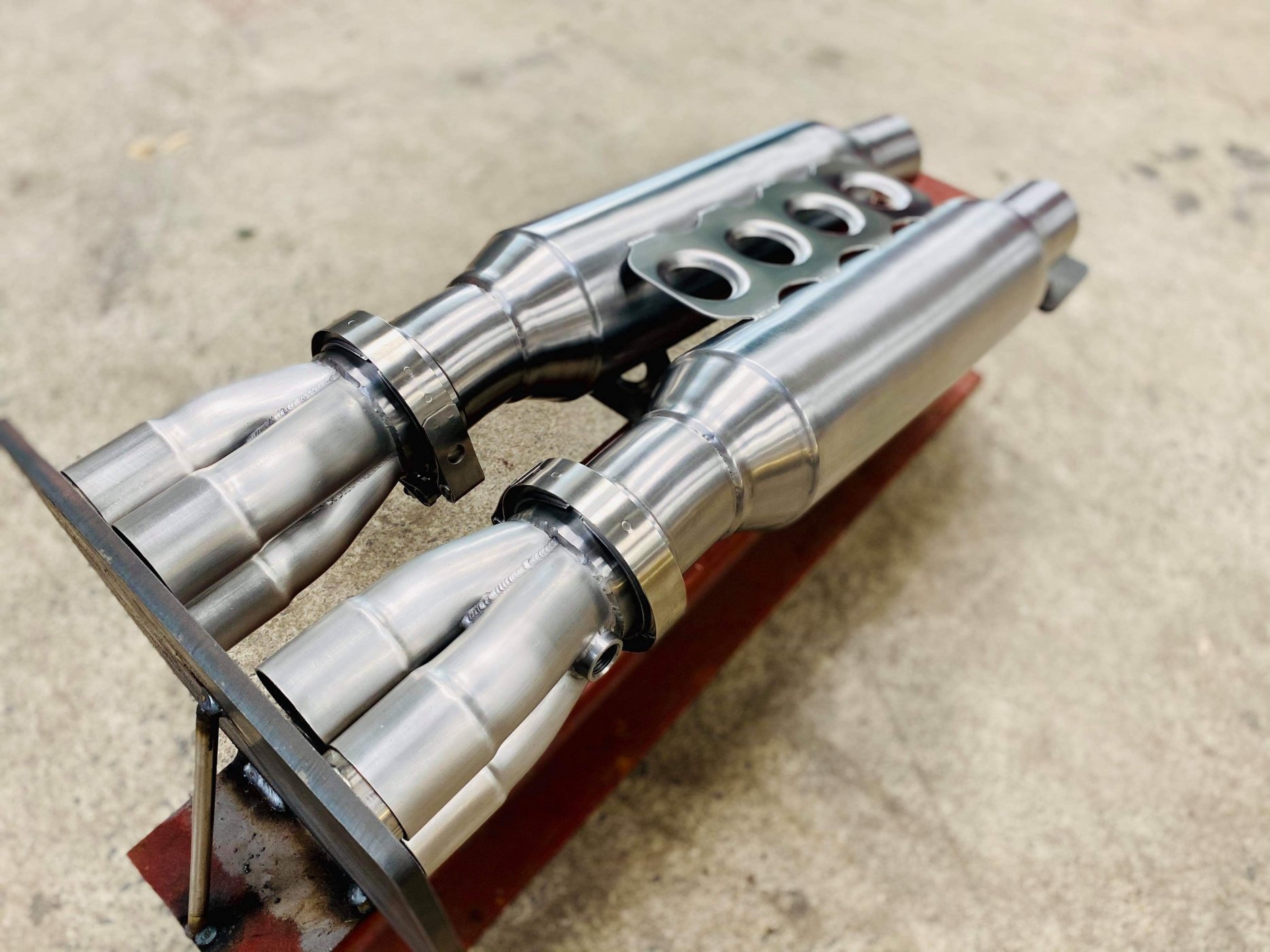

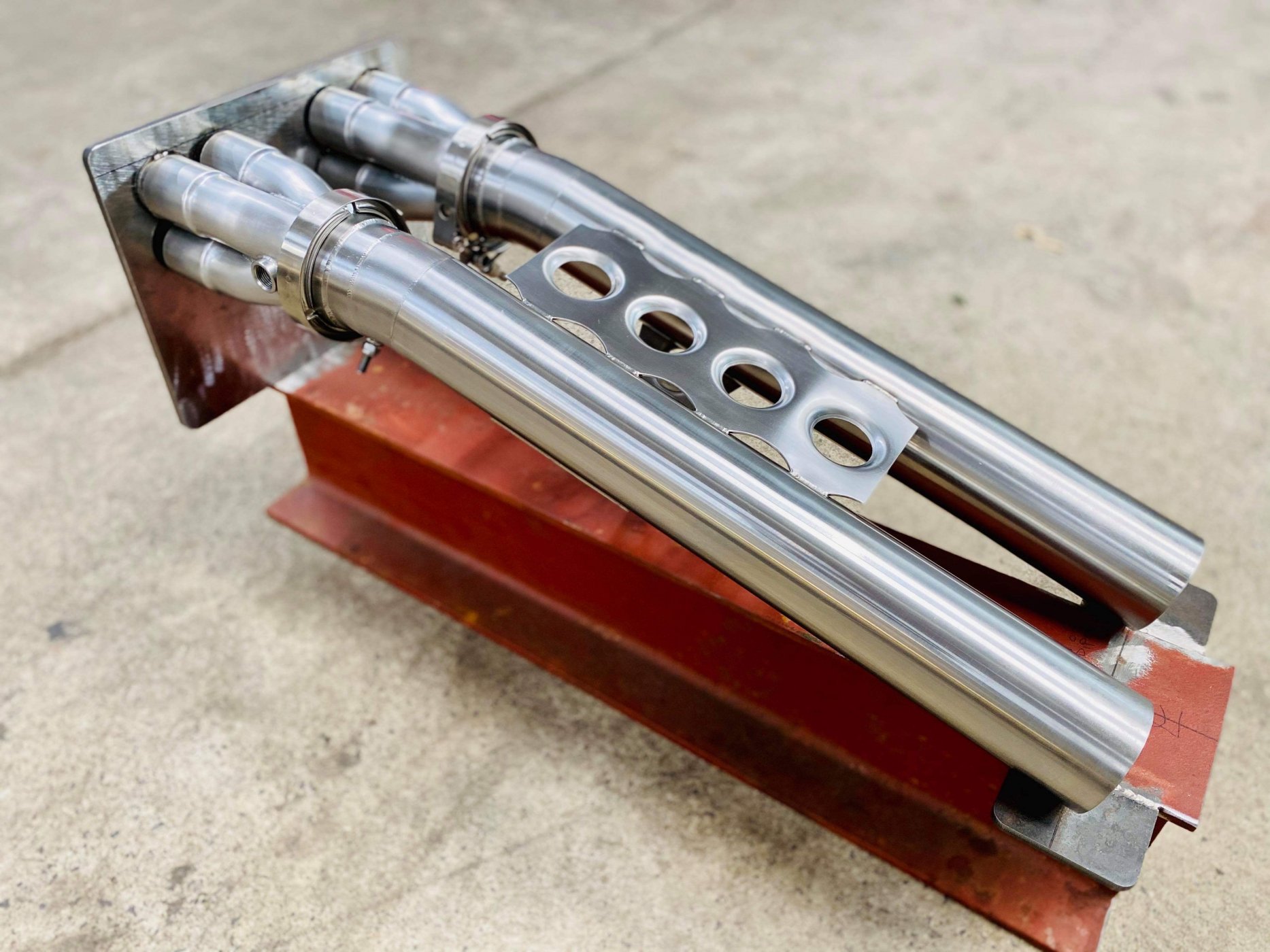

I couldn’t decide if I wanted a straight through pipe or slightly silenced. Luckily I have a talented pal who made me up one of each. Cannot wait to bolt it on the block.

Beautiful work Jack, but I would be concerned about the position of the O2 bung, should be raised at least 10 degrees above horizontal to prevent moisture from destroying the sensor.
Thanks Michael! the sensor is in the same position as the original one. I shall keep an eye on it though.
Hi Jack,
Sensor in proposed position will be fine, Mine’s in exactly the same position and has now done 10,000 miles and still works fine. The heater element in the sensor are sensitive to moisture, so the installation needs to prevent condensation building up in the unit.
Also regarding the starter motor, modern gear reduction motors, have a higher torque capacity, can spin the engine faster and are generally lighter
Andy

As you’re all aware I am currently forming the aluminium panels around the chassis. The front section is definitely a frustrating part. I want to create a similar look to what the original car had with the spare wheel section but the steering column is proving this to be difficult. I also plan to leave the remainder of the front open instead of closing it in like it was before.
Have anyone made any differences to the front and if so do you have any pictures to share?
