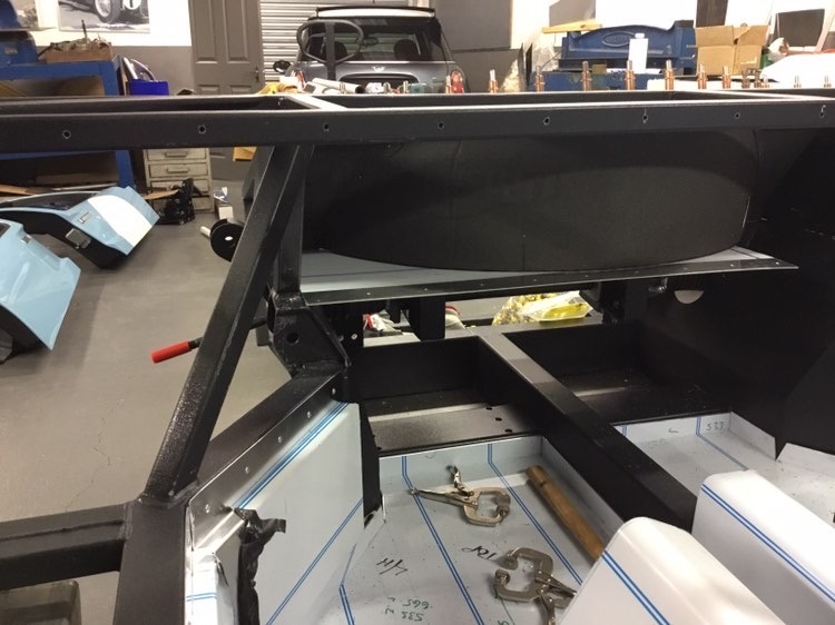

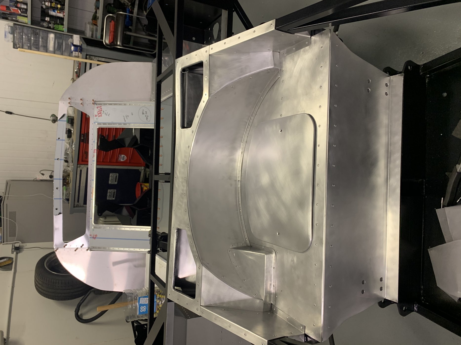

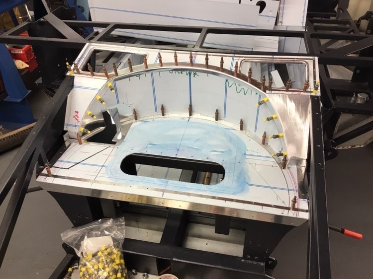

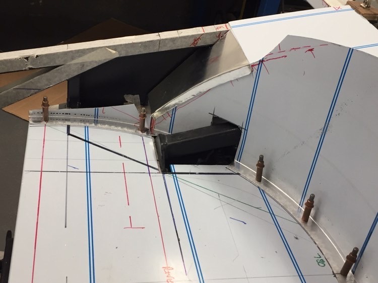

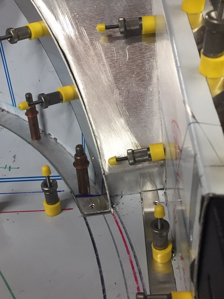

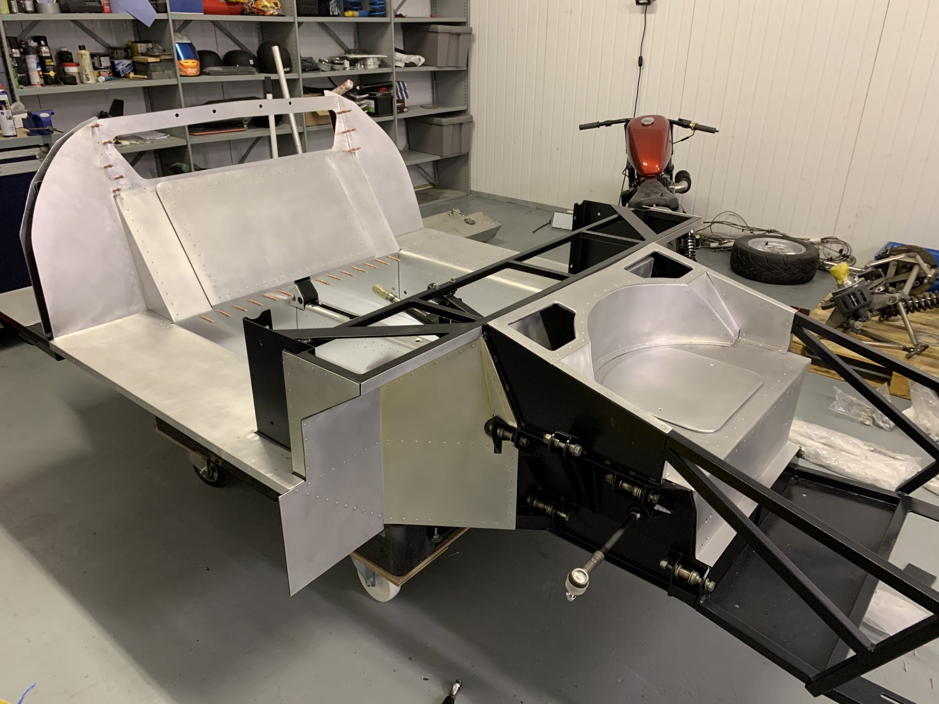

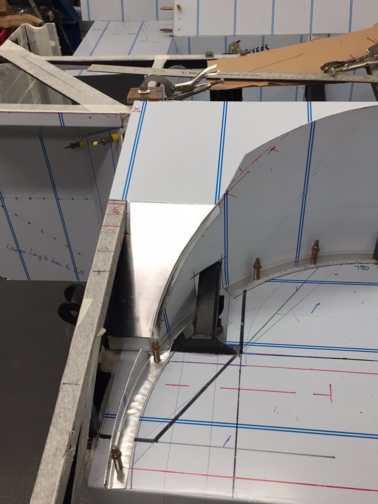

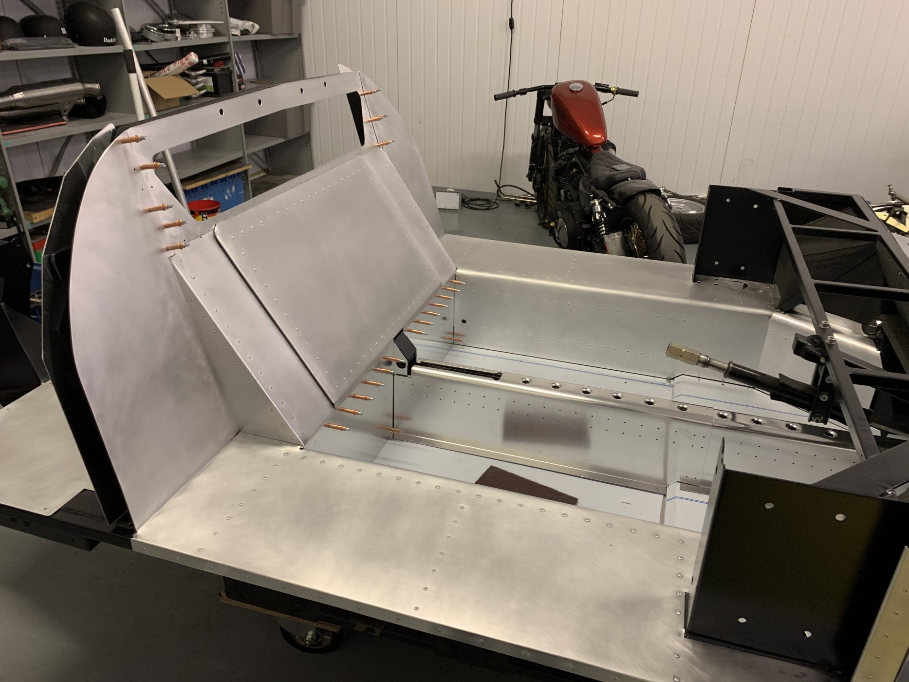

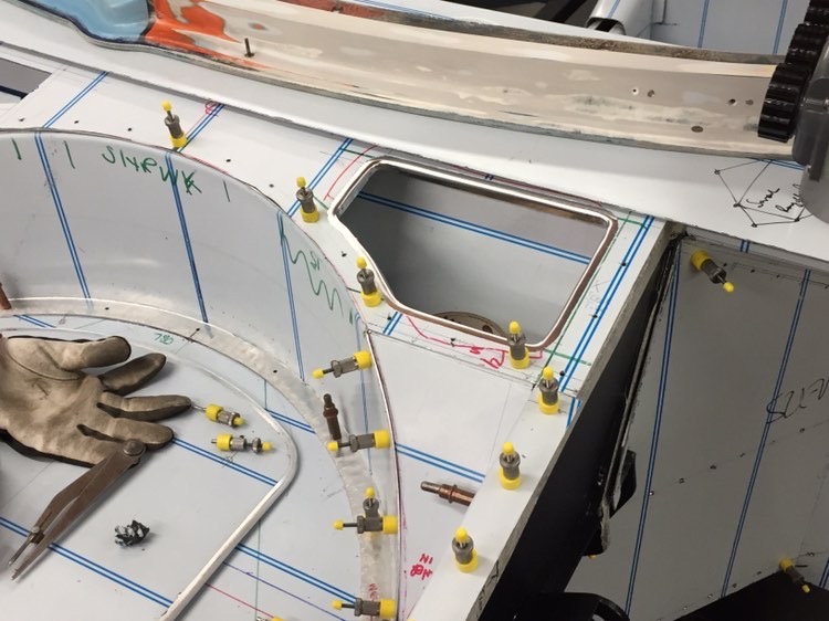

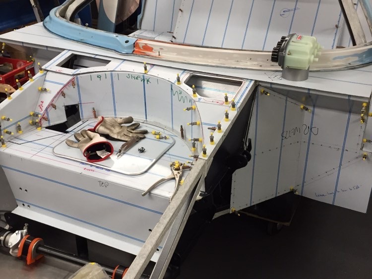

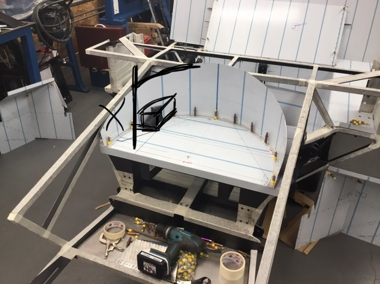

Back to business. I have been working on the front “spare wheel” section in the front of the car. Trying to replicate what the original car had without making it look like an after thought is an absolute pain in the arse. Especially with the steering column on the MDA/GTR chassis being so bizarrely situated. I will enclose the little section that is stuck out and also replicate this on the other side.

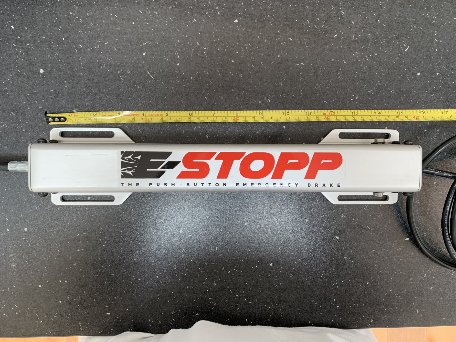

I have started to rivet panels in place now, I have used the Dynamat foam product behind all panels and it’s really helped to reduce the “tinny” sound. Would really recommend this product. I have also decided to do away with the hand brake and have ordered an E-Stopp electric parking brake. They seem to be widely used in the states and I did think it would make stealing them car an absolutenightmare if you located the button out of sight.

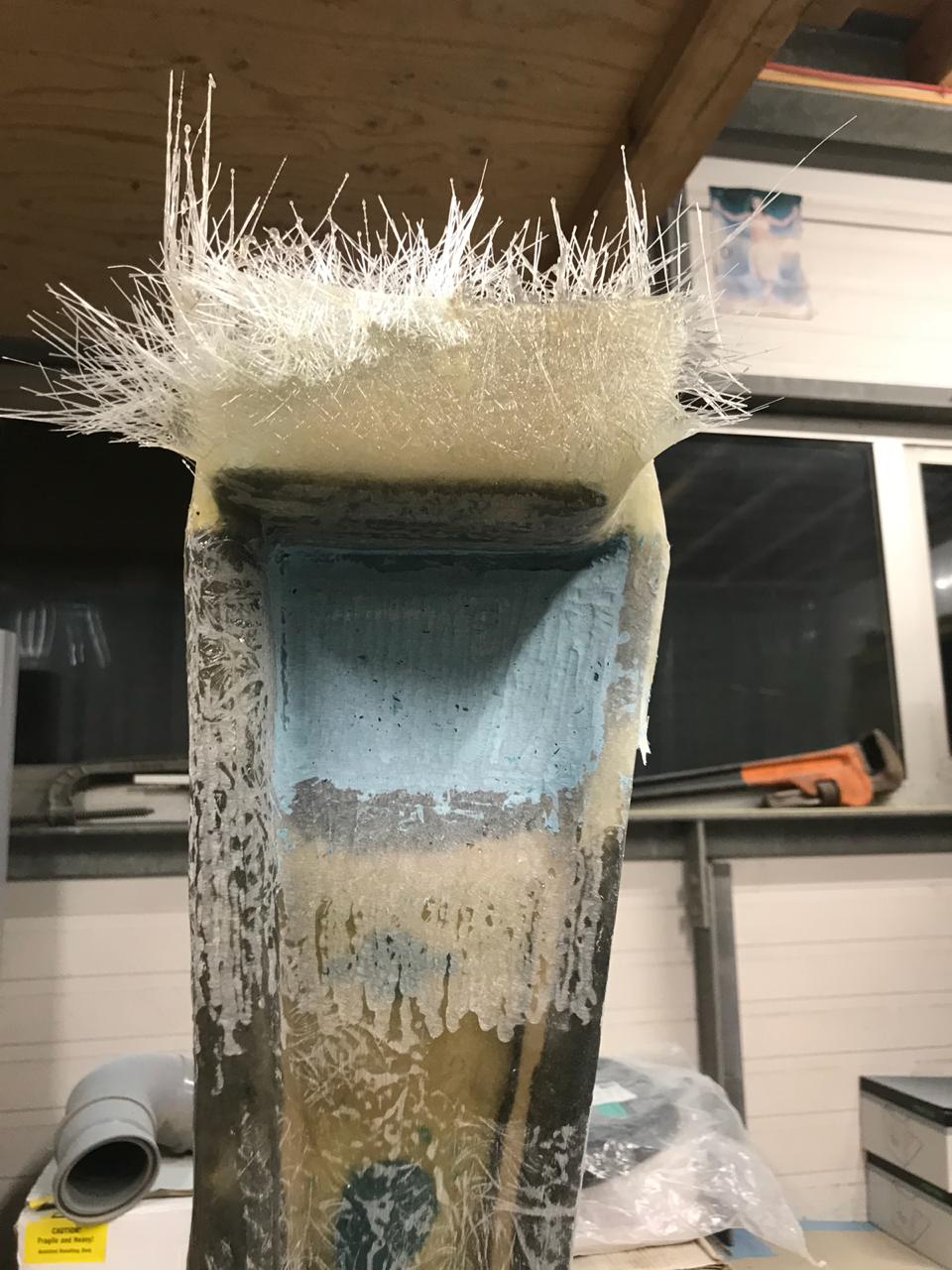

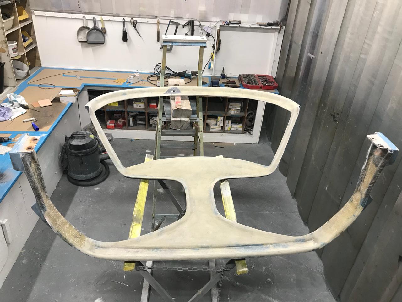

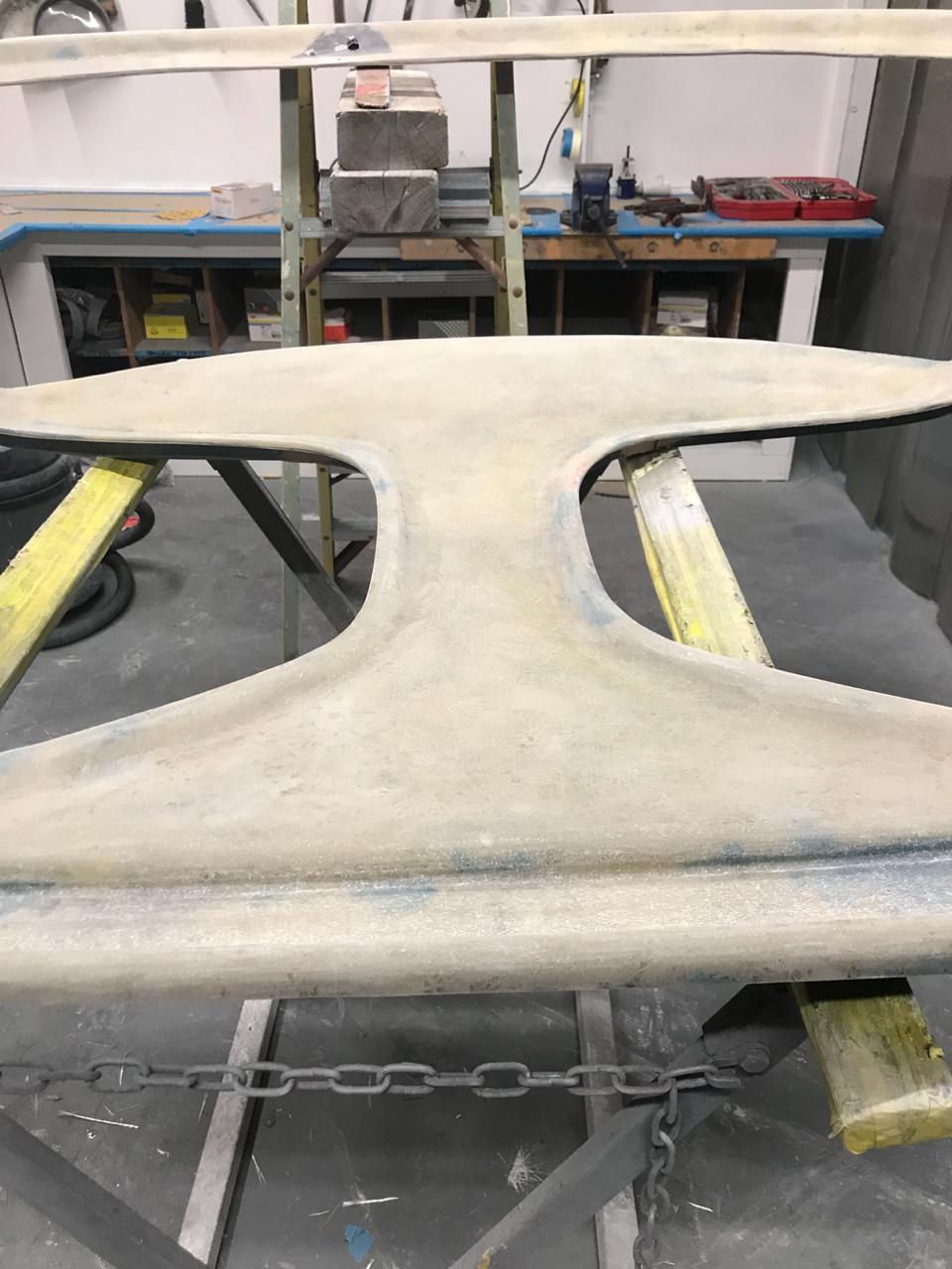

Lastly I have almost finished the “spider” glass work. It had pretty much delaminated itself and the fixing mounts where joins to the chassis were almost non existent.

I'm not sure the E Stopp will be acceptable for an MOT in the UK.
Has to be a separate system to the normal braking system.

Hi Ian
EStopp works on separate calipers to your primary ones. I have Lamborghini huracan parking brake calipers.

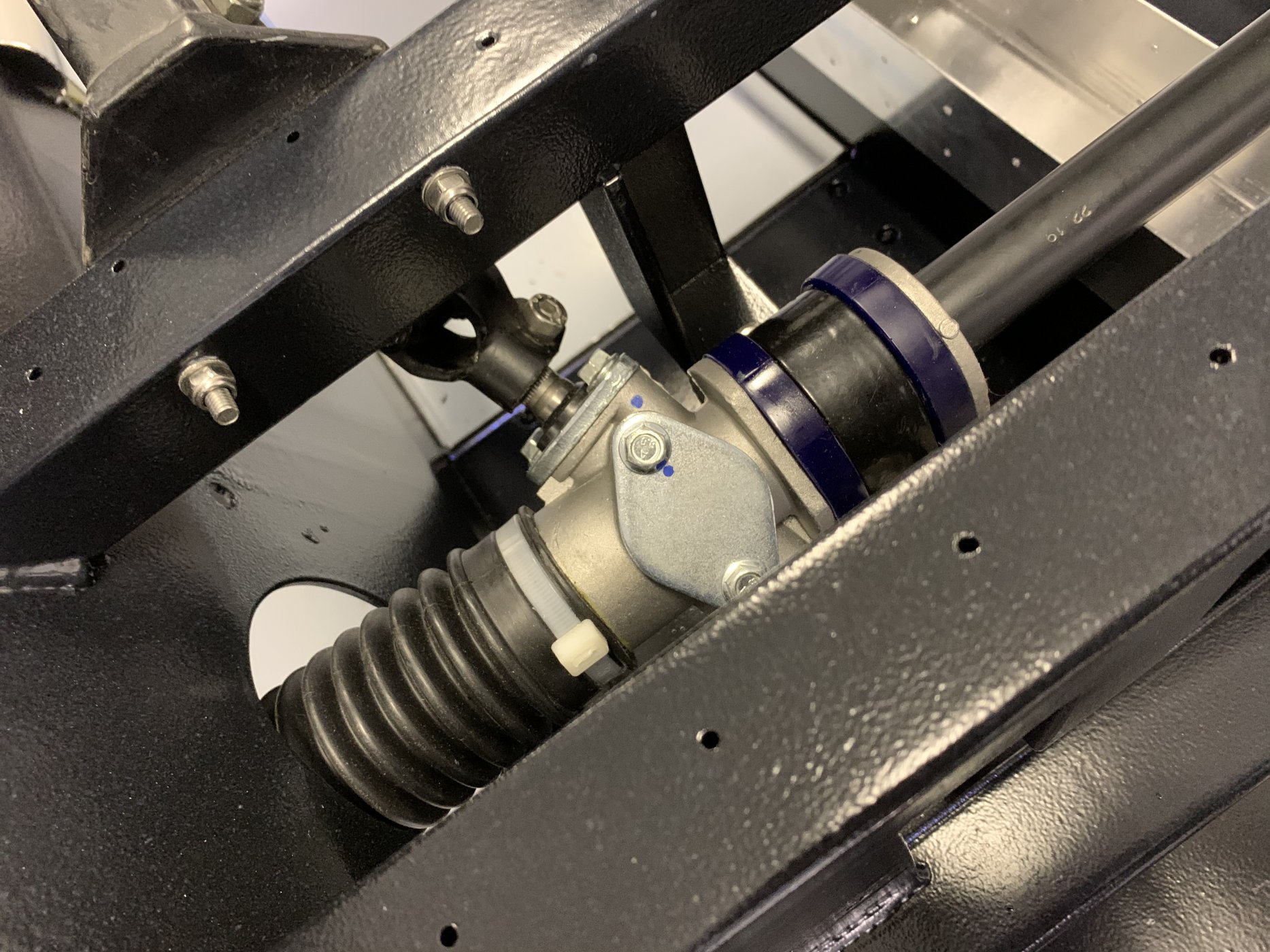

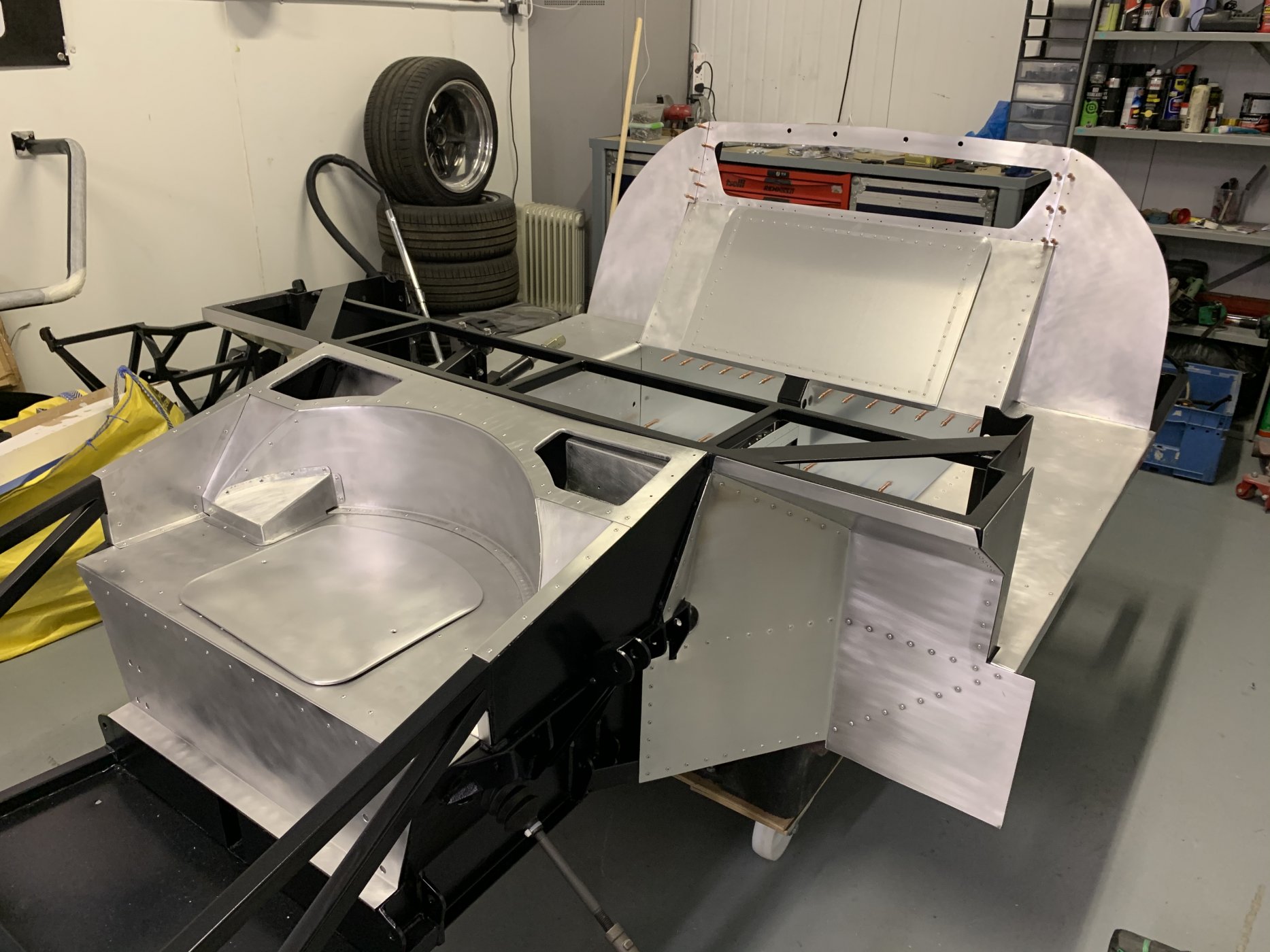

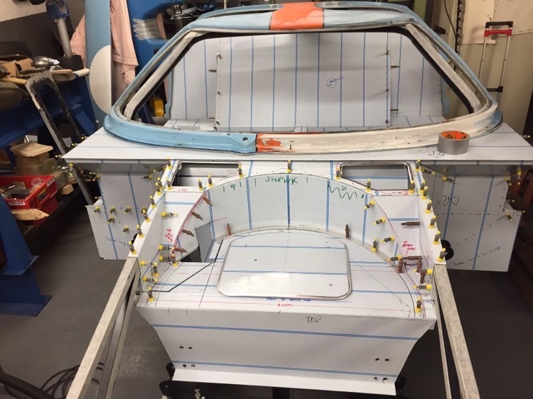

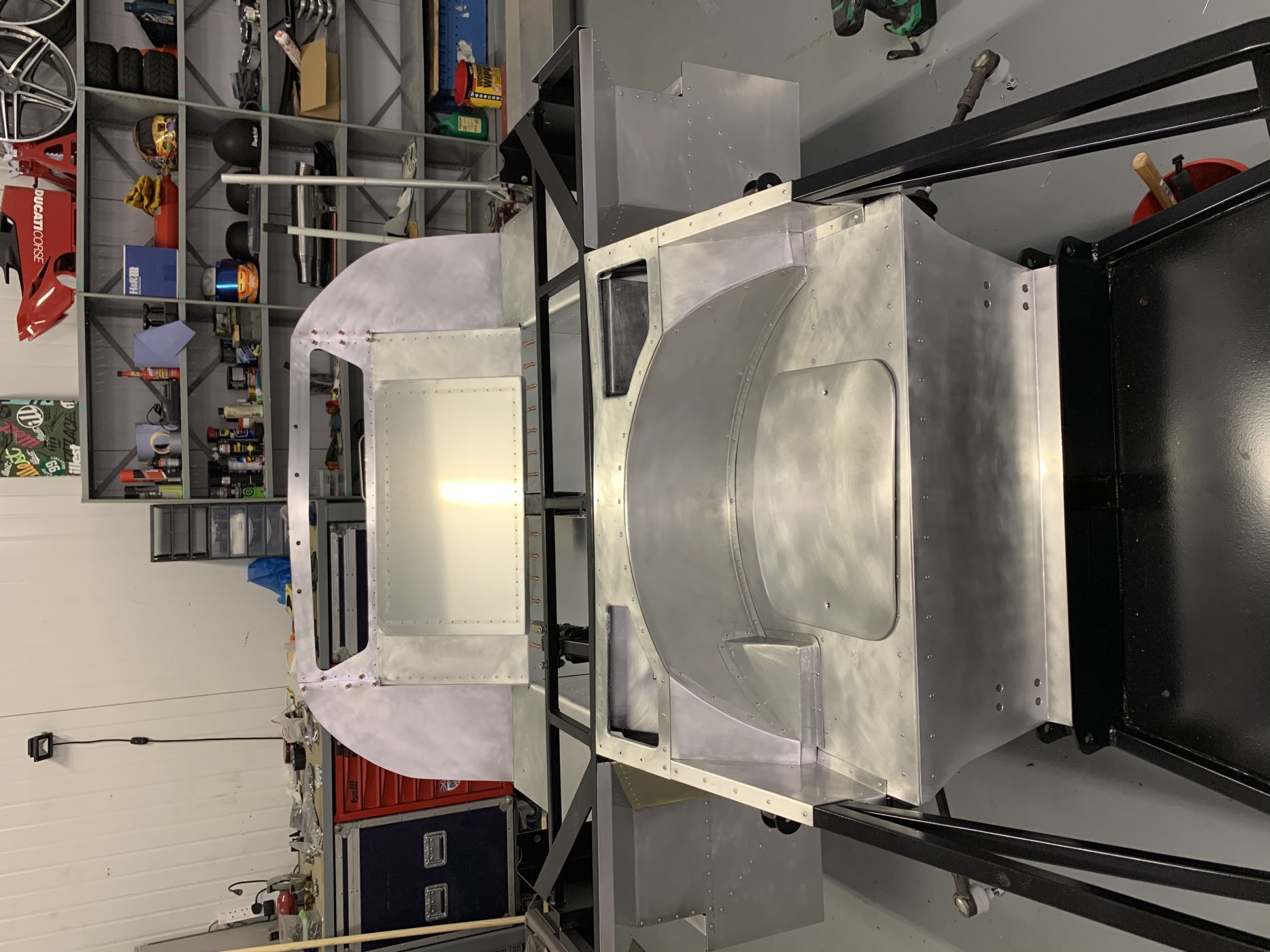

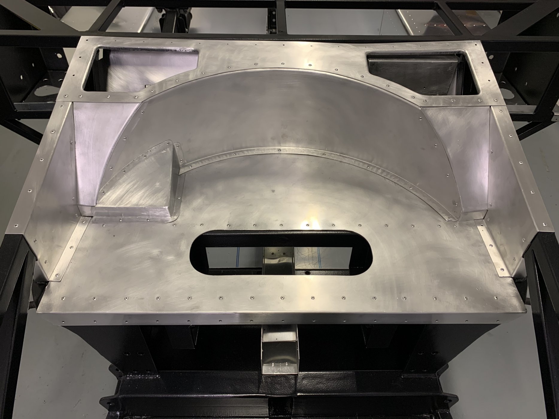

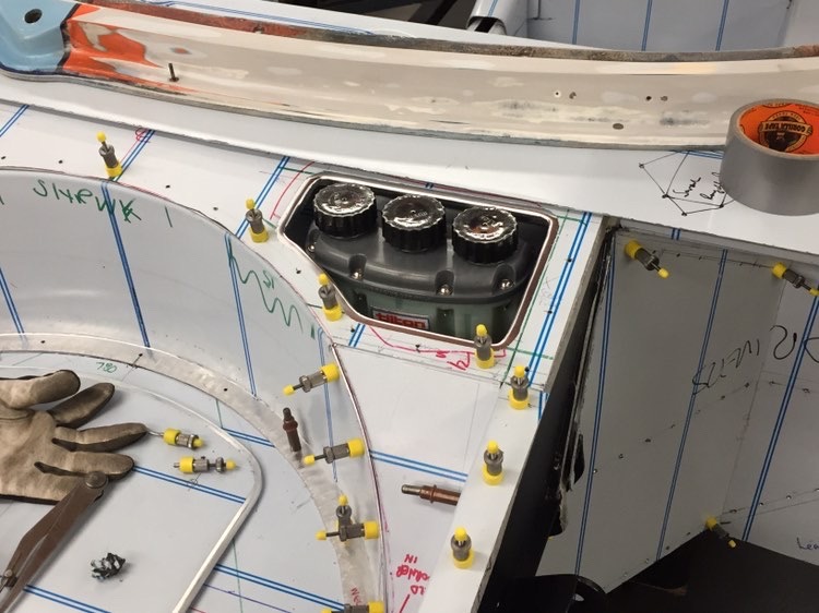

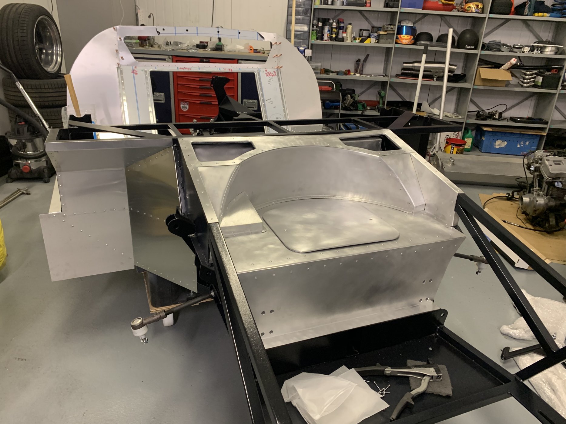

Thought I’d share a few more updates from this week. Finally created a “spare wheel well” that I am happy with. Decided to put some “lightening holes” in the top section and make use of the space to mount my fluid chambers. With steering racks being £120 new I decided to replace this before I rivet everything into place next week. I have created a service hatch to allow access to the steering rack and pedal box.
I believe that’s everything. Really starting to achieve that monocoque I was longing for.
Some pretty neat panel work going on there Jack. Very impressive

Thanks Andy, appreciate your words.

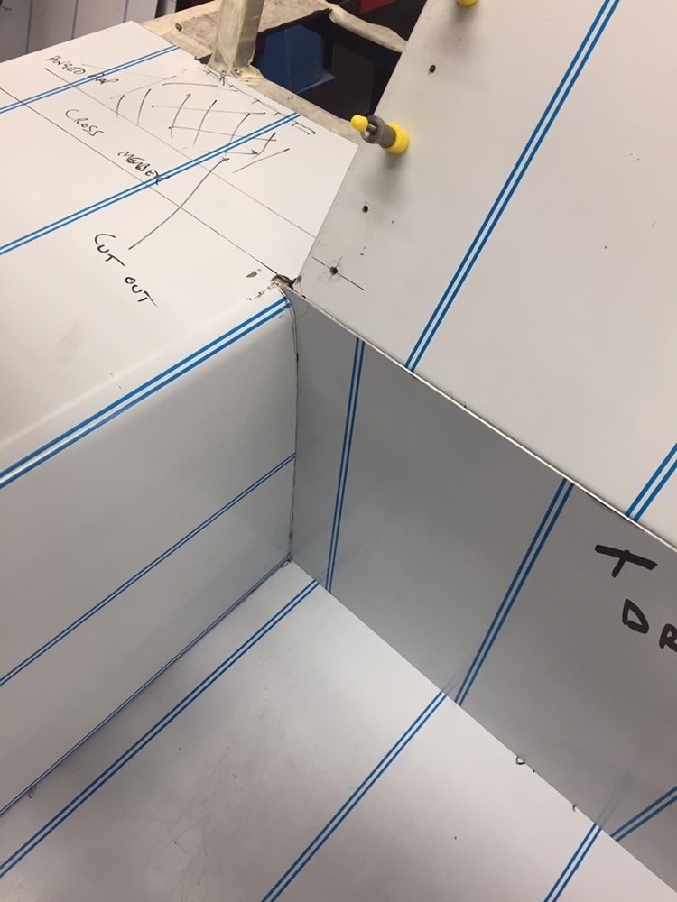

Looking forward to getting that window in position and getting her sat right. Struggling to line the spider up evenly against the ally scuttle/rear mounting pads and roll cage.

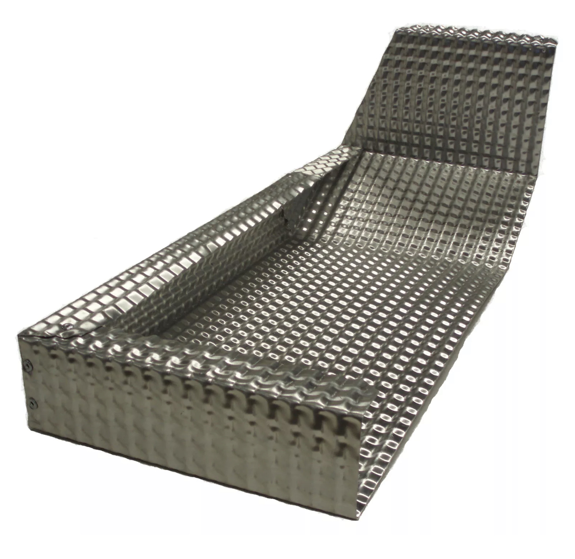

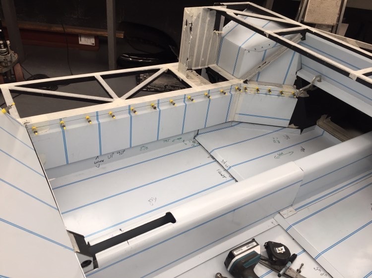

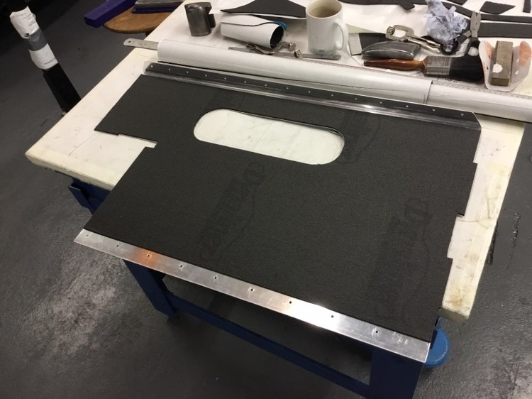

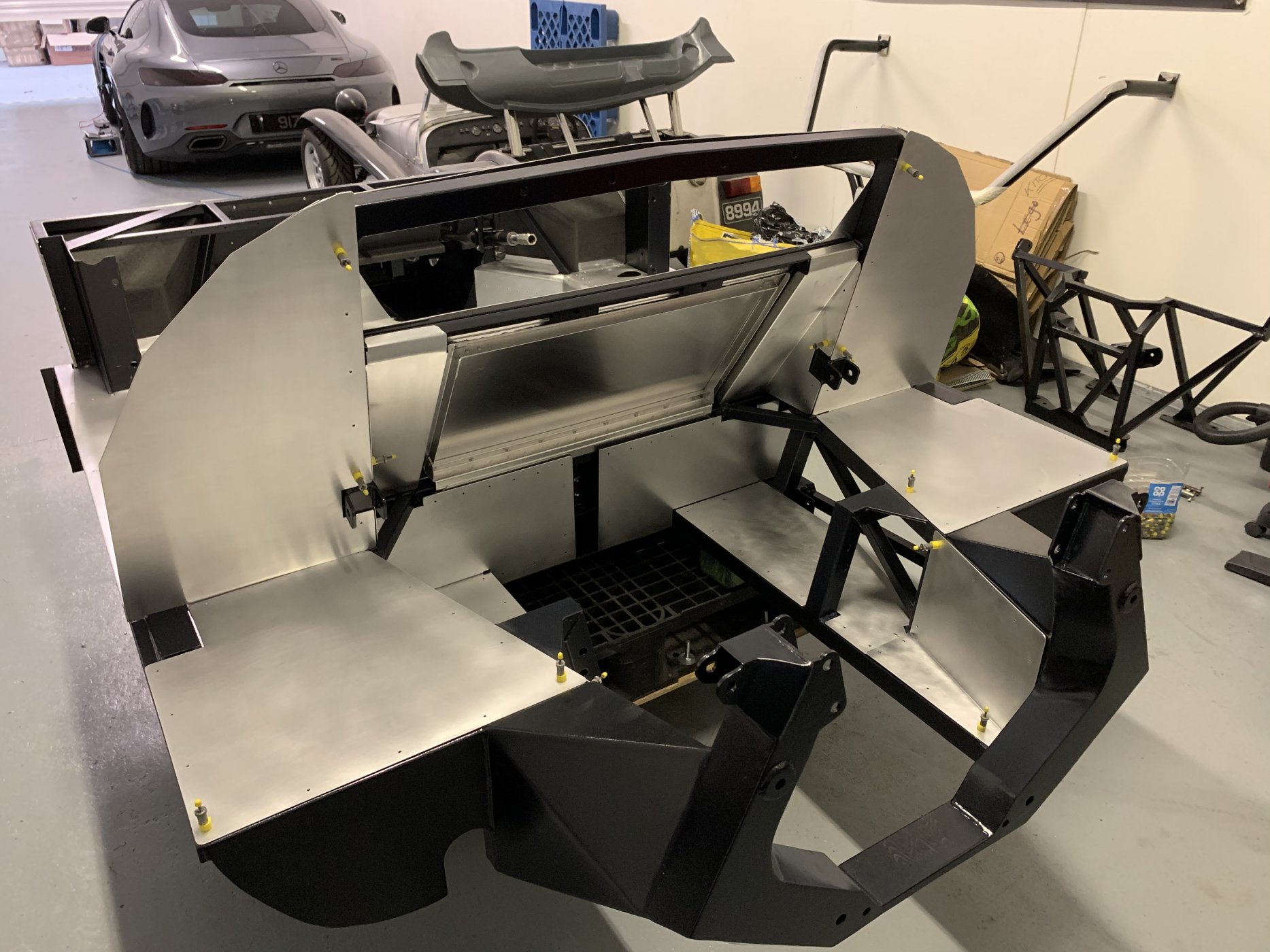

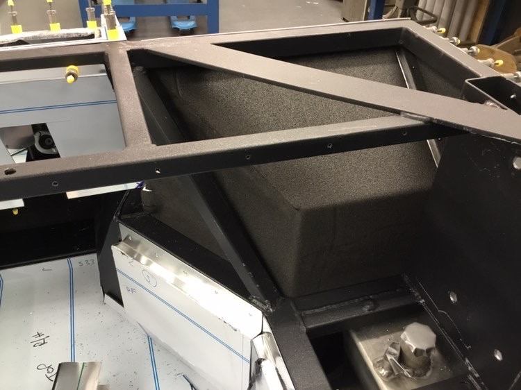

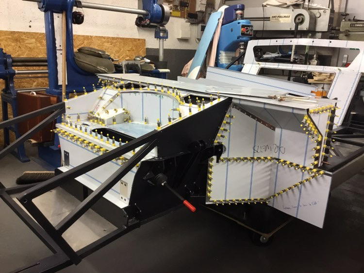

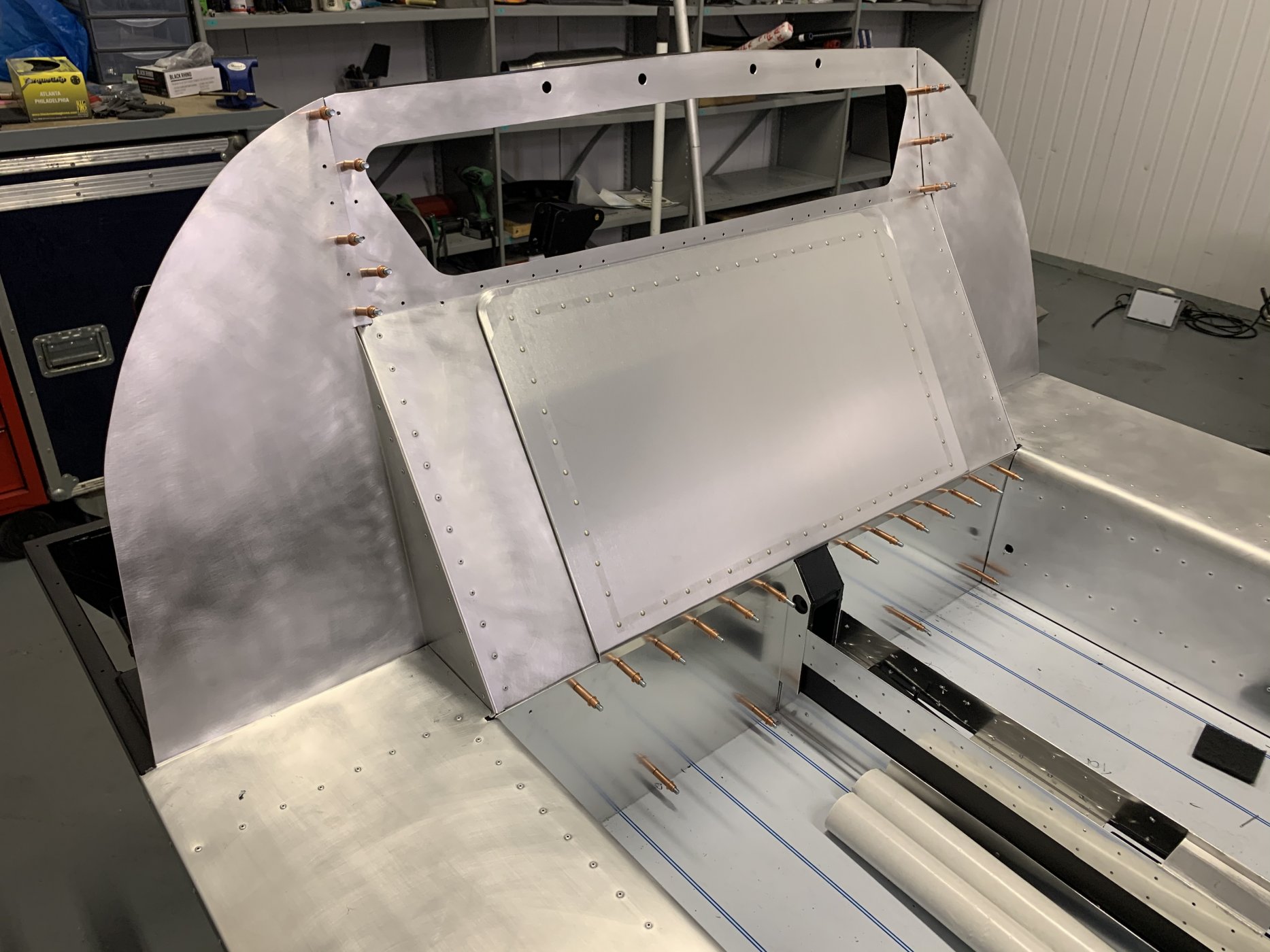

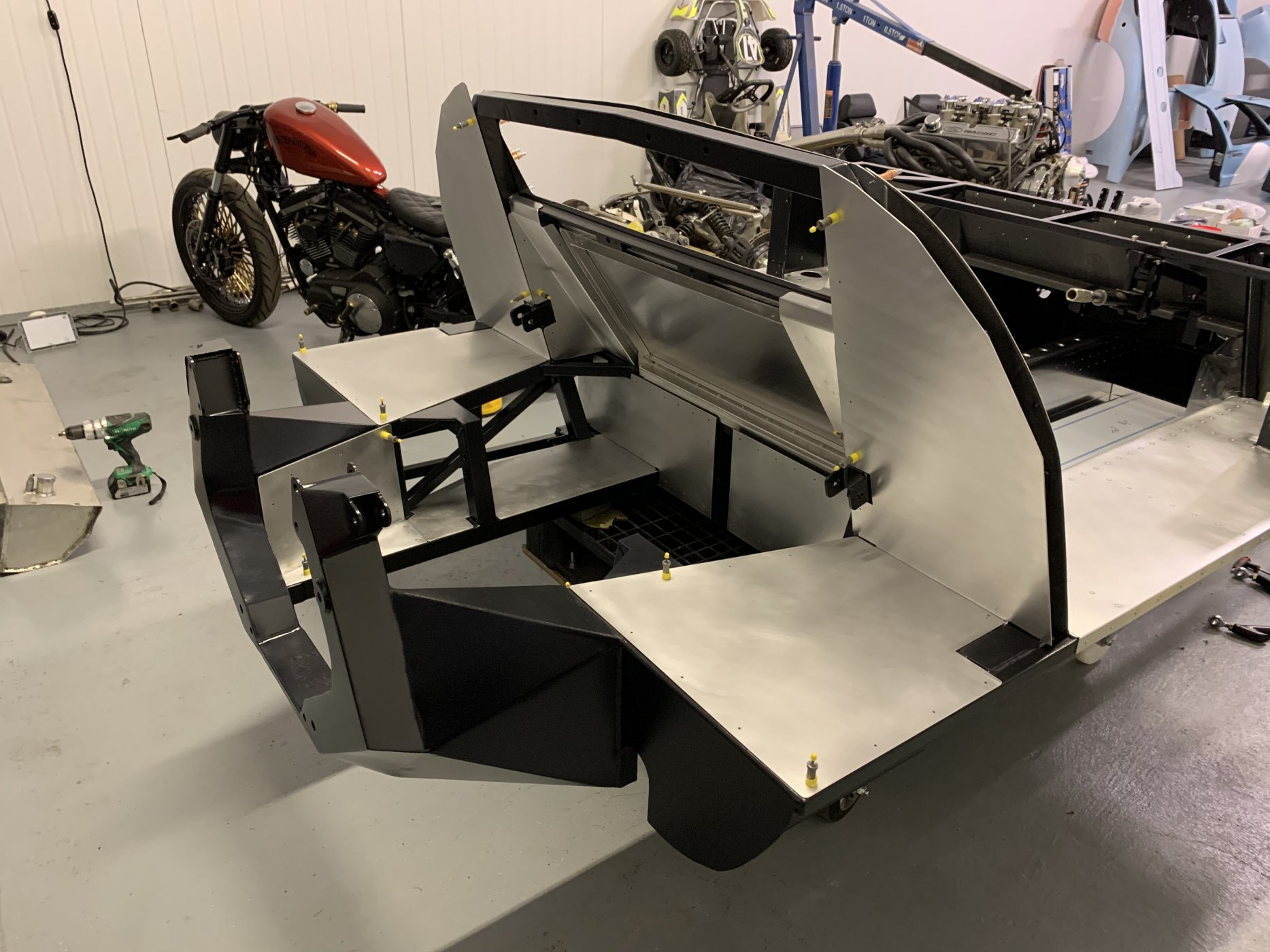

The final build up before a serious riveting session at the end of the week. I have attached dynamat on the back side of all aluminium to take the tinny sound out of it. It also helps with road noise and to reduce heat transfer. On the firewall I have double skinned this with a G1 embossed aluminium product which seems to be highly recommended by the US guys. It really should start to move forward now.

Hi
if you can still get into the center tunnel, put heat protection in there.
the pipes will rediate a lot of heat into the cabin.

Hi Ian
Thanks for the advice. I have run some of the dynamat foam down the tunnel. Its doubled skinned so luckily I managed to double it up. Fingers crossed it stays pretty cool in the cockpit.

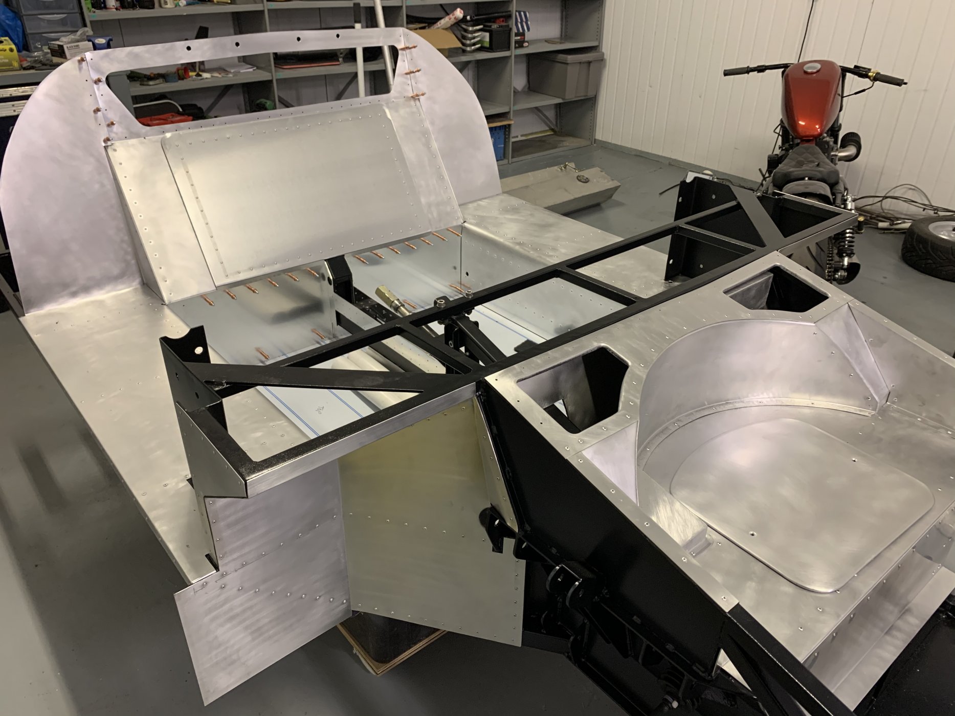

Slowly slowly catch the monkey as my grandpa use to say. Seems irrelevant to be posting pictures of cars as the moment. I’ve been to the workshop once in the past 2 weeks and that was only for about a hour or so. Managed to sink a few rivets in that time and distract the mind.
