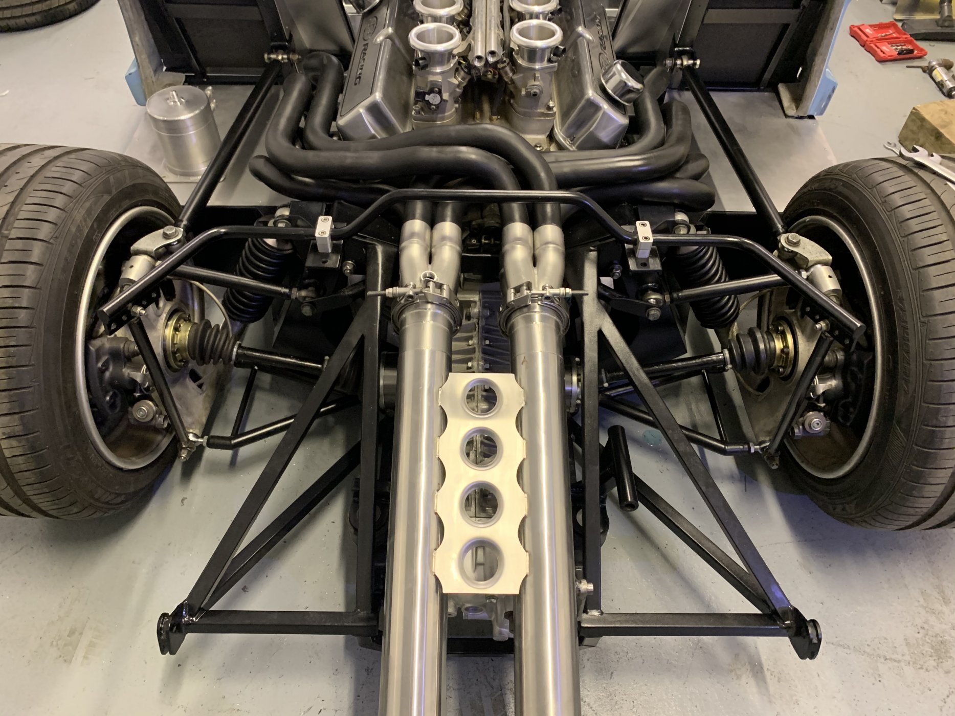

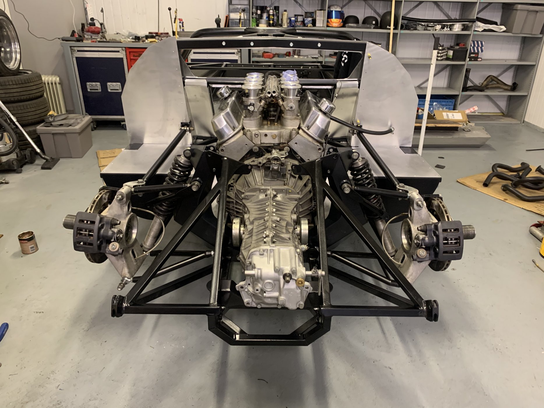

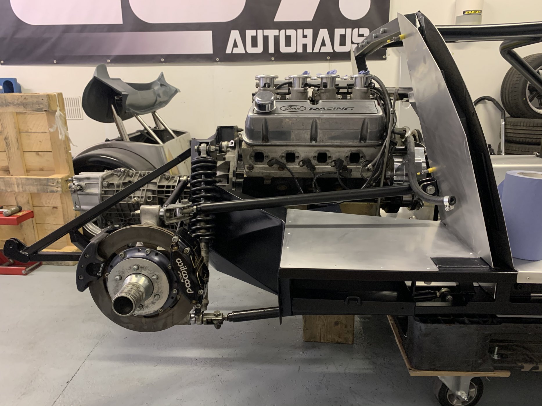

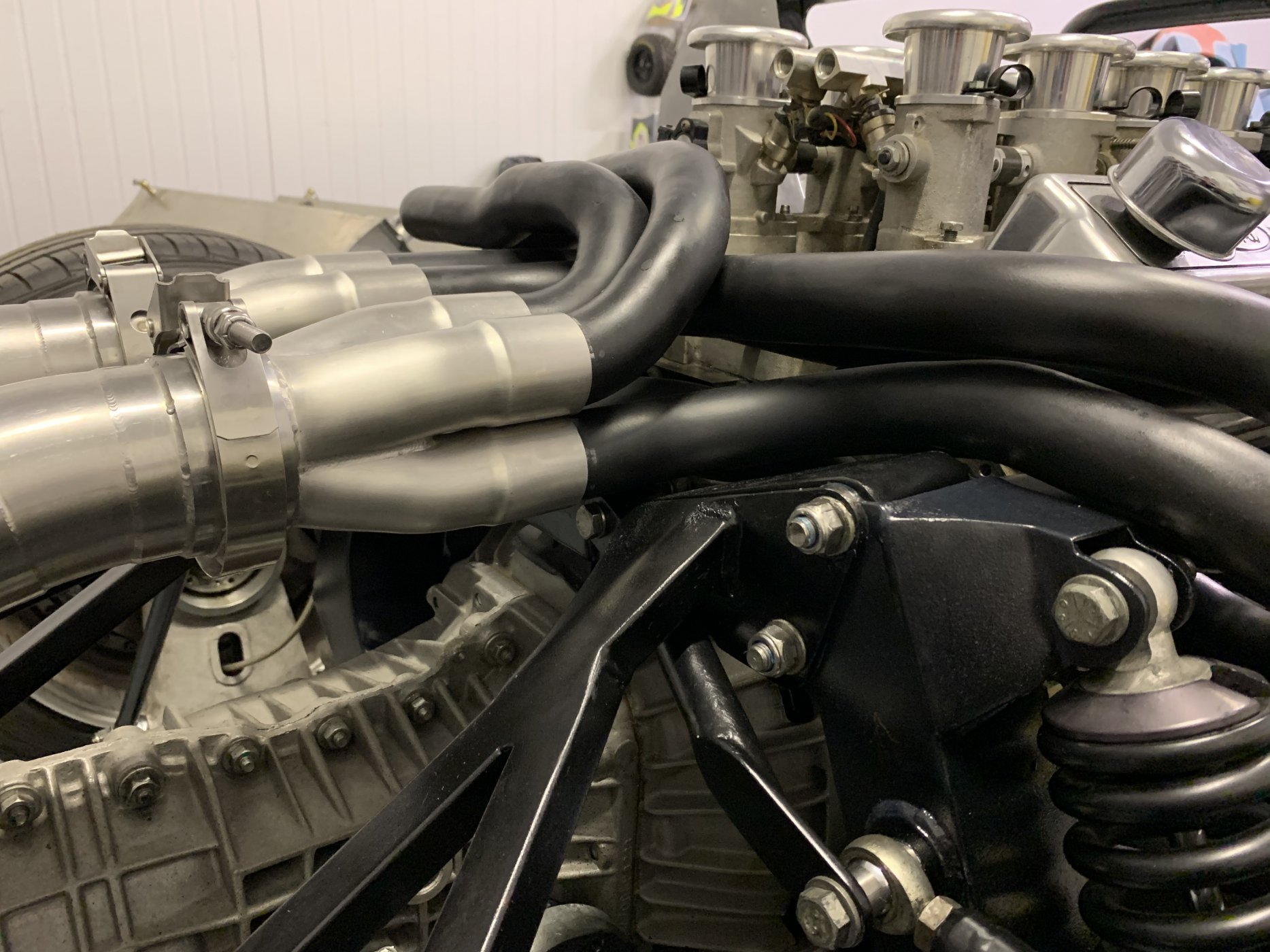

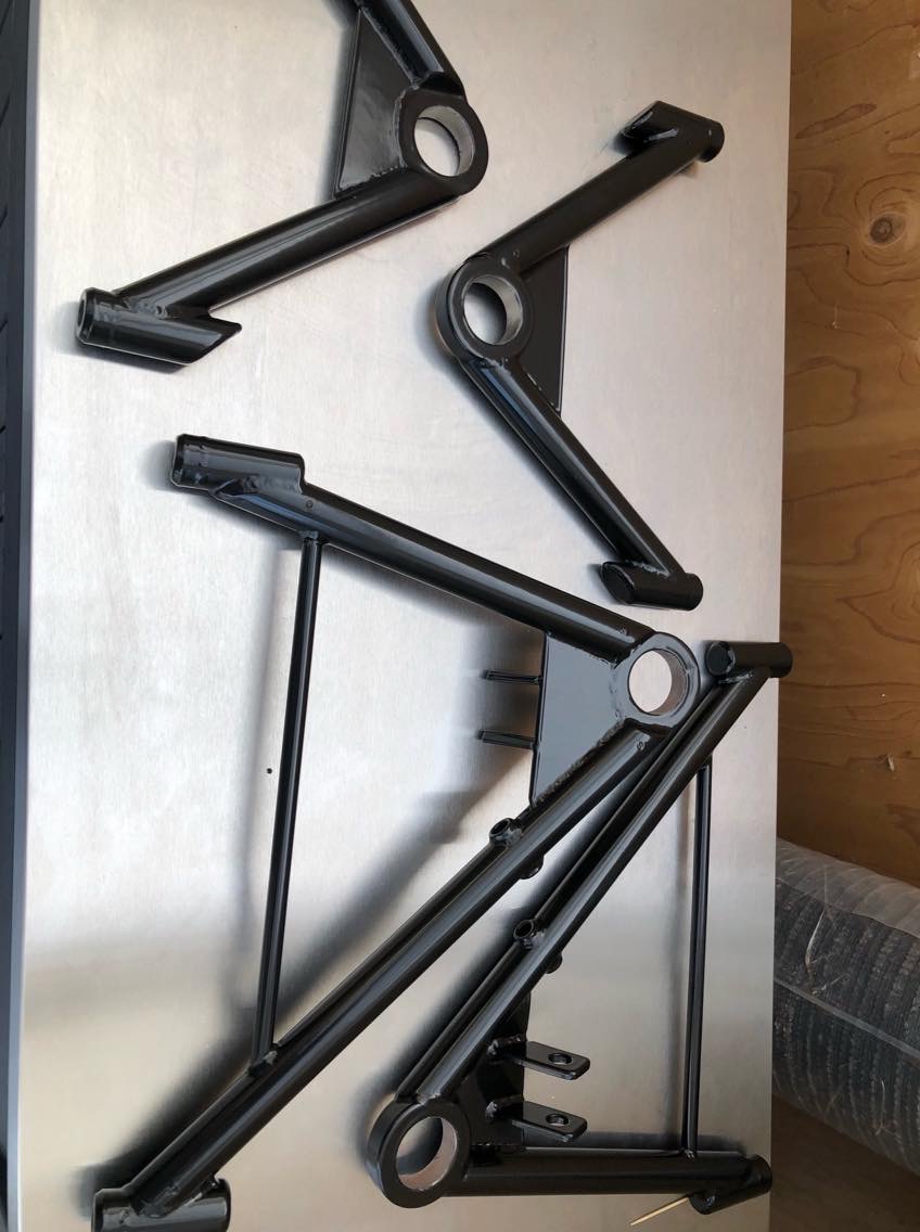

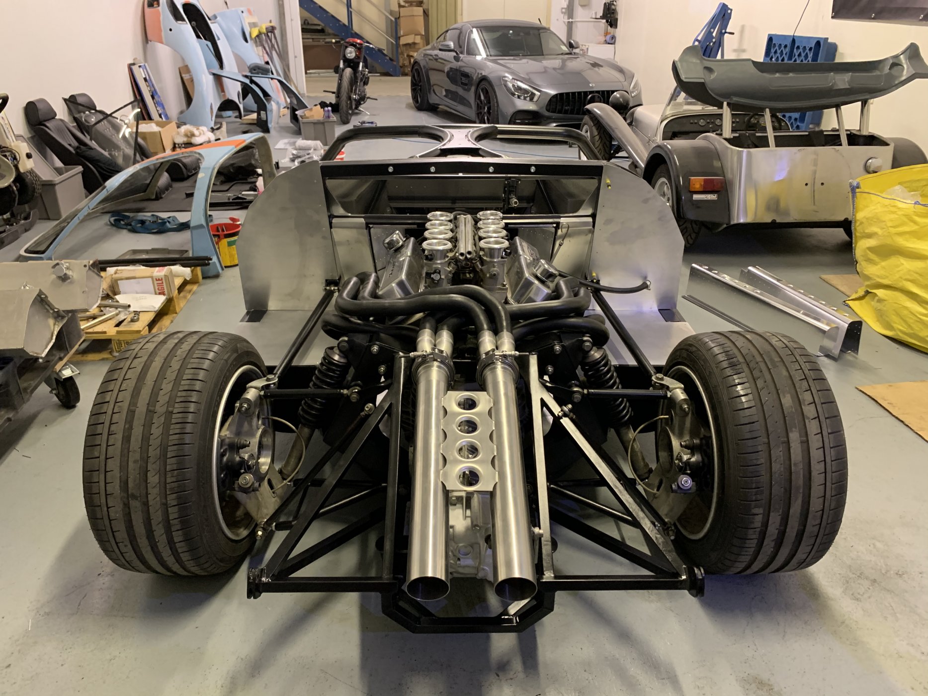

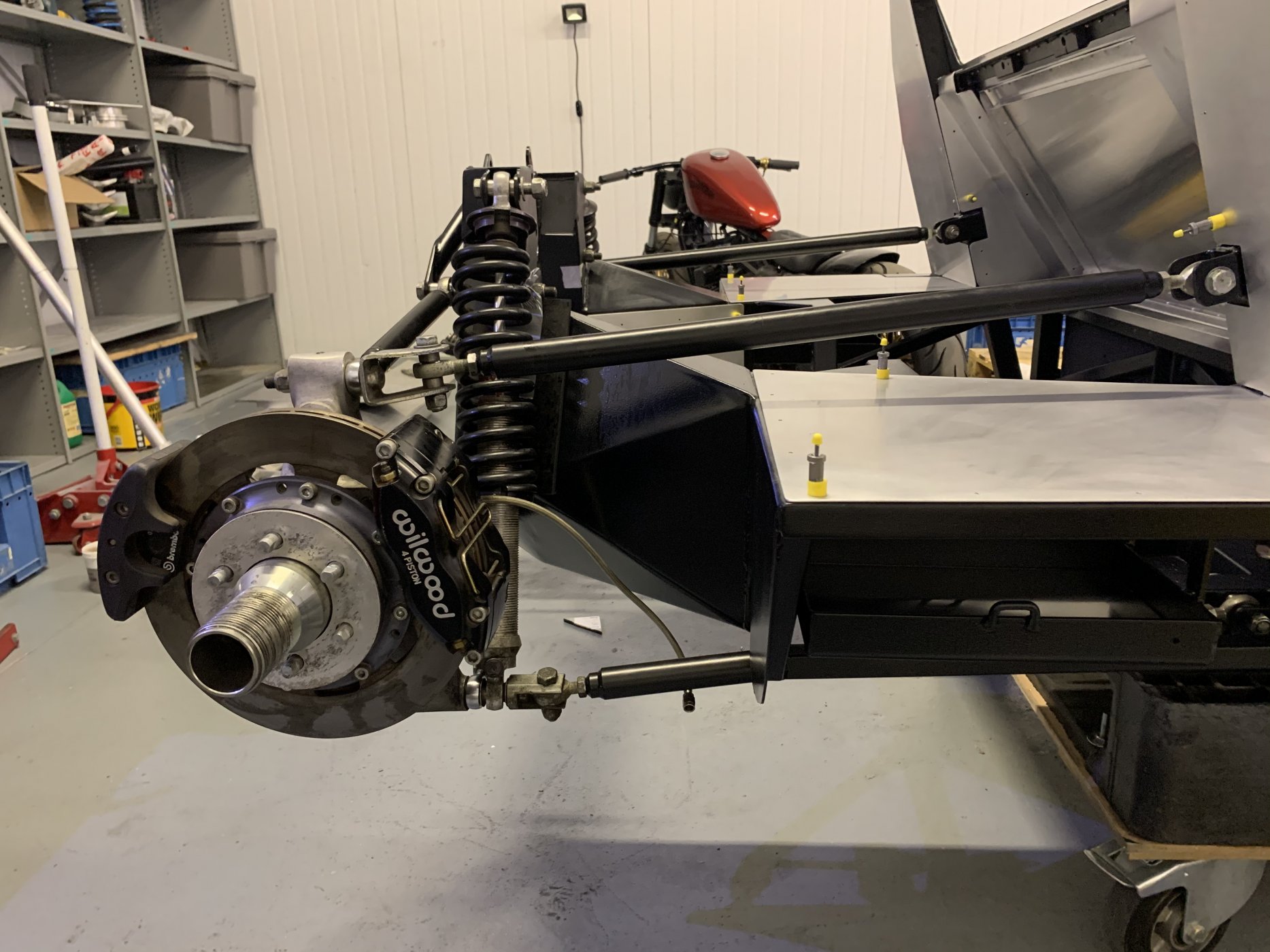

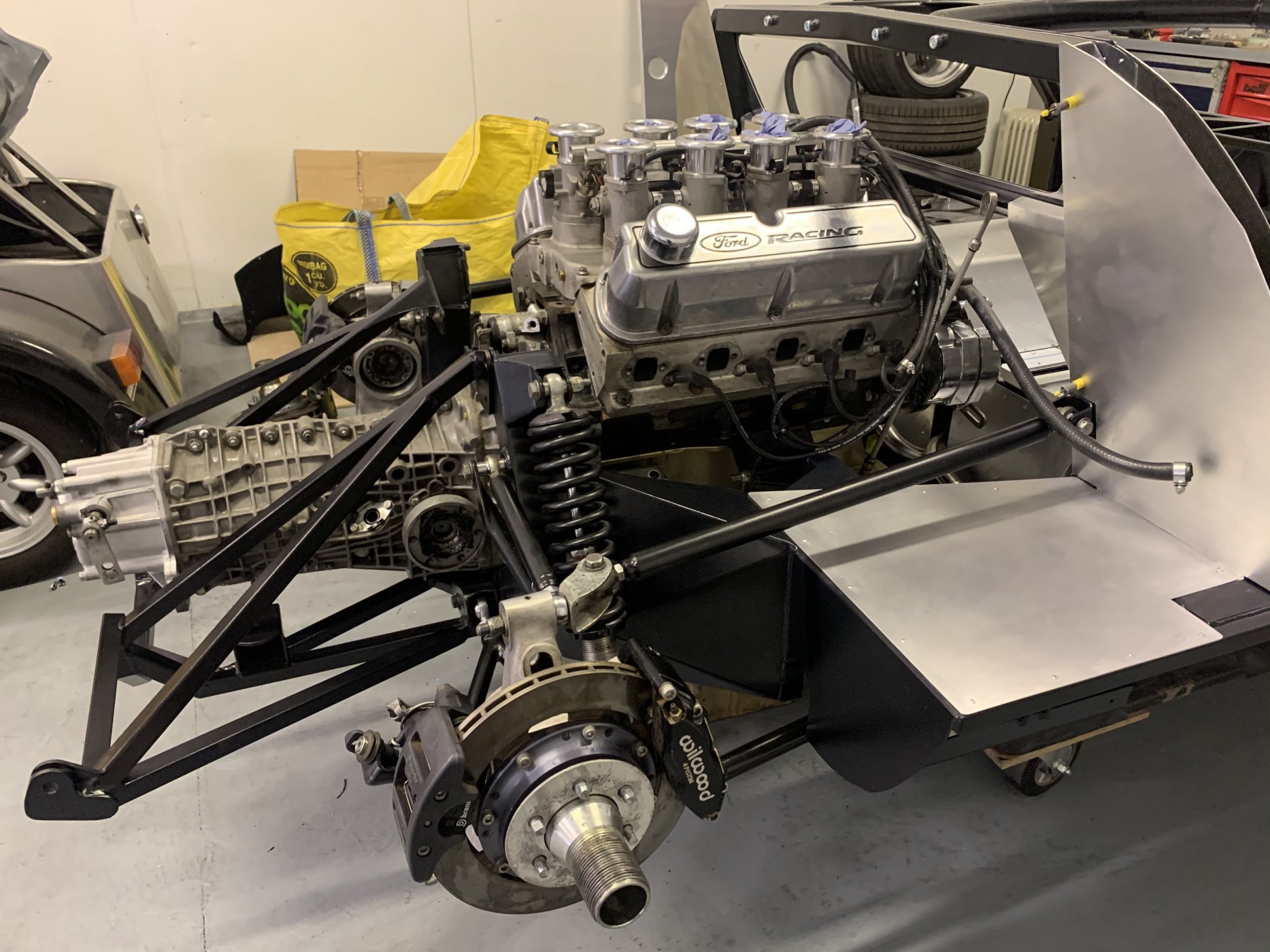

Powder coated black rear suspension arms and rods fitted. Rear uprights, disks and calipers. Rear subframe fitted and engine mounts.

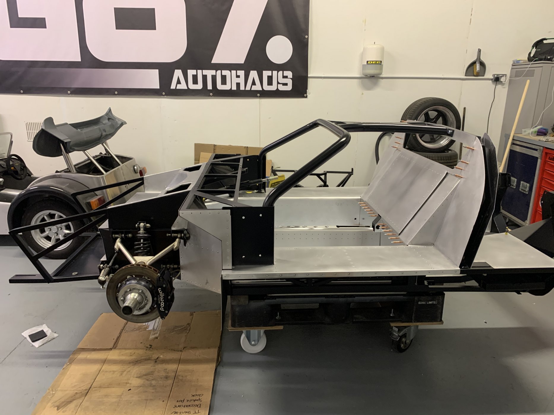

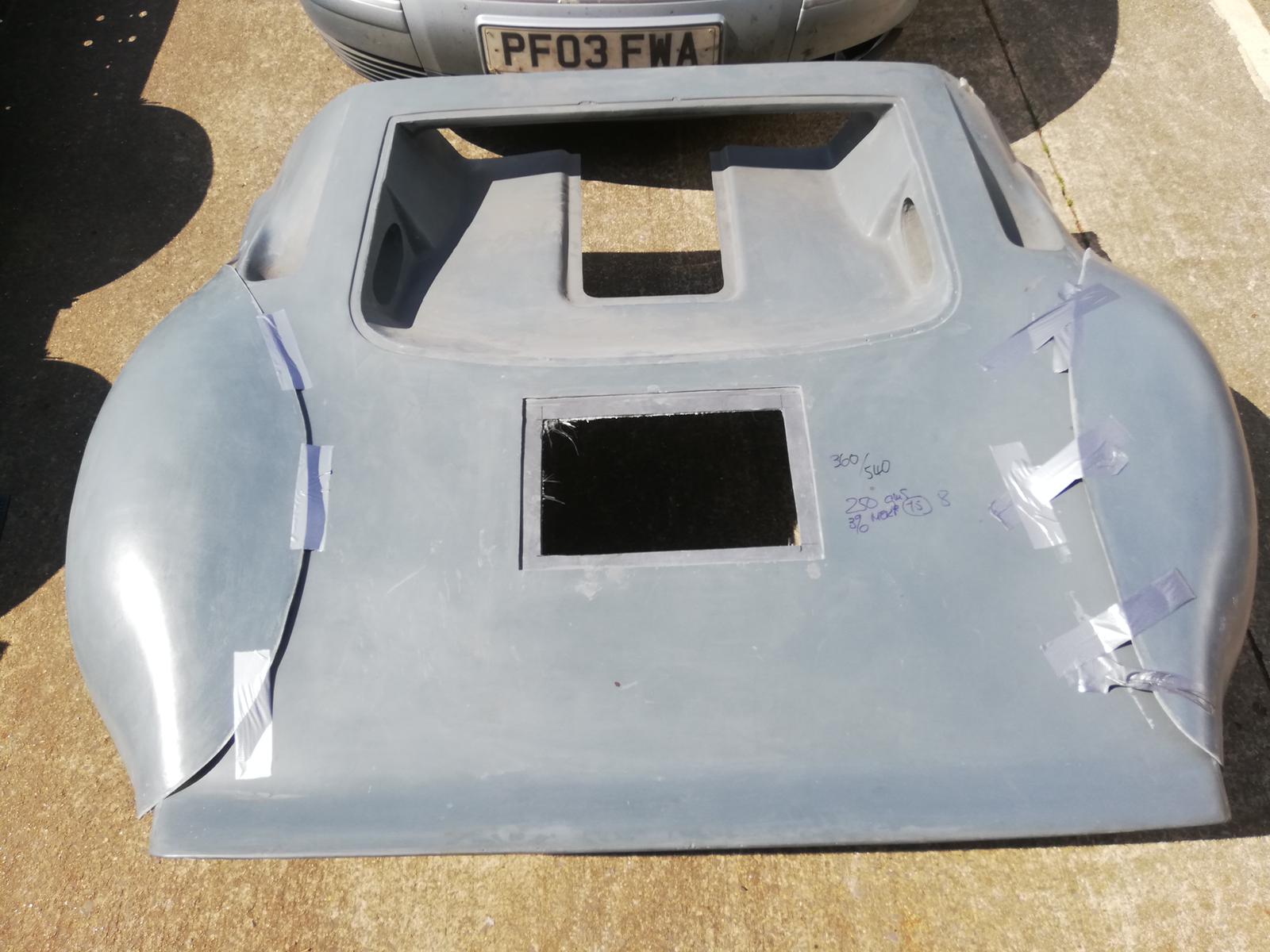

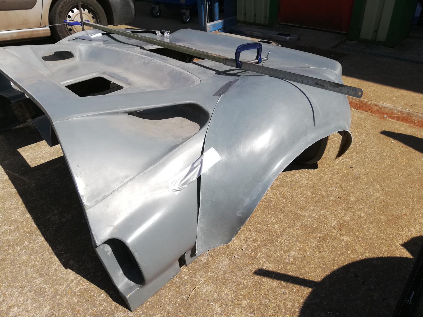

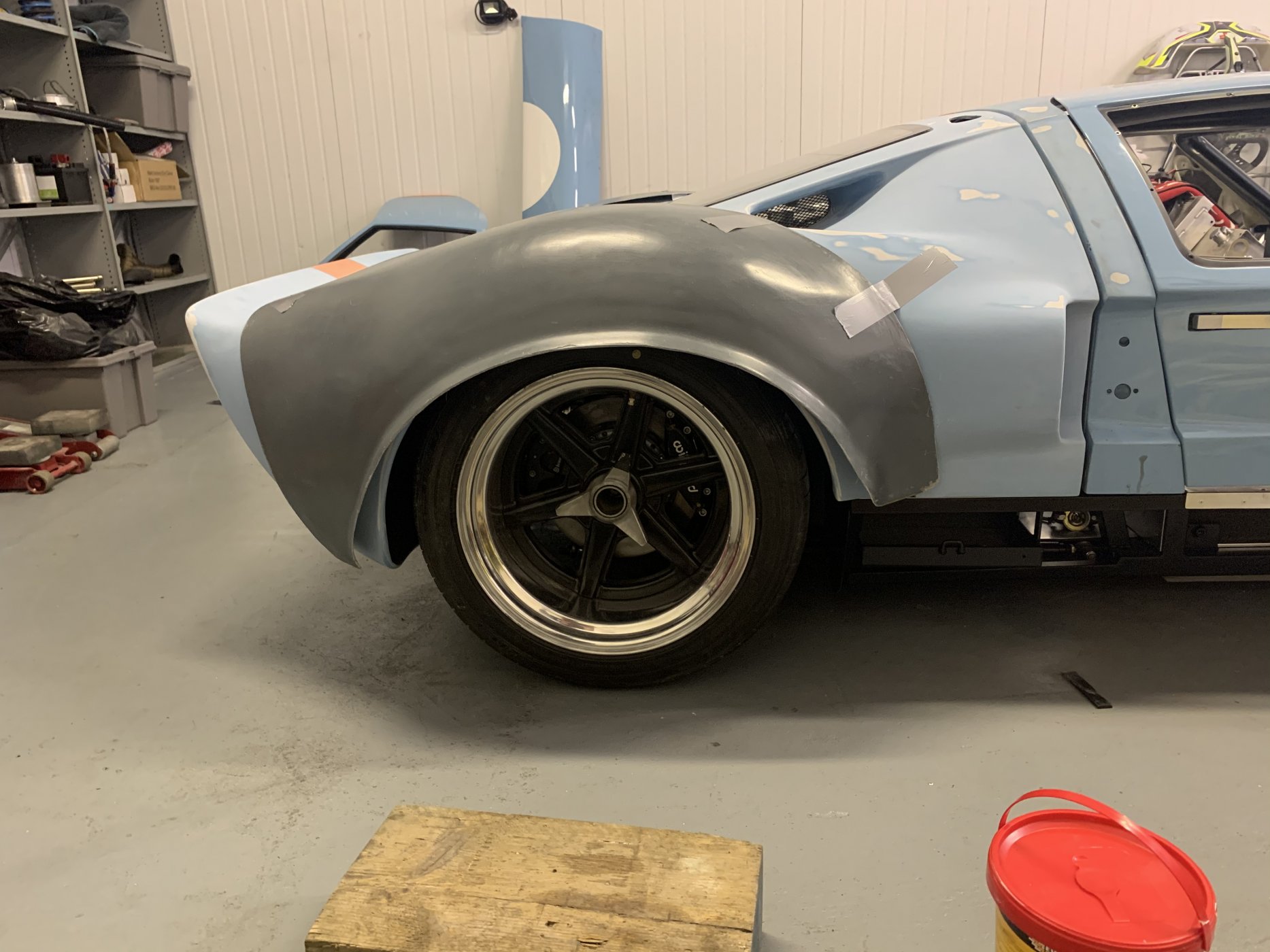

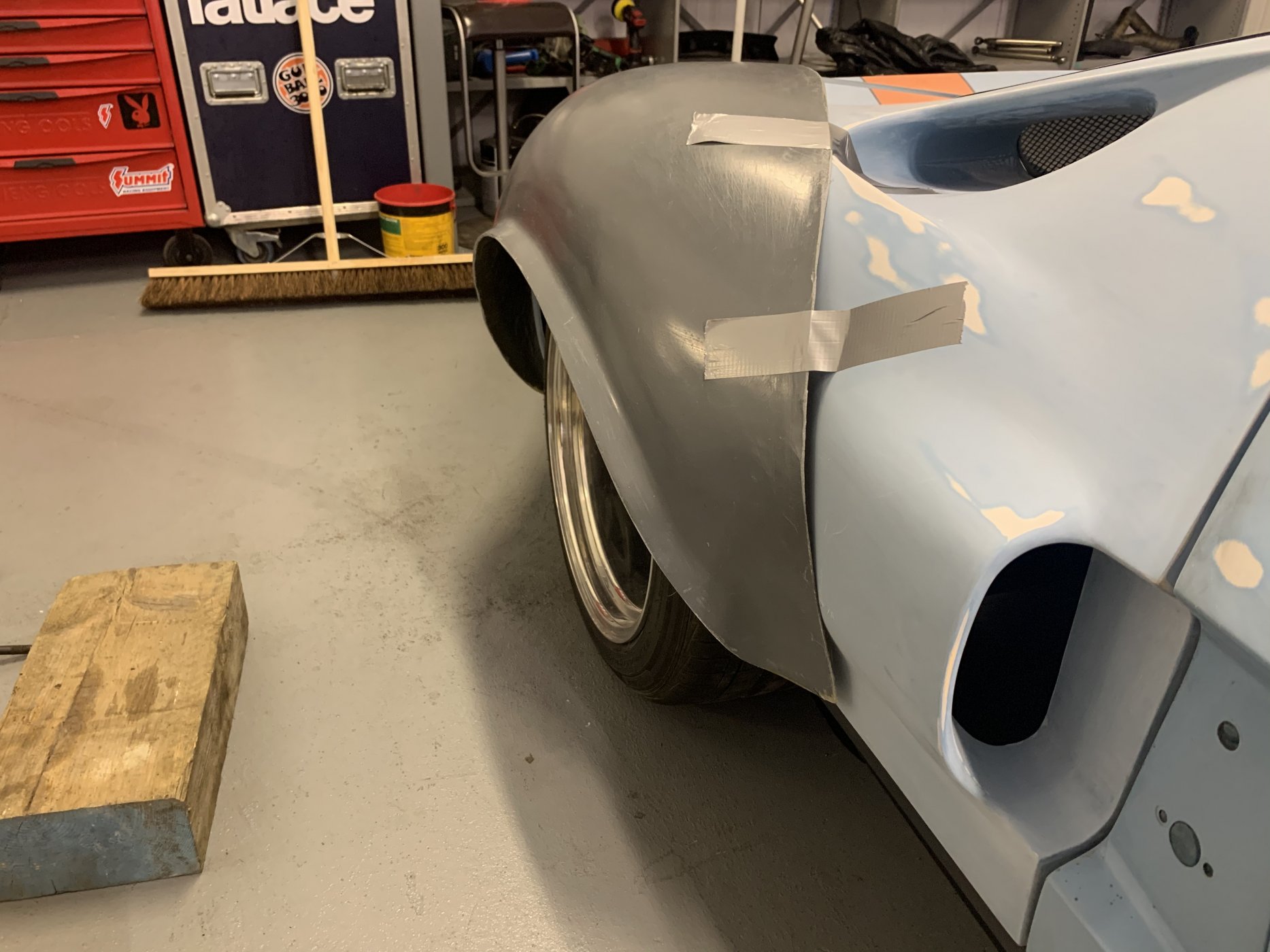

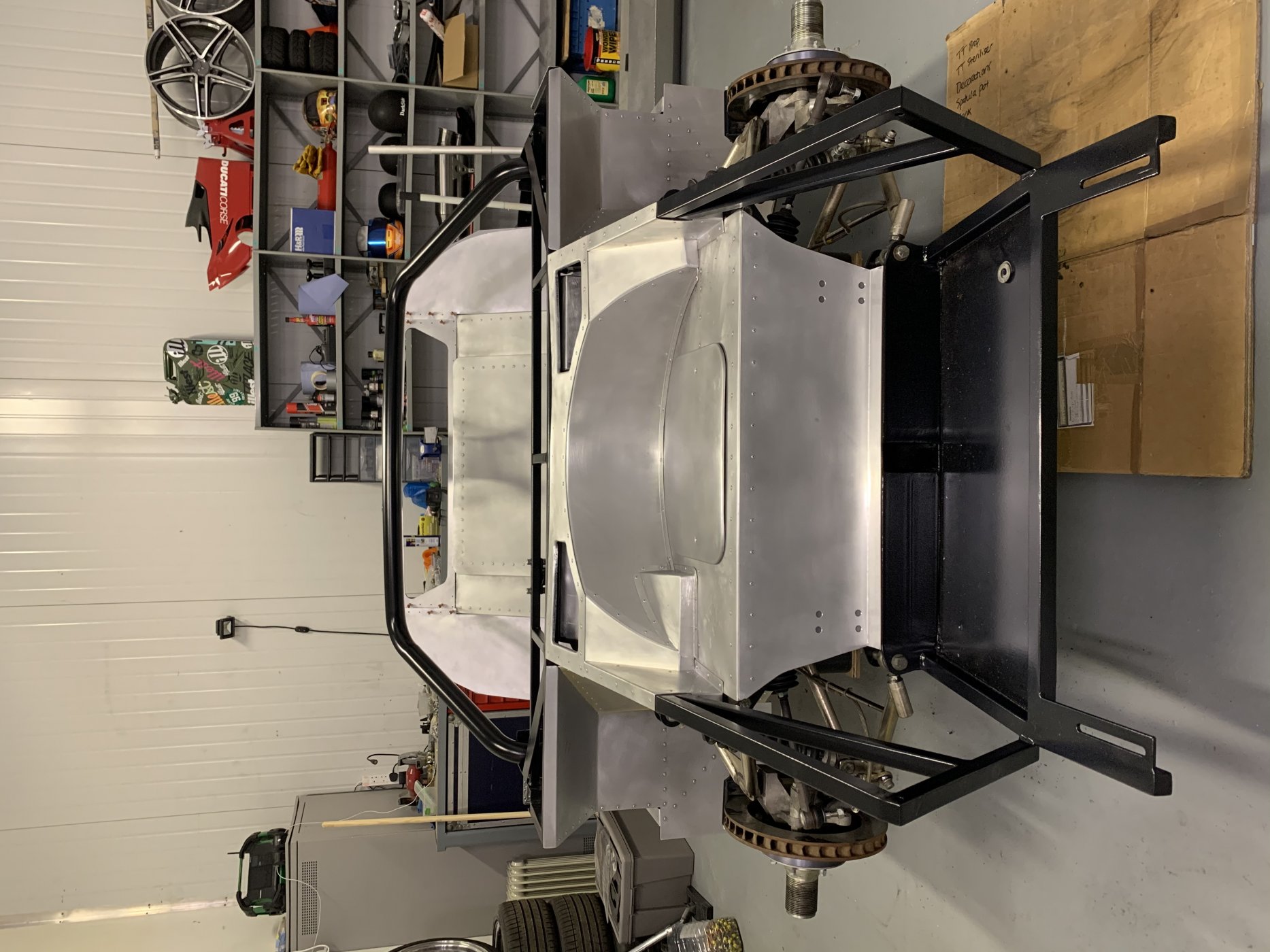

Rear arches are complete and I’m ready to take the grinder to the rear clam.
Hope everyone is fit and well.
Just wondering if anyone knows where I can get some of the rear clam pins like on the original cars. Basically just a rod that protrudes the body.

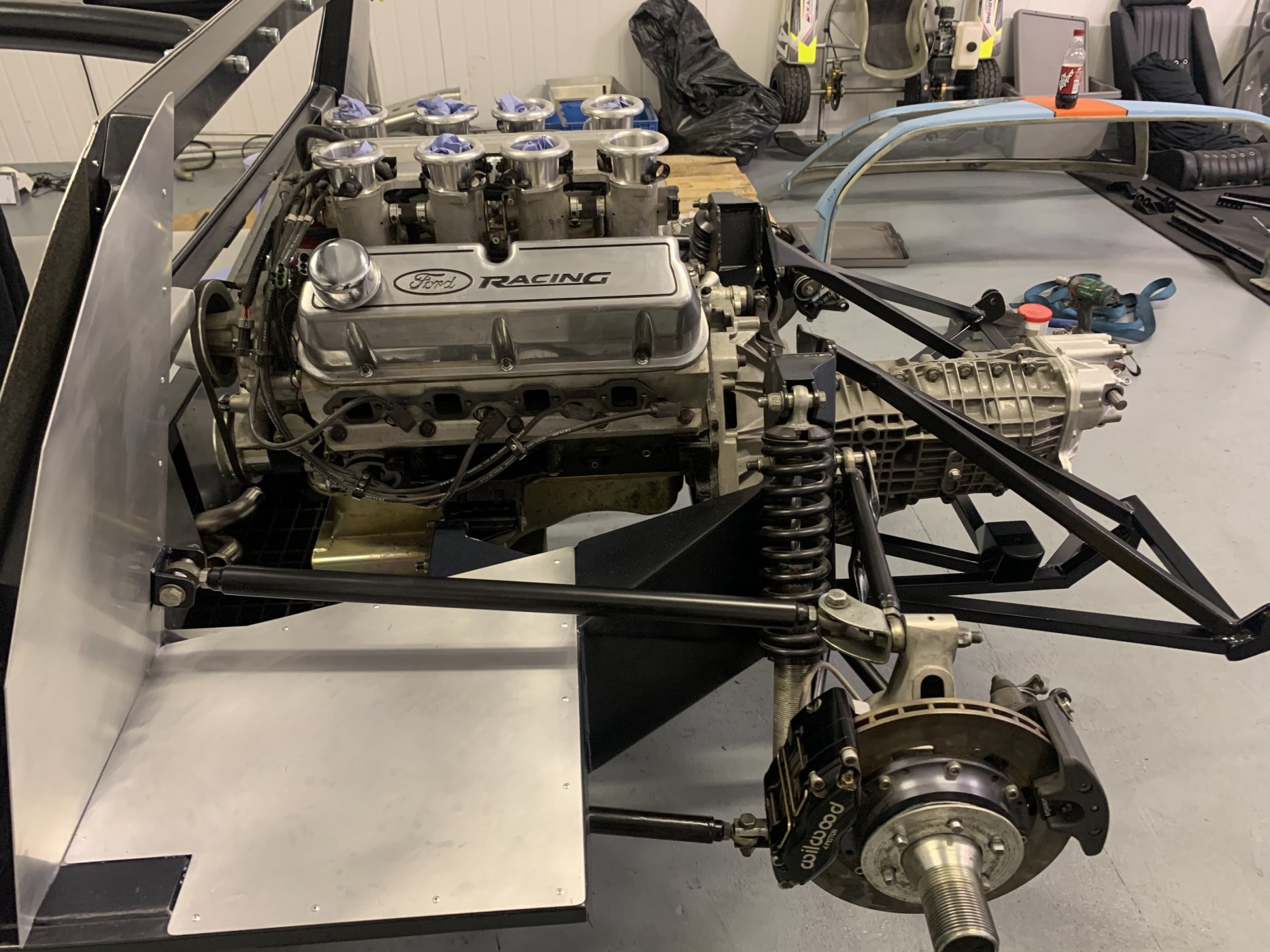

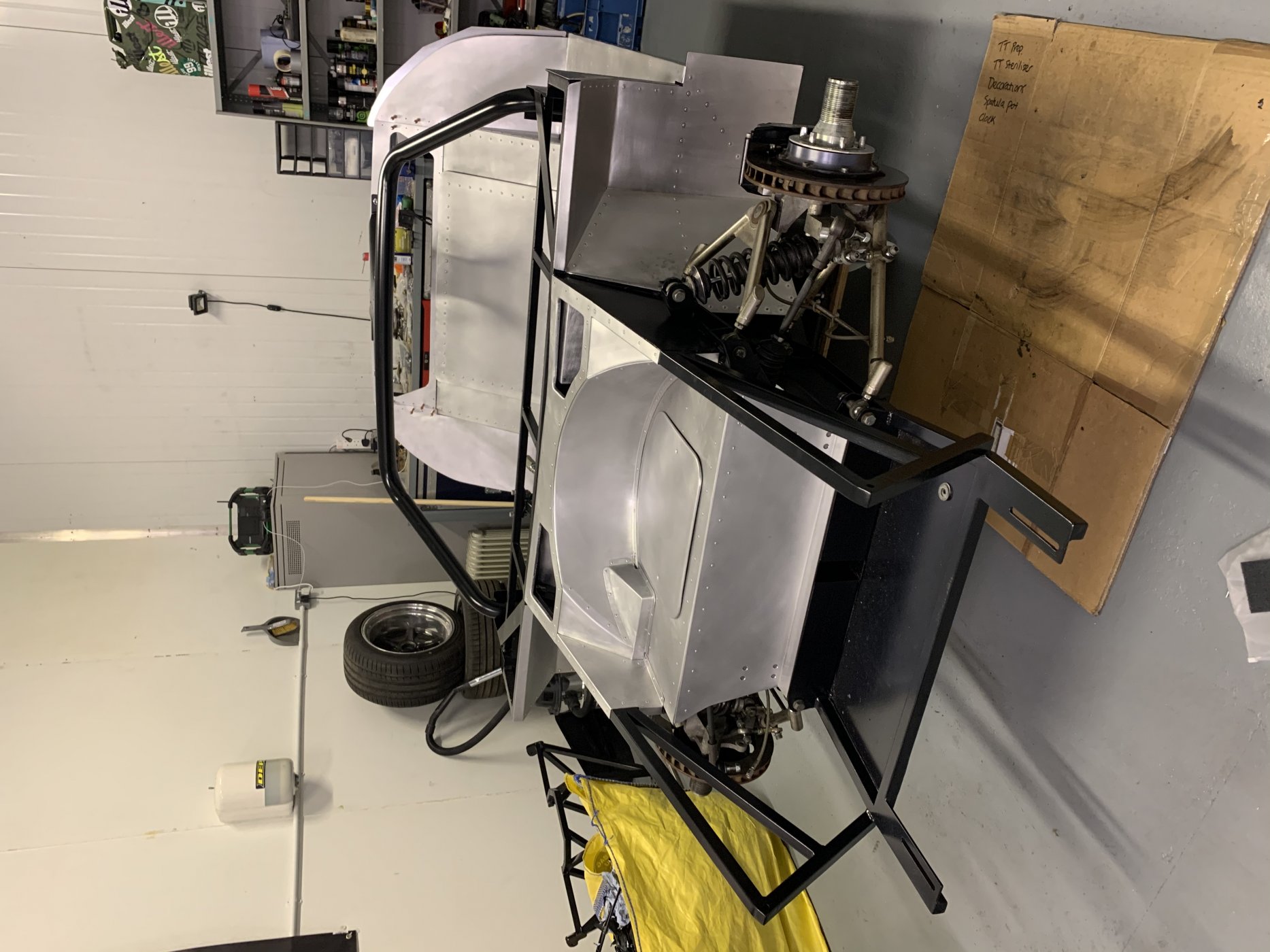

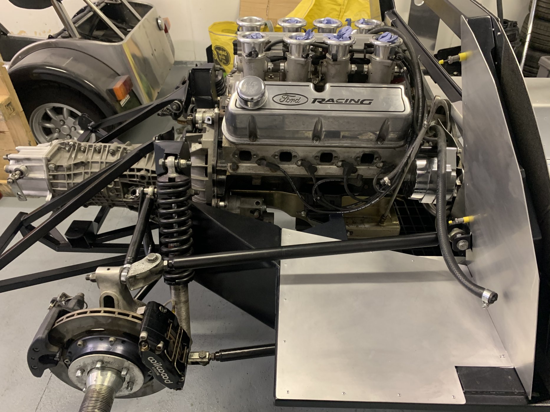

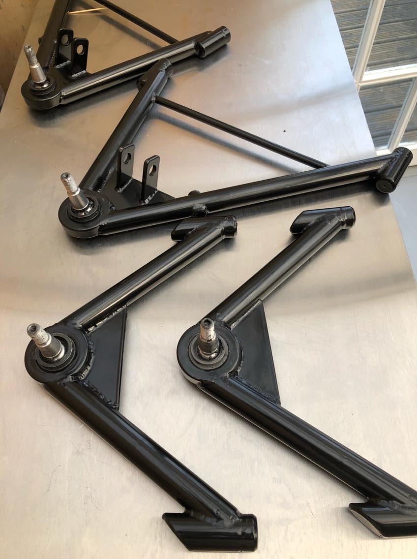

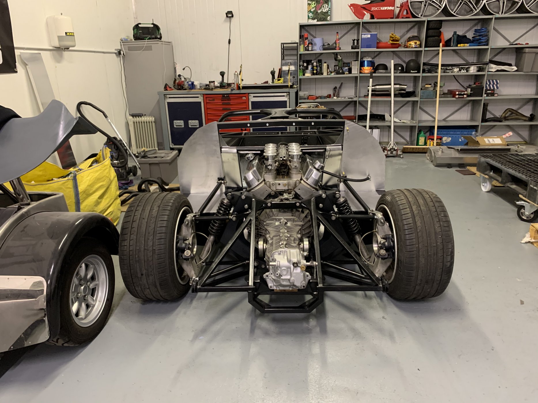

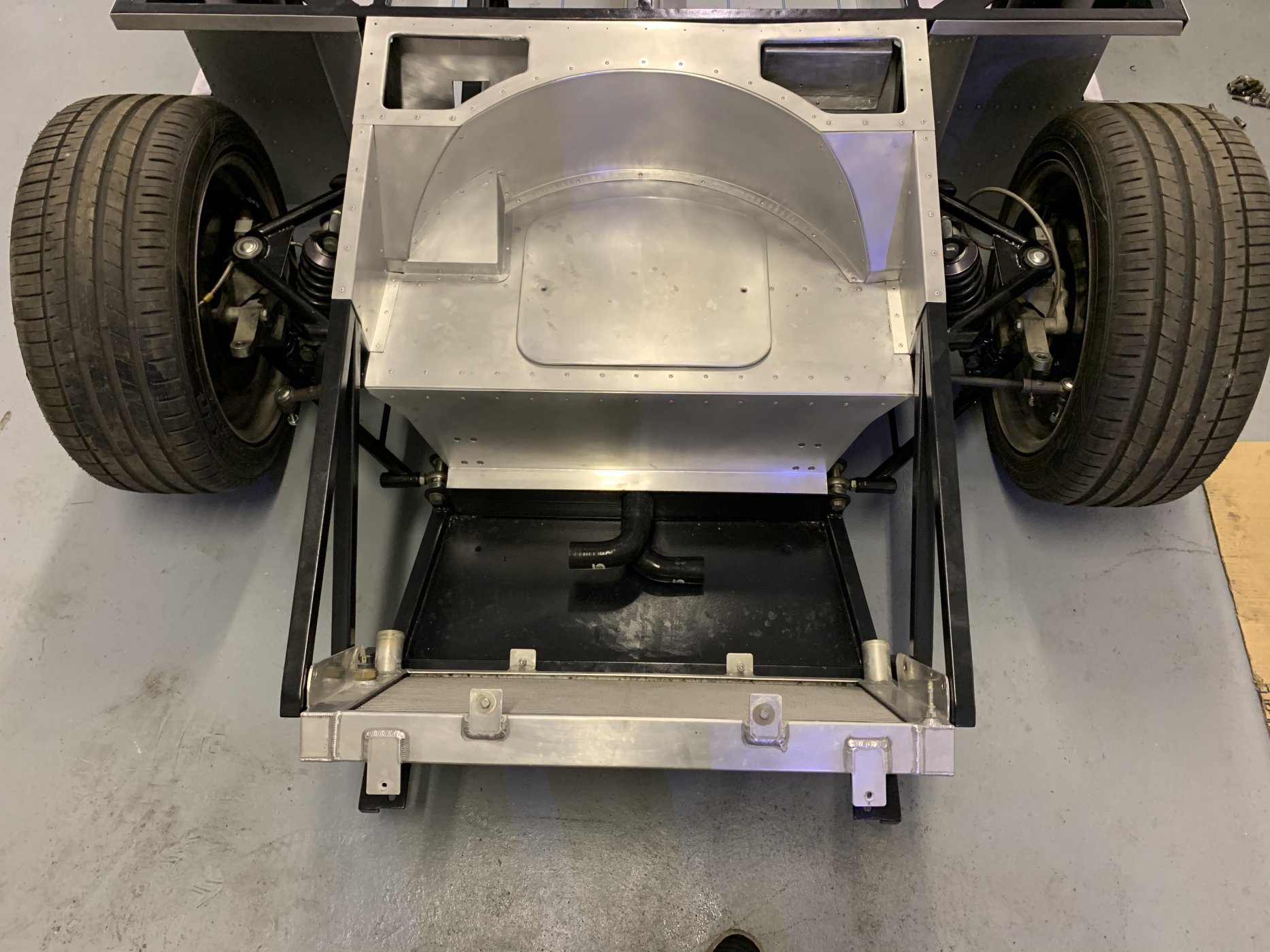

Made some decent progress today. Engine and gearbox back in along with rear subframe. Front suspension arms back from powder coater and ball joints back in. Hopefully is all goes to plan I can get the front corners built up tomorrow and get it back on it’s wheels.
Progress seems to come in waves. For weeks I felt I was getting no where. Now it’s flying together. Really happy with how it’s looking.

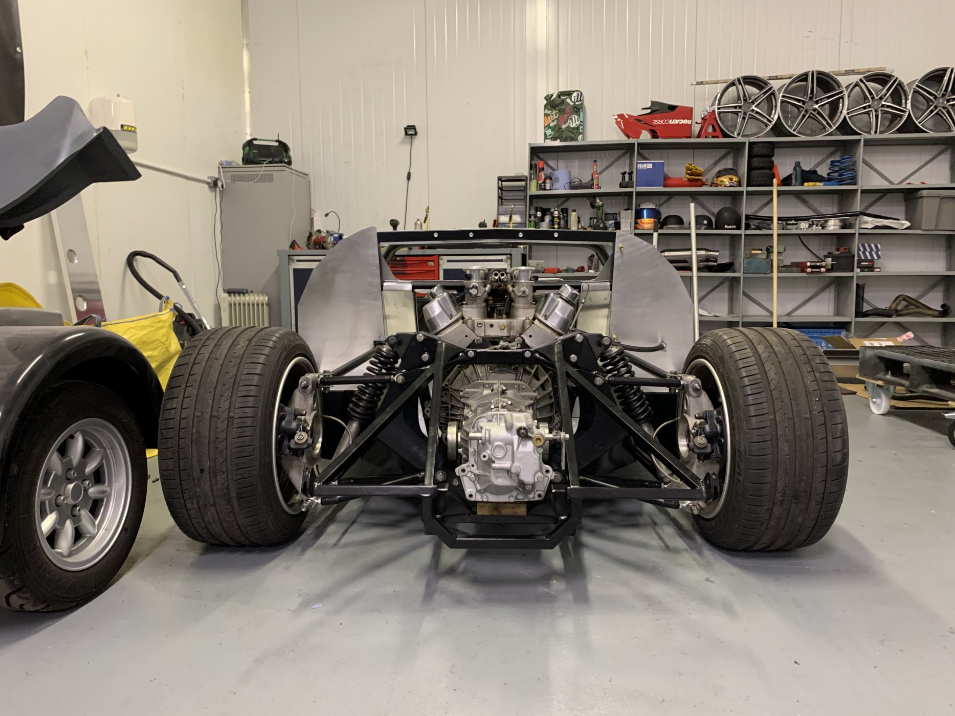

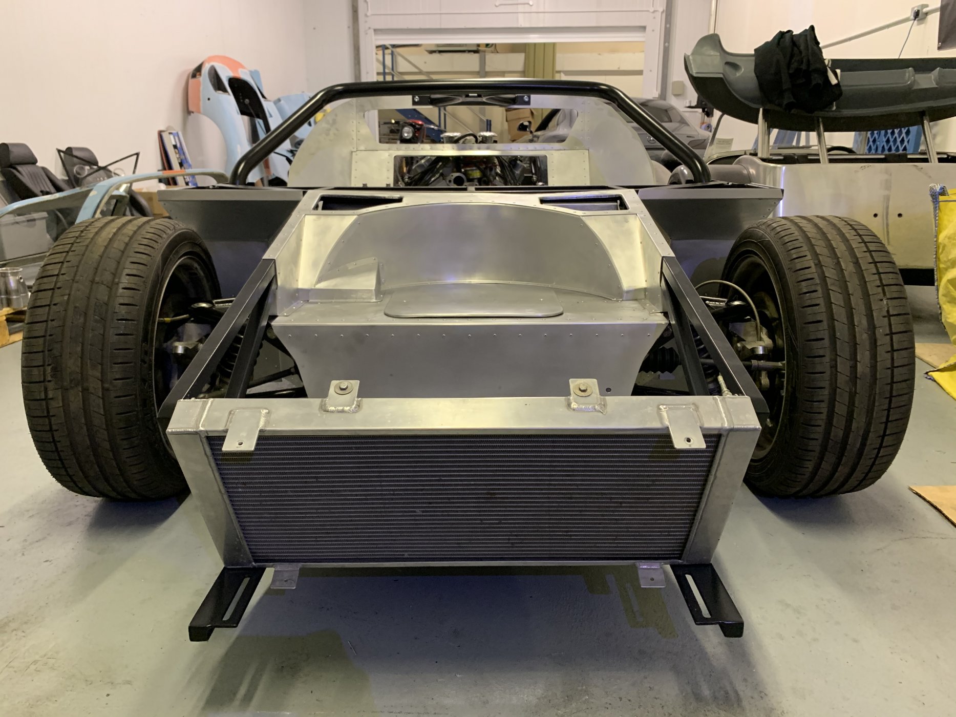

I feel even with the front shocks wound down all the way it’s not sitting as low as I would have liked. Maybe I’ll have to change the coilover set up. Any suggestions?

Maybe best to wait until you have everything attached and full of water, fuel, driver etc before you finally set the ride height. I don't know how you are for speed bumps where you are but I set my ride height to cope with them. 4” front and 4.5” rear ground to chassis.
we are pretty lucky in Guernsey. The roads are flat and speed bumps are very limited. Its easy to avoid them.
At the moment its a good 6.5 inch chassis to ground.

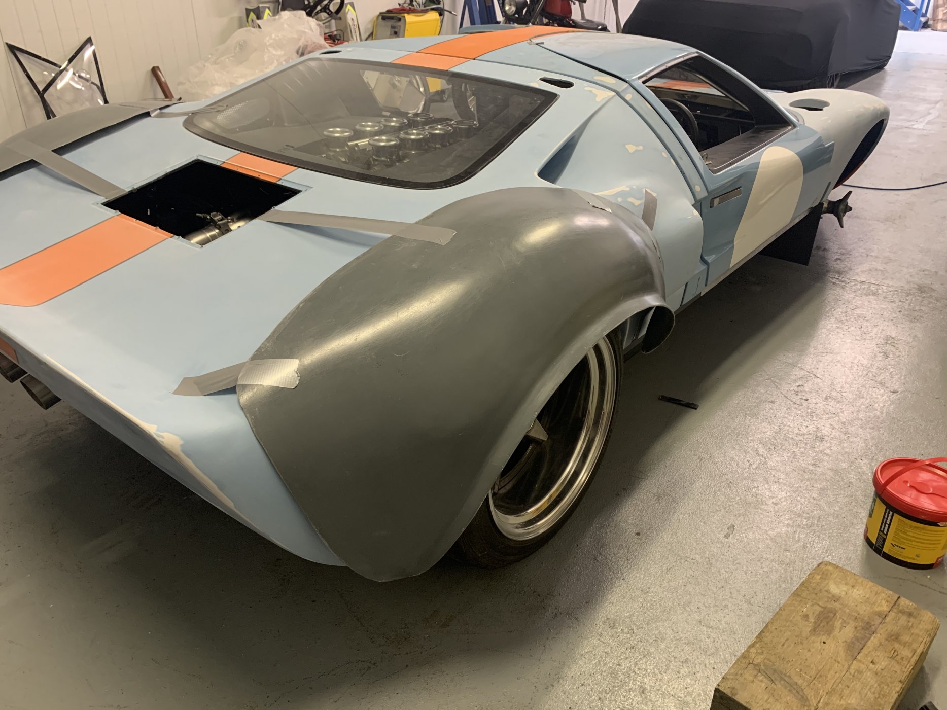

p.s. those arches look huge! are they regular Gulf arches?? Who did you get them from?

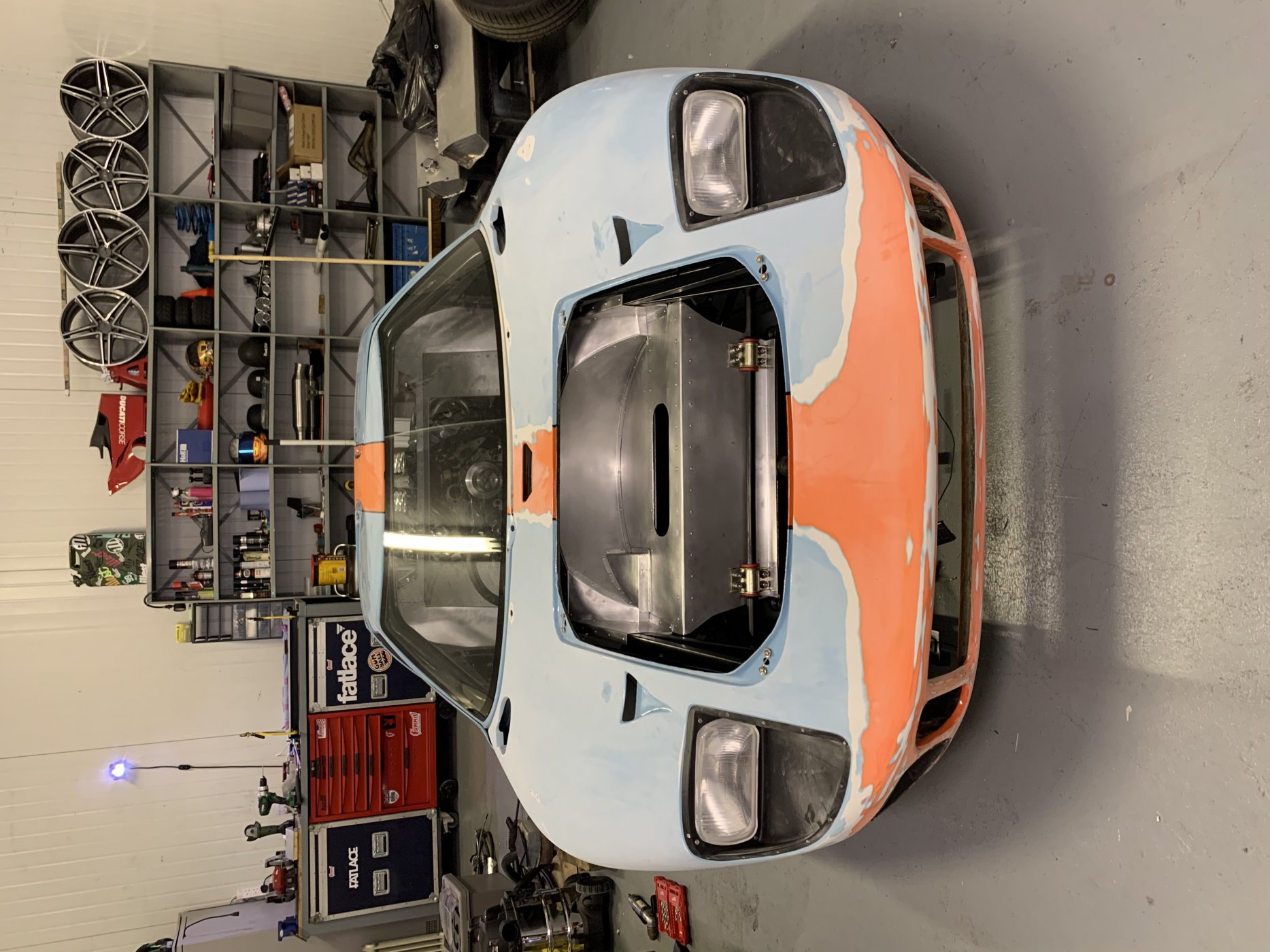

You have done some great work on this project, very impressive. Are you considering changing the engine cover latches to something period correct ?

The arches are based in the original Gulf arches, they are built by the guy who does all of Mark Sibleys glass work. They make the car exactly 2000mm wide. Still 20mm less than my GTC!

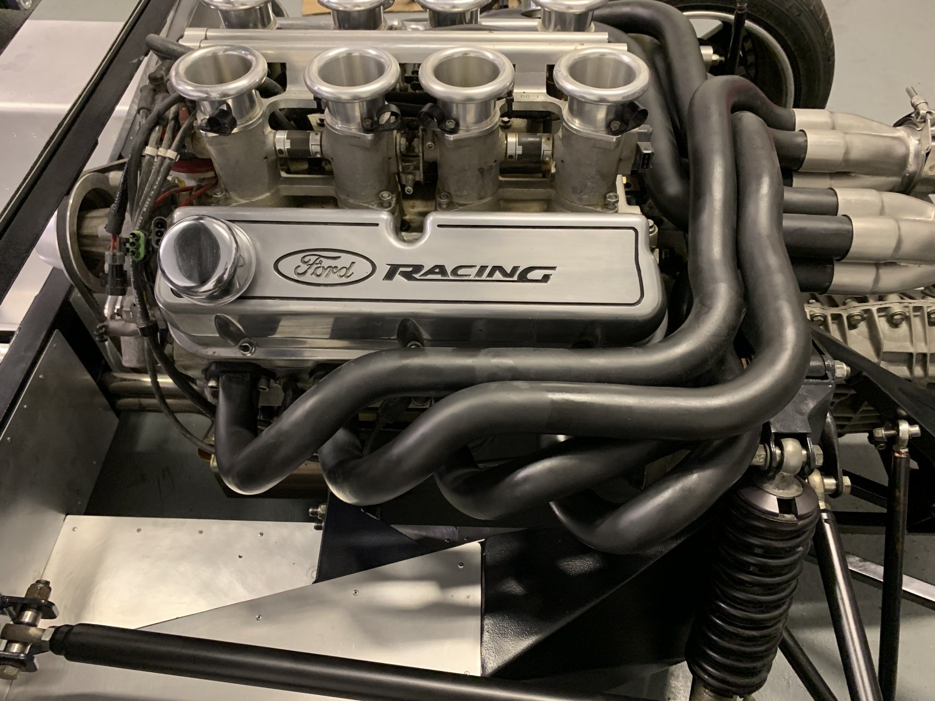

I would like to change the covers I’m just unsure if I do the typical Guerny or find an alternative? Any suggestions?
Sorry, cross purposes. I was thinking of bonnet pins rather than the modern (admittedly better & safer for pedestrians) egg shaped recessed catches.

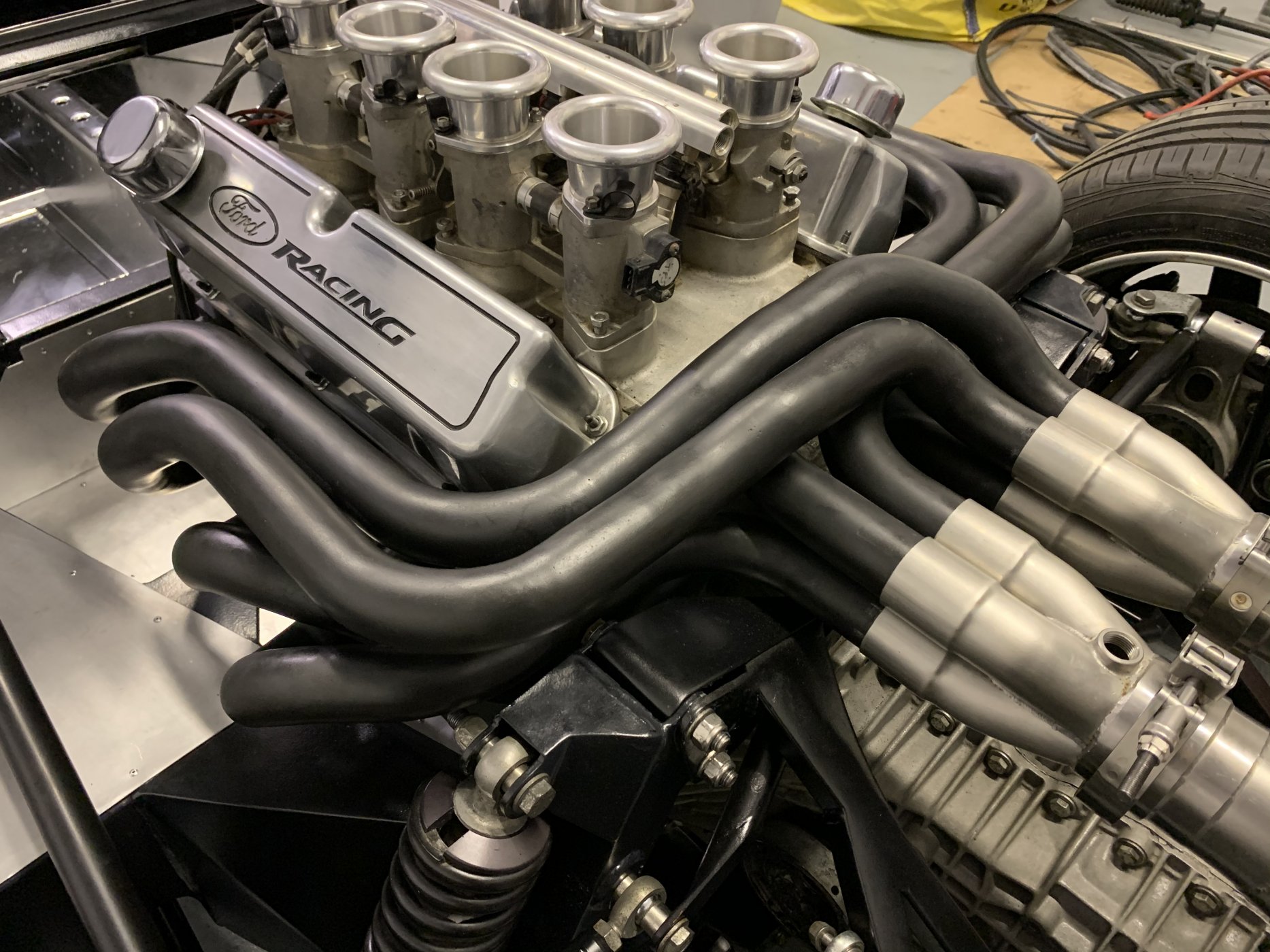

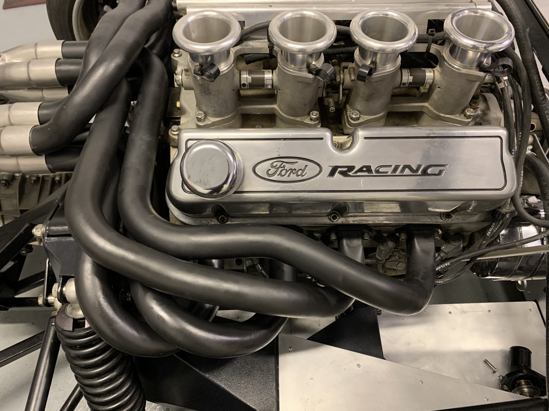

As regards rocker covers, the 'Ford Racing' brand was a nineties thing wasn't it. The Gulf double Le Mans winner has worn both Gurney Weslake & Gurney Eagle rocker covers. Currently it's in 1969 spec with Gurney Eagle covers sprayed satin black with just the words & platforms polished.
Regards Steve
