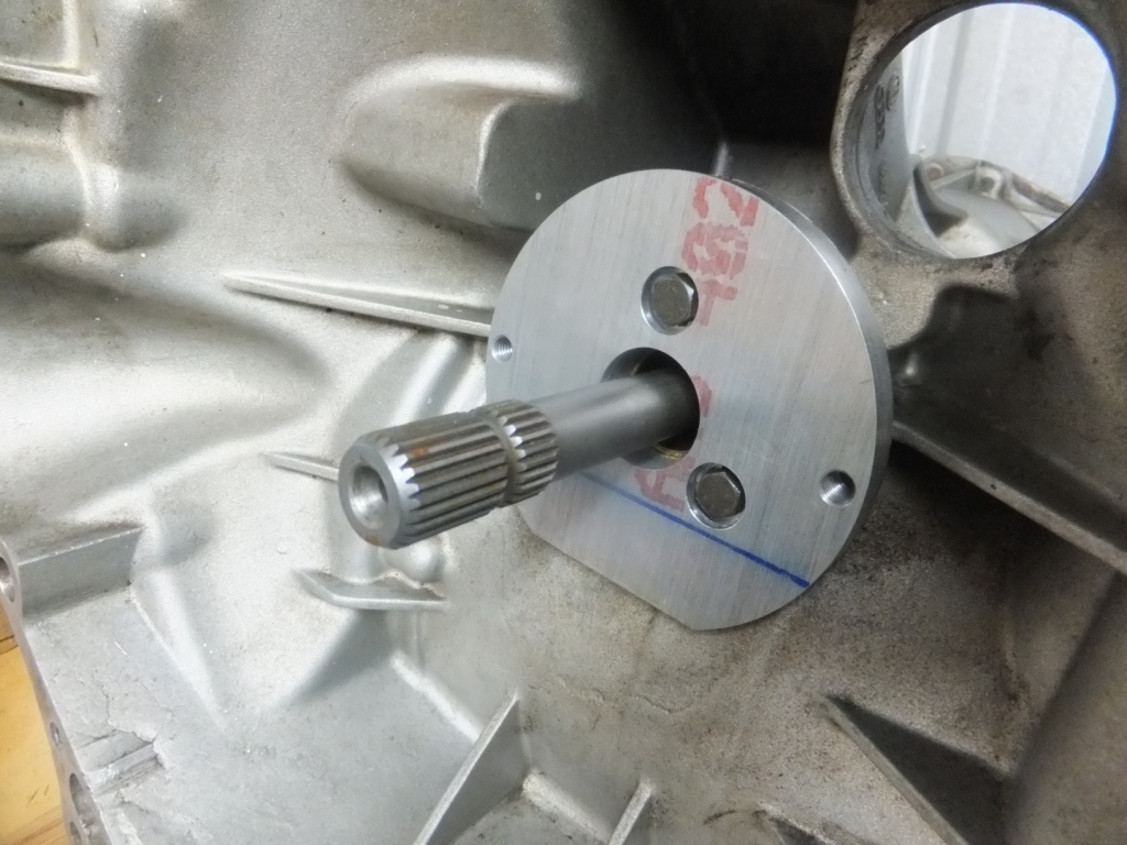

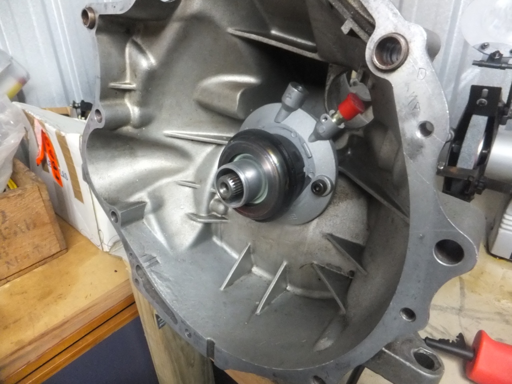

Hi Keith
A while ago I too looked at converting a 924 transaxle.
The things that I ran into were the same things that you are working through.
I found out that the clutch is a pull type not a push type and I would have to use a different clutch ( I think it was a honda civic) and have the center swapped to the porsche one.
I was that keen I even made a mount and fitted a throw out bearing.
The other problem is the bell housing size will restrict you to using a 9 inch clutch and unless you use a twin plate clutch it will struggle to hold the torque of a V8.
I ended up buying a 016 audi transaxle as it was just a better option.
Cheers Craig Young
