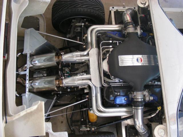

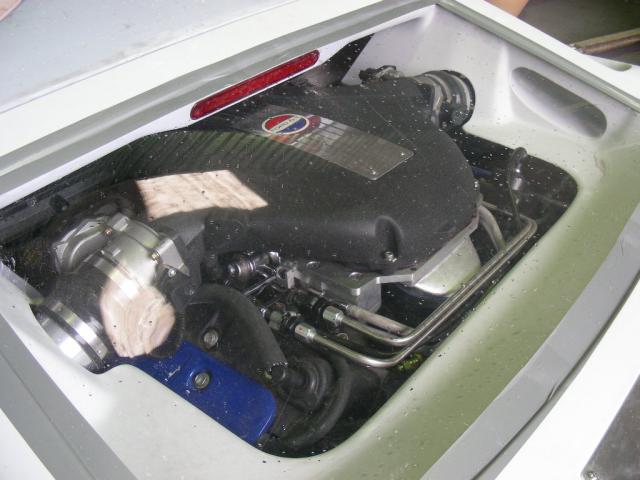

Just finished in time for Christmas - Supercharged 5.4 Mod, great fun, plenty of grunt.
Cheers PB

Very nice! Clean install.....looks like it belongs in there. What did you use for a gearbox and clutch setup in there?
Thanks Chris,
It's a tight space to fit everything in but it all fits and works well. We are still using O1E 6 speeds, no failures yet but some good validaion behind some tough engines - this one has over 600ft/lb of torque
Cheers PB

PB that is one clean looking set up!
