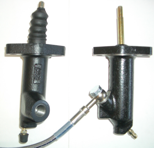

""Have you a part number / photos of the Audi unit.""
I was wrong, it's from a BMW.
1986 BMW 325E 2.7L SOHC
manufacture ATS
part number S04004
cost $30.19 from the local aftermarket parts house. BMW unit on right in pic.
The Porsche unit on the left is aftermarket and $135. Note the angle of the mount flange. When you invert the trans the bleeder is on the bottom but if you flip the slave to put the bleeder on top the angle is wrong and probably puts side loading on the piston/bore.
Also the Porsche inlet is 14mm, there is no adapter that fits, either you buy the Porsche piece, probably an expensive rubber hose or you machine something. The BMW unit has a 10mm X 1.0mm inlet, a common size for hydraulic fittings. I used a banjo and braided steel line so it can be clocked to the best clearance.

Kalun,
Great catch!!! I got my Porsche slave through NAPA for quite a bit less than $135, but the issue with the bleed is a major PITA. I hate bleeding it with the slave removed and then having to compress it enough to bolt it on. On my car, the end of the bleeder is way to close to a frame member and I am constantly worried that it will be broken off. I did solve the fitting issue with an adapter fitting I got from Pegasus, but it has a rubber seal (boss fitting) that is also worrisome. I also found that the Porsche slave cannot be flipped.
I will definitely be getting one of these BMW units! I like the fact that you can use a banjo also; the Porsche boss is not machined flat, so a banjo won't work with it without machining.
