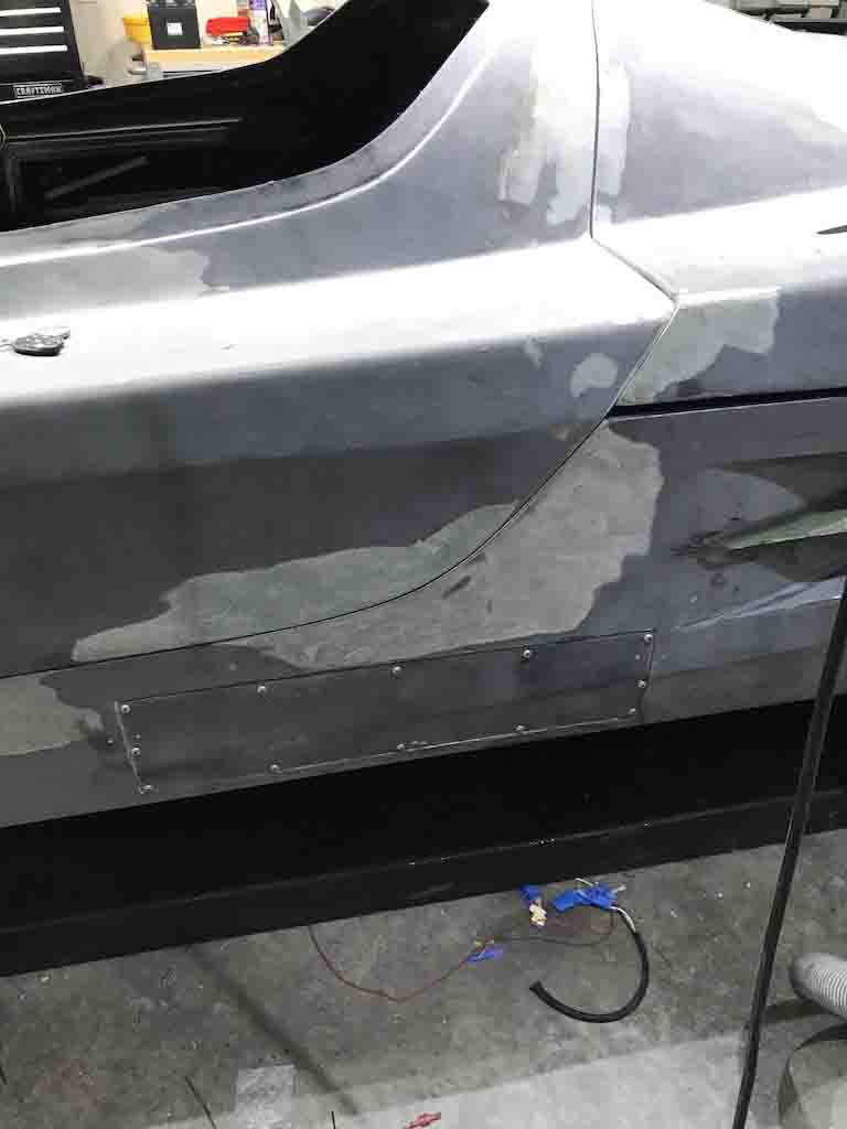

Make an access panel...
http://www.gt40s.com/forum/attachment.php?attachmentid=90532&d=1525744875
Joel K
Thanks Michael,
I put a little brain power into the subject and I came up with the following. Mount the e-stopp and the two into one cable bracket on a 1/4" aluminum L-angle rod however long it needs to be like 24-30".
Then attach the whole assembly to the bottom of the rear of the driver outside floor pan using countersunk screws through the bottom into the L-angle. Since all the stress/pressure would be on the bracket where the e-stopp and cable bracket is just securing with 4-6 countersunk screws should do the trick.
Then if I had to service the unit:
1) Take the side skirt off
2) Remove the countersunk screws and slide the whole assembly out toward the rear wheel.
3) I would think if you removed the rear wheel you could slide the who assembly out.
Since I don't have the car yet, not sure if this will work but this is one approach I came up with.
