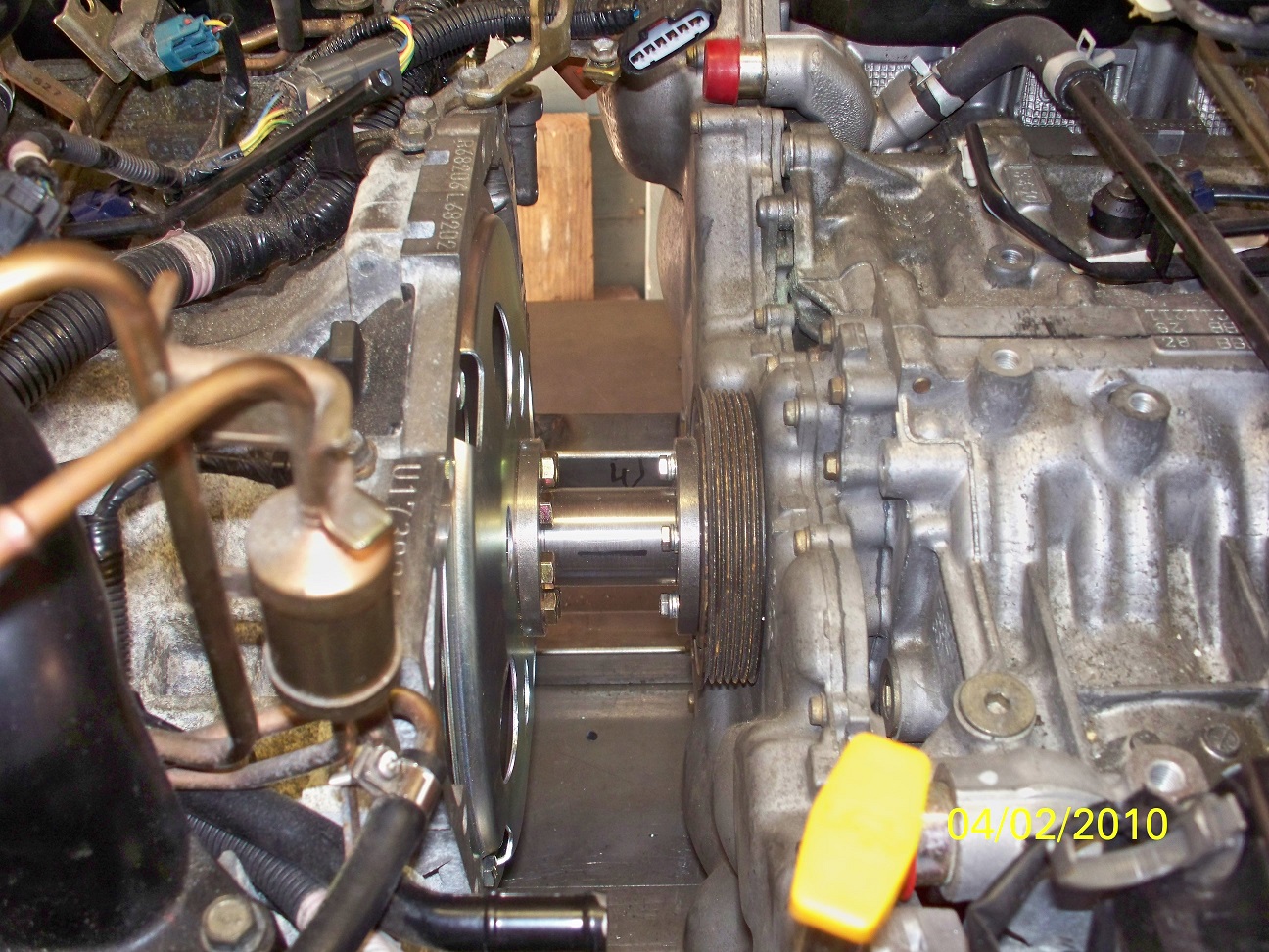

I've looked through your video's, but can't seem to find any info on the actual engine coupling.
Maybe I've missed it ??

Hi Jack

Hi Clayton,
I have the front engine attached to the rear engine's pulley via two rim to rim flex plates. I found out the pulley material is very weak so I'm changing the connection design to one of two I have come up with. When I redo it, I'll post it.
Jack

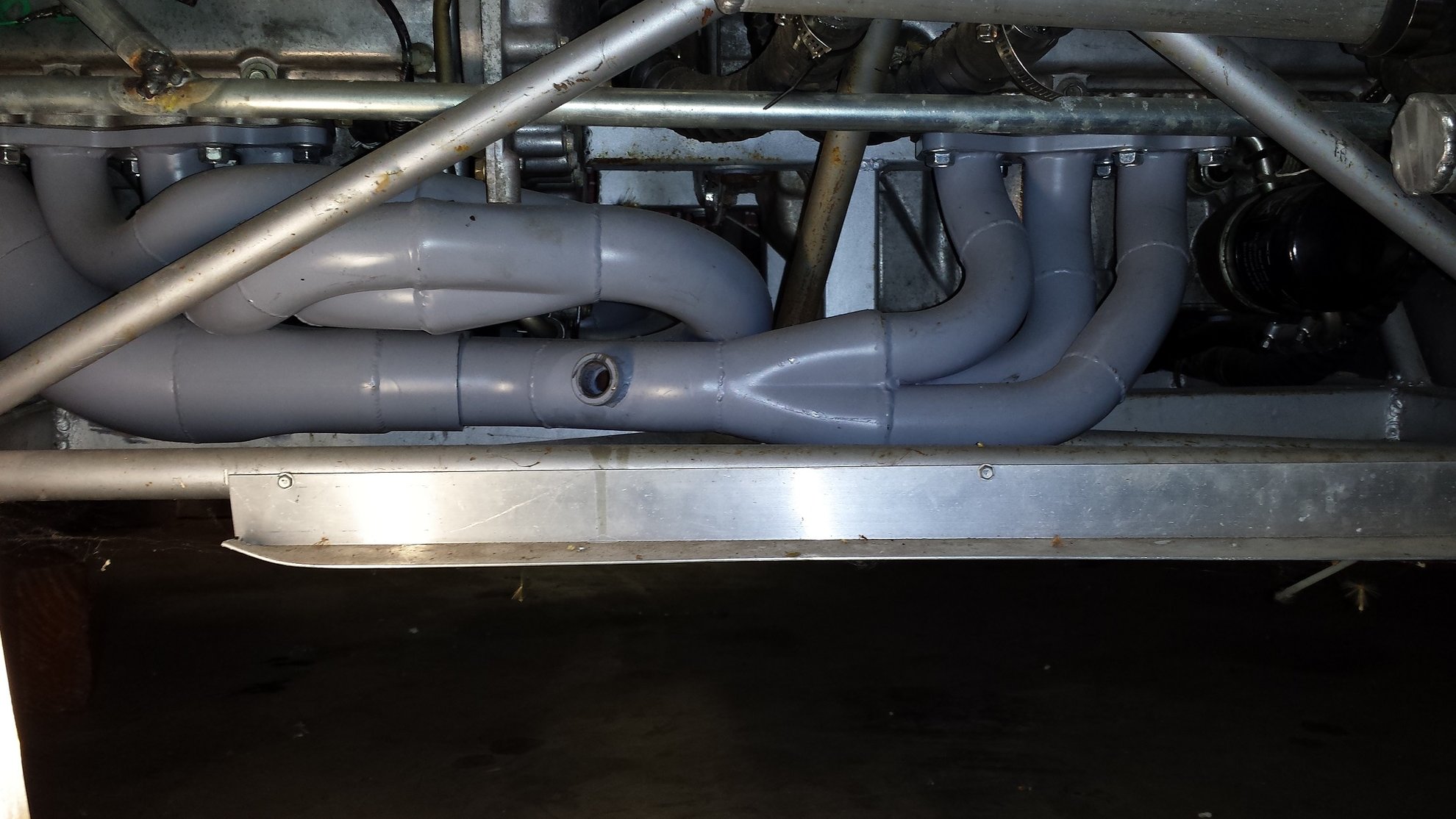

Jack, are you using the early 3.0 engines with single exh port per bank of 3 cyls or the later 3.0r with individual exh ports? Just curious.
