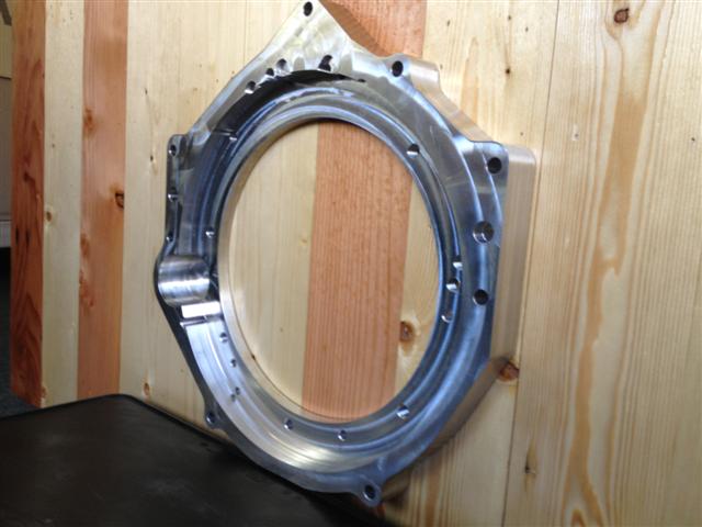

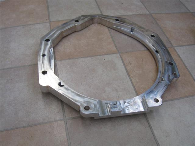

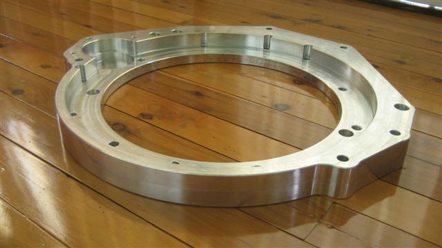

Ford, Chev or lexus to Audi 01E or 012
KEP makes a small block to 01E/016/012 adapter and Eric Marten makes an adapter for an LS engine to 01E/016/012.
The adapter for the 016 will not work for the 01E due to some differences in the holes and the input shafts are different lengths. I do the adapters for the SBC, SBF, Ford Mod motors, LS engines and the BMW V12.
I thought it was for the 016/5000 only? The bolt patterns match on the adaptor, but when I bought mine, I had to do a new bearing adaptor and make up a new drive plate? Have they updated the kit?
I've used KEP adapters mated against early 01E housings, which require modified dowel pins. The later 01E cases won't work against the KEP adapter as there is a dowel pin that is relocated.
the 01E clutch splines are different than the 016 meaning a clutch disc change and the pilot bearing is in a different location.
