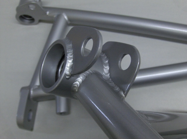

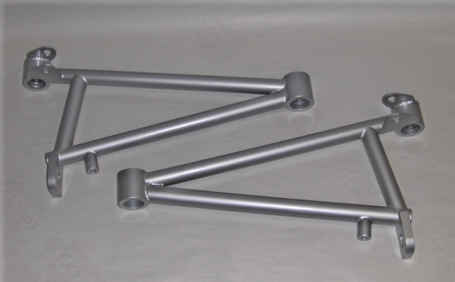

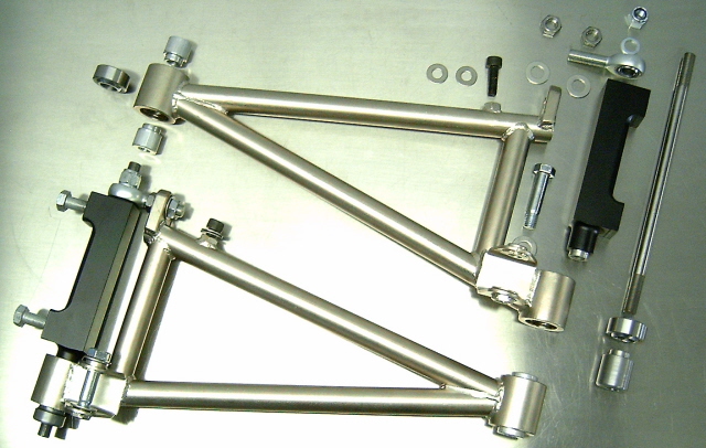

In the pictures you can see the latest version of the Reversed Lower A-Arms have new shock absorber mounts to give more shock travel and some subtle reposition of the tubing to give more range in the toe adjustment. Also the quality of the tig welding is a thing of beauty in itself.
All around a great part, our first upgrade part for the "Series 100" cars and single biggest improvement you can make.
The CAV Canada Reversed Lower A-Arm Kit sells for 890.00 per arm, including the toe adjusting rod end, genuine Aurora Monoballs, hardware and choice of Aluminum Metallic or Black paint. This is for retro-fit to the stock cast uprights as the strengthened lower clevis pin mounts are supplied with.
In a package with the new Steel Rear Uprights you save 110.00 per arm with discount as the clevis mounting blocks are not used.
So the deal with 10% discount for Forum members drops the pair of arms down by 178.00 net 1602.00 before shipping. That's our lowest price a pair for the stock rear upright application!
