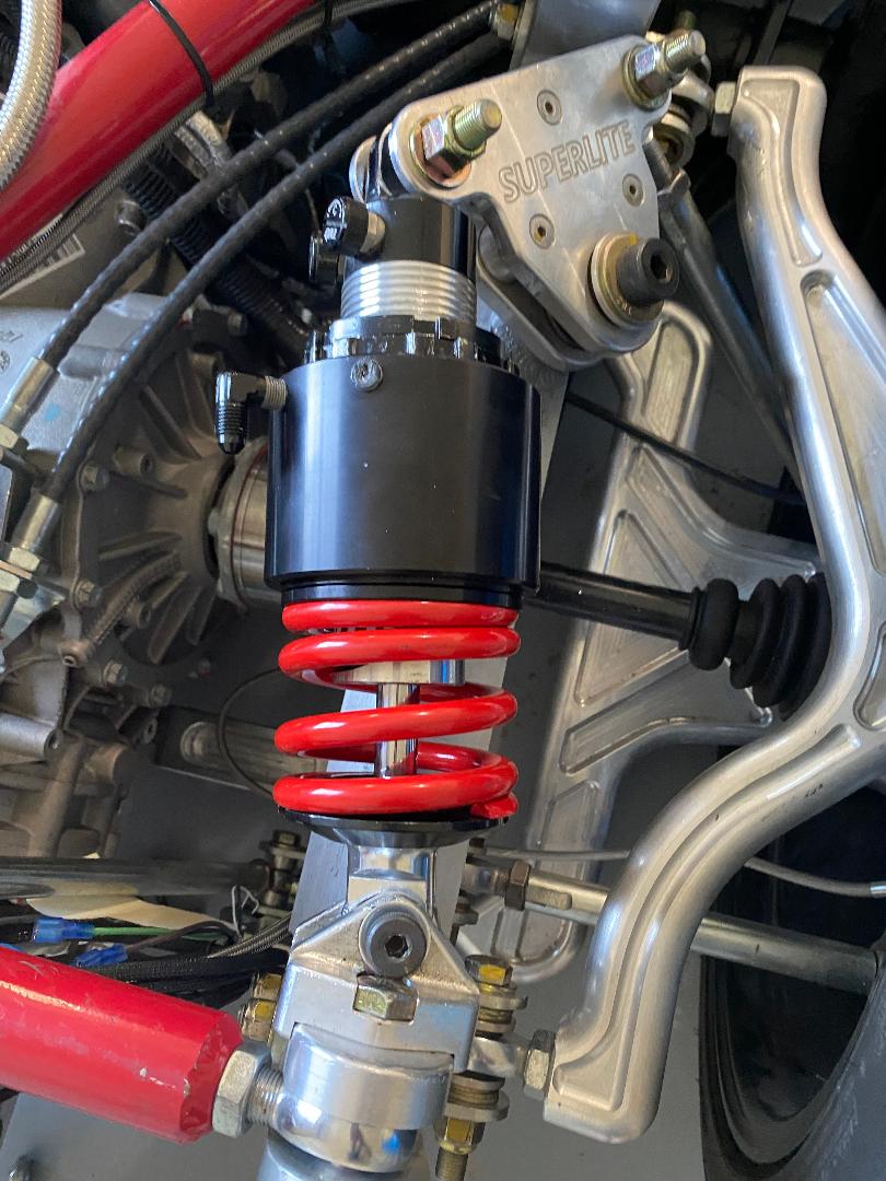

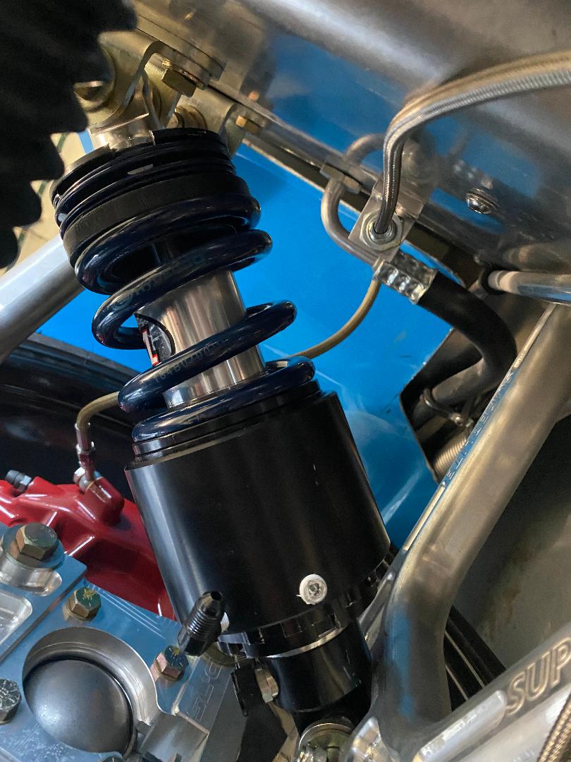

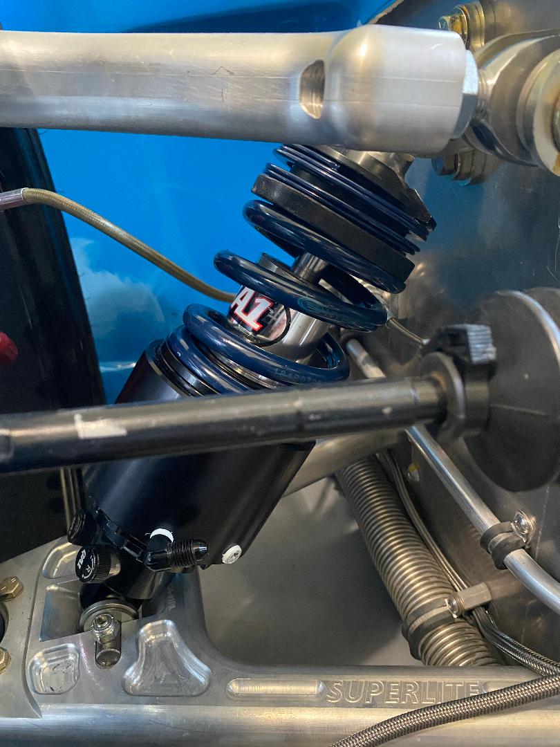

Hey guys, I've researched left and right and after 3 sets of springs for the front and back, I'm somewhat struggling with finding the best fit for the ramliftpro cups.. i feel like in a perfect world i would find 2.5"ID 5" length springs and they may do the trick. However the 4" springs are working but not a lot of room to compress when you do the 2.5 inch lift. I guess what I'm asking is what size springs do you all run with the lift ups? I've even played w spring helpers LOL!!! Here are some pictures of the front and rear set up.. I do have 6" springs ill try on the front and see what they do.

Take all my advice with a grain of salt. I believe the ram lifts for the back are a waste. You should have about 4-4.5im of clearance at the lowest points. That should be more than plenty for anything. My ram lifts aren’t the quickest for the front, can’t imagine how much they might struggle on the rear with all the weight.
General consensus is to flip the shocks on the front, lift on top and springs on bottom.

I have two on the front clam and two on the rear. If you look at cams blog you can see how he attached the front clam. I can’t for the life of me find the thread of who made their own front hinges. Possibly Mark? I think there was definitely one other too. My front springs are 4in. Can’t remember the rate as the car is with allen.
