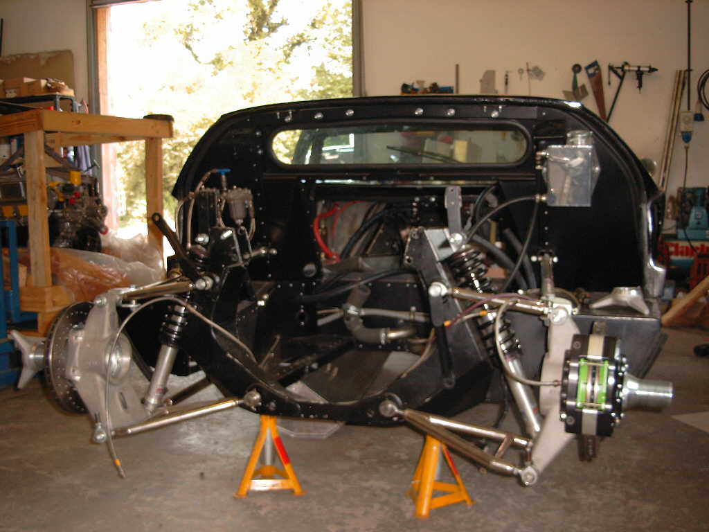

Mark, welcome to the forum and you will find there are quite a few GT40 owners not far from you. As for the MDA, I can offer the following advice. If the gear change is cable drive rather than linkage I had similar issues with mine and have a few things to advise you on that should fix it. I would be very surprised if the fuel pumps are in the tanks on an MDA. Mine are in the engine bay, just behind the passenger (nearside). You can see the fuel filters which are just above the pumps in the attached photo on the left side just behind the suspension. Send me a private message if you need to have a more in depth chat, or come and pour over mine anytime. I am in Torquay.

I very much doubt the pumps will be in the tank. If they're not visible behind the bulkhead, they maybe in the sill just behind the tanks.

Hello Mark.. if this was the car sold by Mole Valley TVR, then someone, perhaps you, asked me about it. Although I don't know the car, I tried to send the enquirer an email, but it bounced back twice. I didn't wish to appear rude by not responding, but it was impossible. If not already, please join the GT40 Enthusiasts Club and drive your lovely GT40 at Le Mans Classic this year. Details and booking form on GT40 Enthusiasts Club - Front Page Finally, if you cannot see the pumps, then they are probably in the sill behind the nearside tank. Regards.. Andrew (Chairman)
