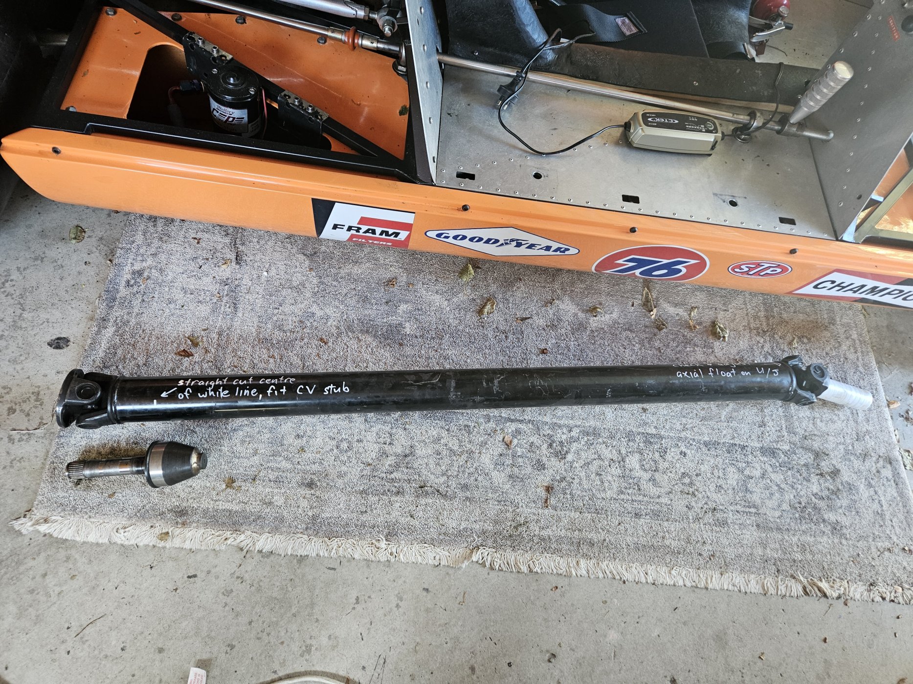

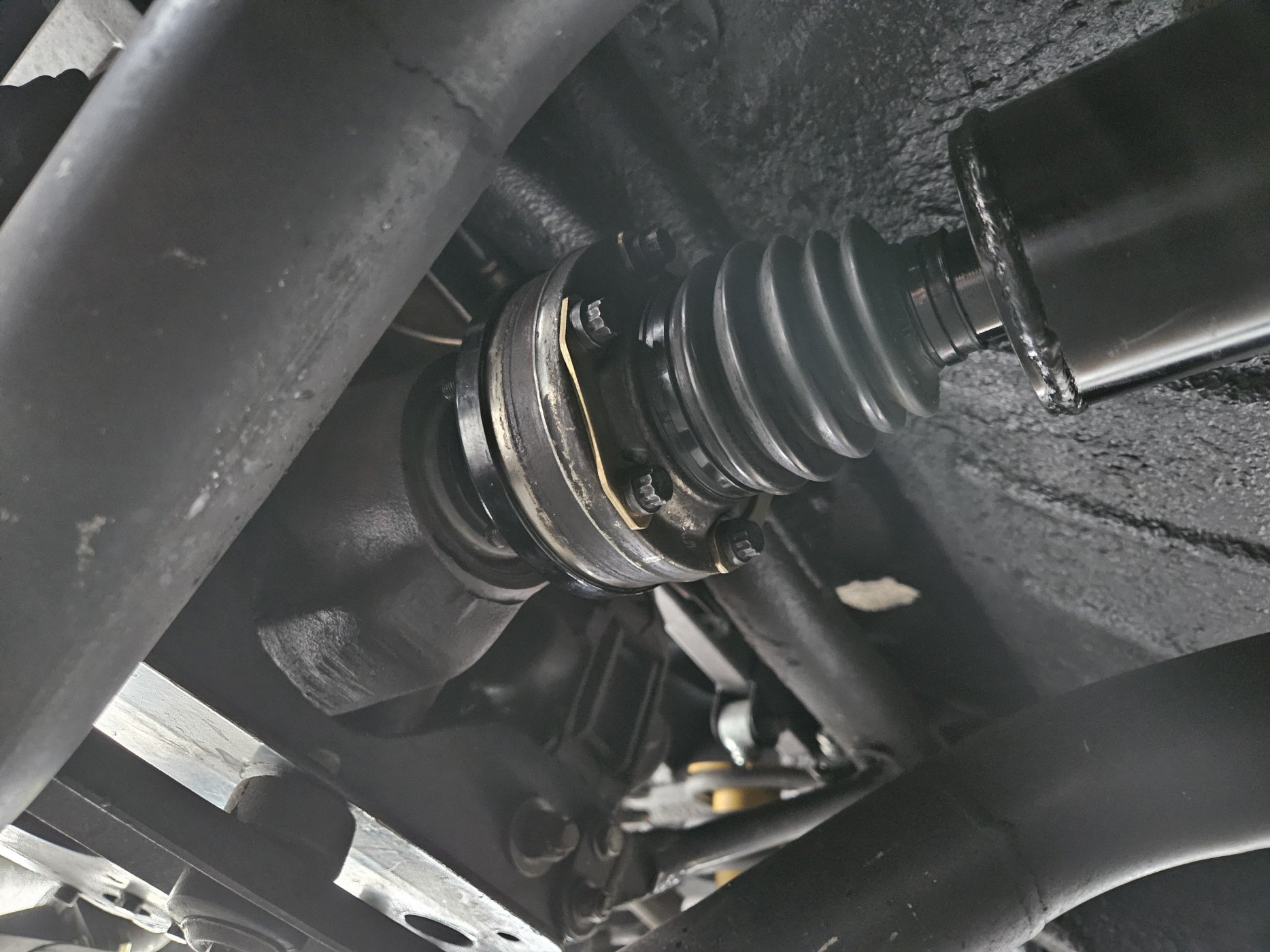

Generally speaking its getting better and better as I work little bugs out. Steadily working on eliminating driveline vibration at higher speeds, and have had a CV drive flange and a CV stub axle made up for the driveshaft and Jag diff by Bettany Gears in Kapiti. I had over 4 degrees of working angle at the diff end which is now addressed by the CV, and now have a remaining 1.6 degree working angle at the front where I retain a standard UJ and yoke. I know around 0.5 degrees would be better at the front but that's as close as I can easily get. That has made a positive difference - it has raised the RPM where I get a pretty bad vibrating resonance with the car running up on stands, which now happens at about 95-105 mph then clears above that. Here are photos of the driveshaft mods.
