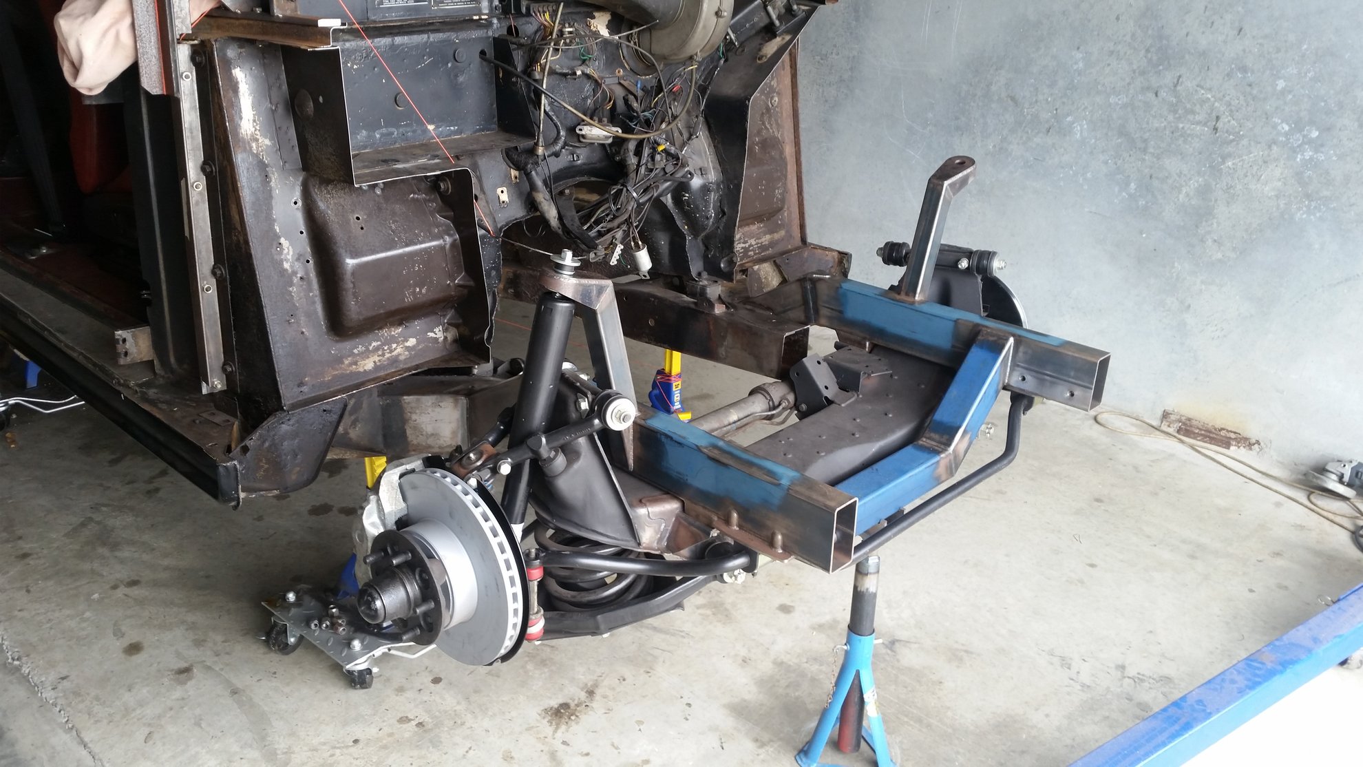

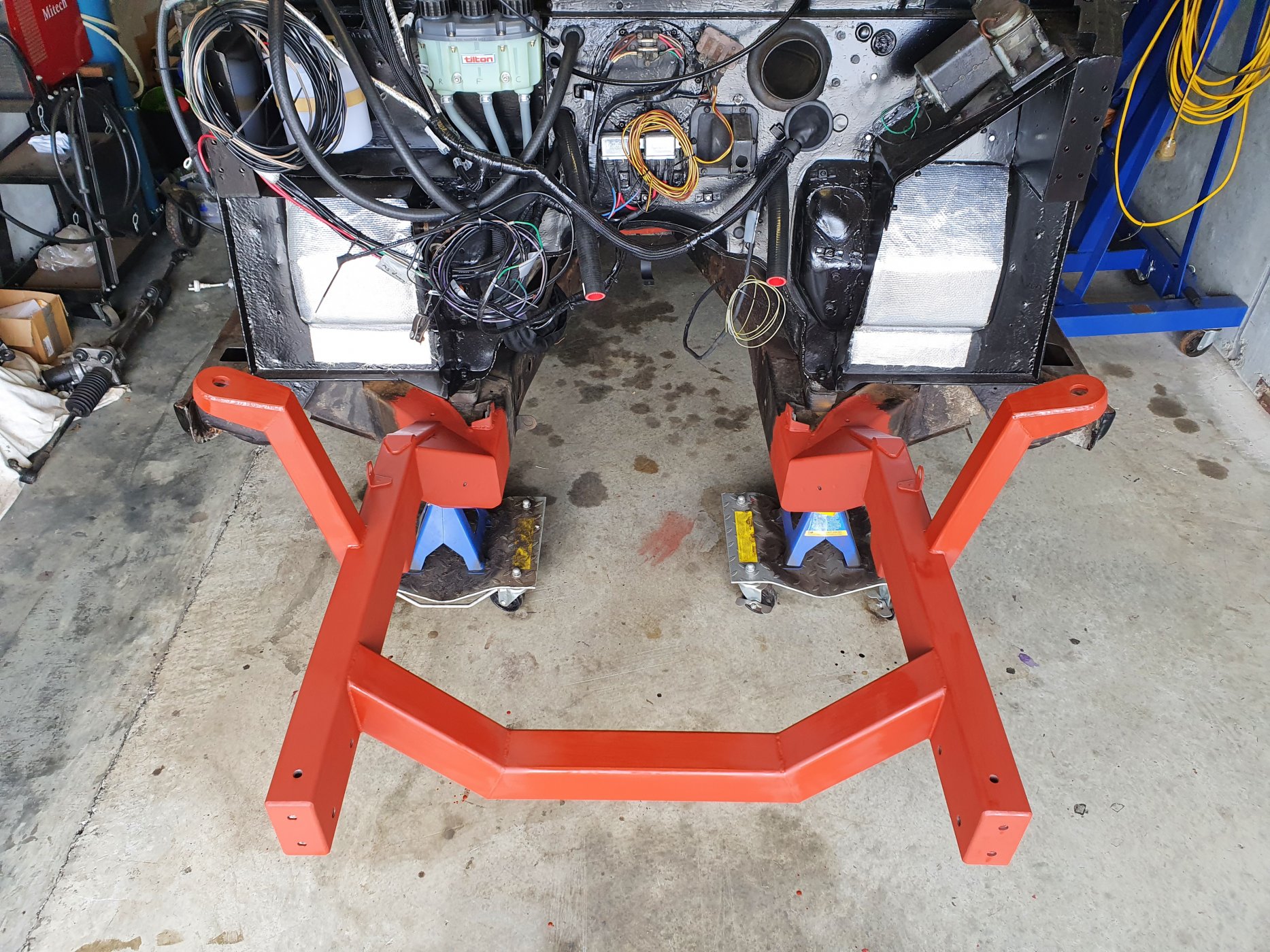

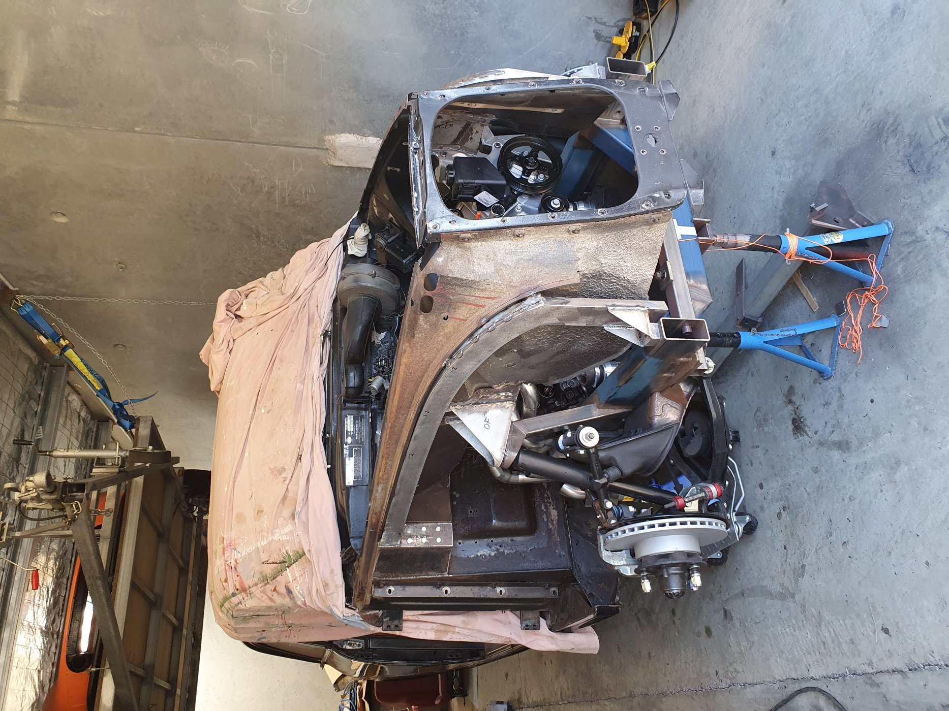

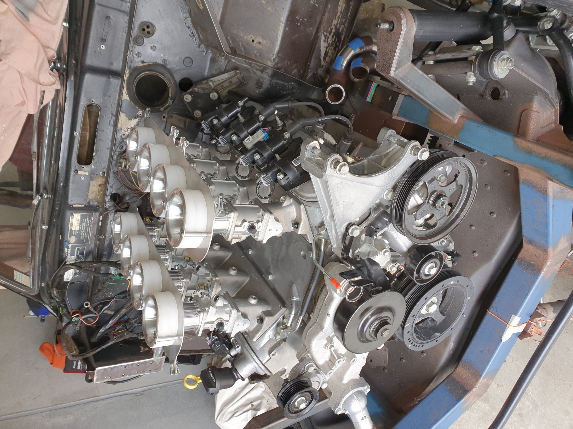

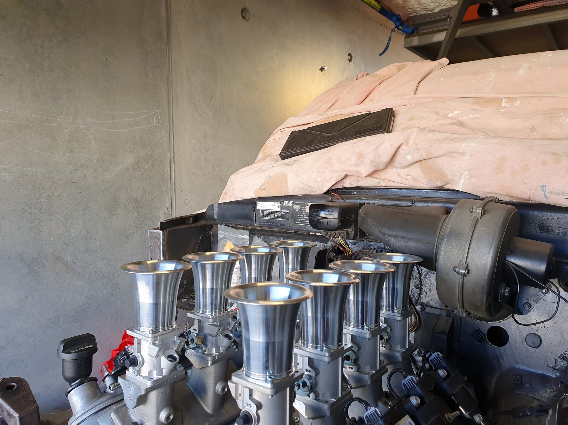

Work is going well. I am putting Jaguar brakes and suspension at both ends. The front end has been braced so it keeps dimensionally stable when the existing front rails are cut-off and re-fabricated, and a frame to carry the Jag powerlock diff and suspension is being fitted between the rear rails. I have a new LS3 with a cam upgrade and a TKO600 5 speed ready to slot in. The LS3 weighs no more than the C-series. New inner guards will also be fabricated.

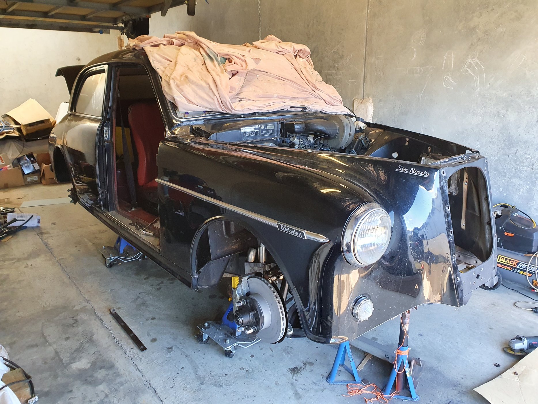

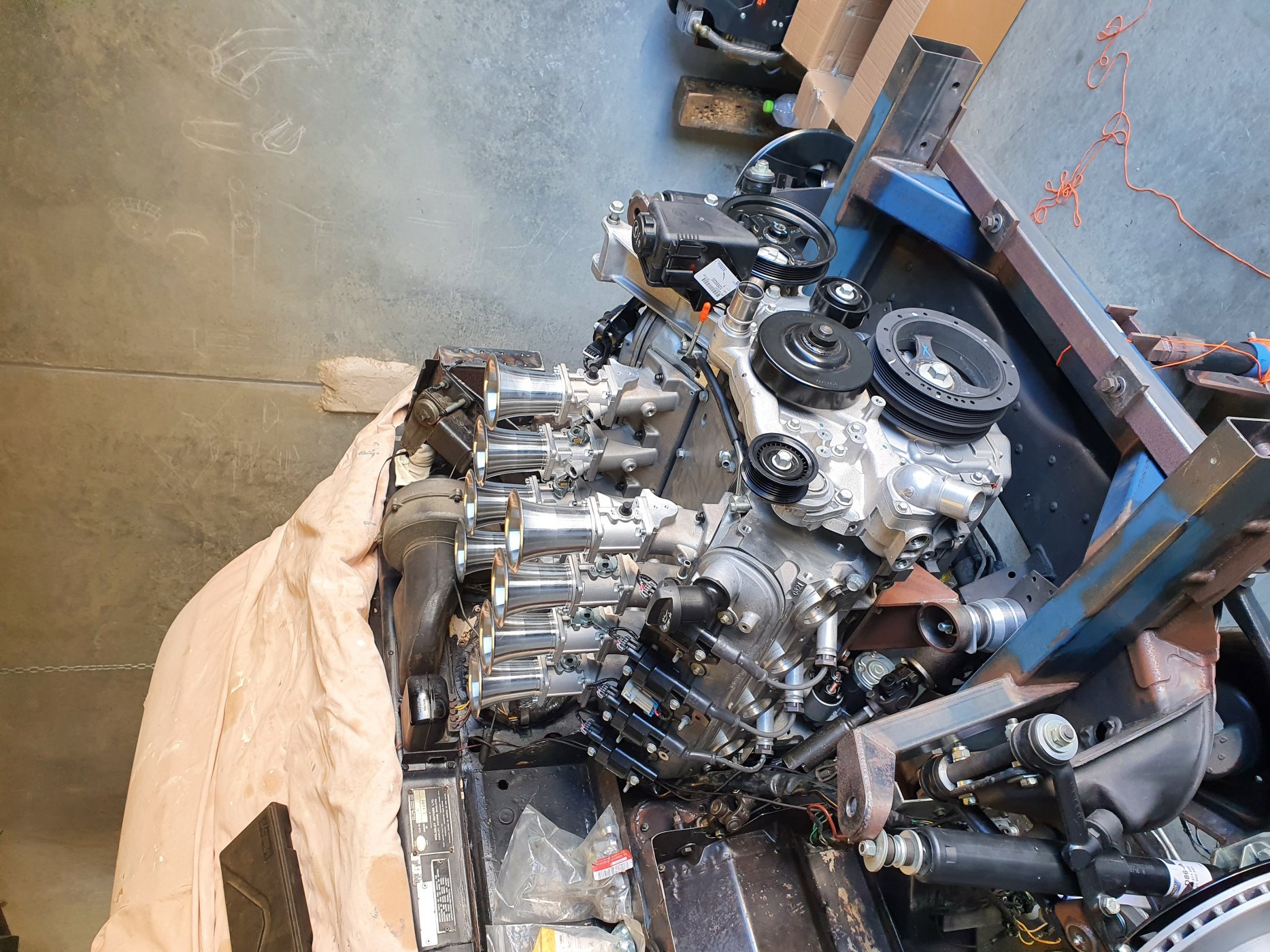

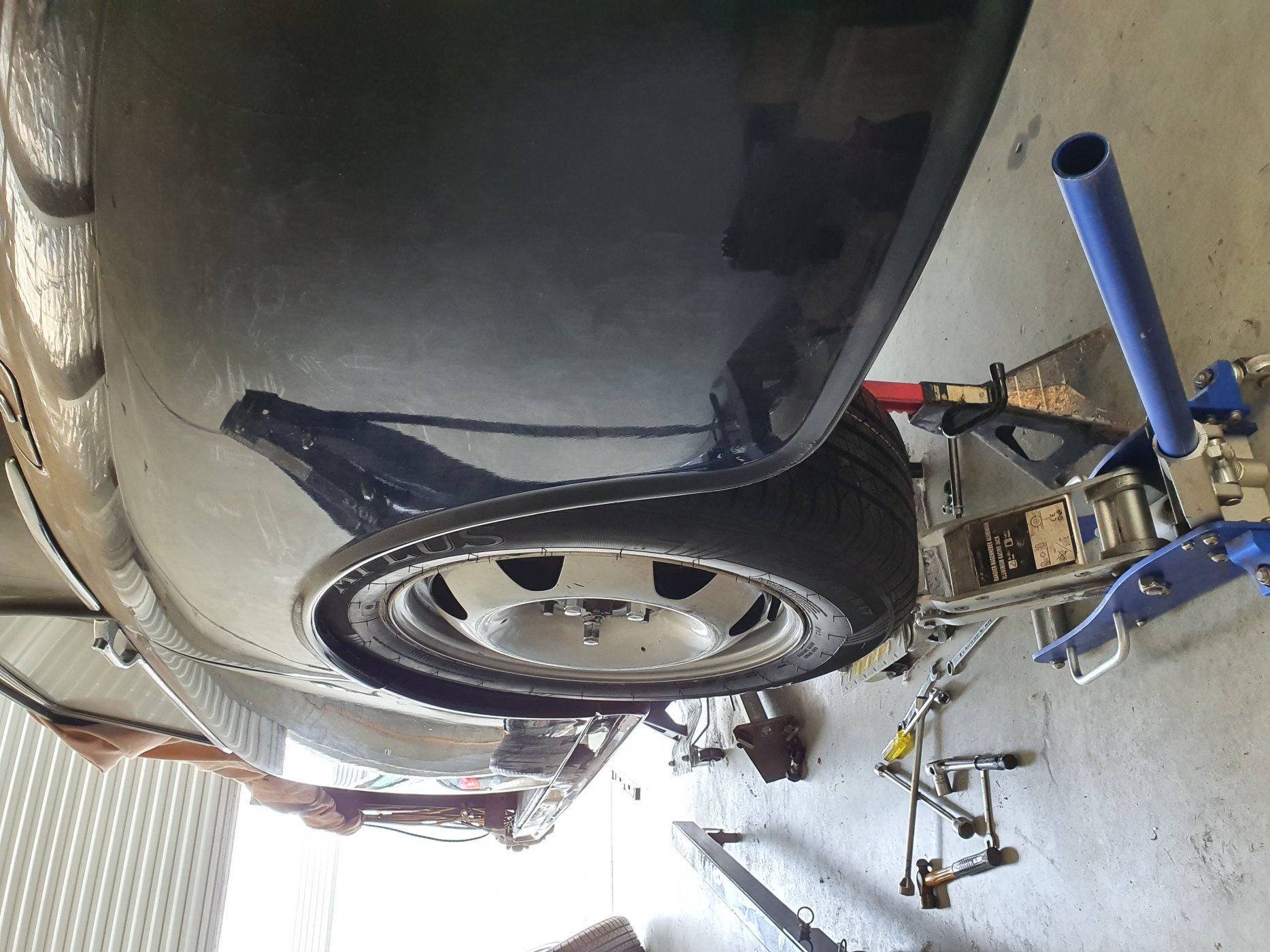

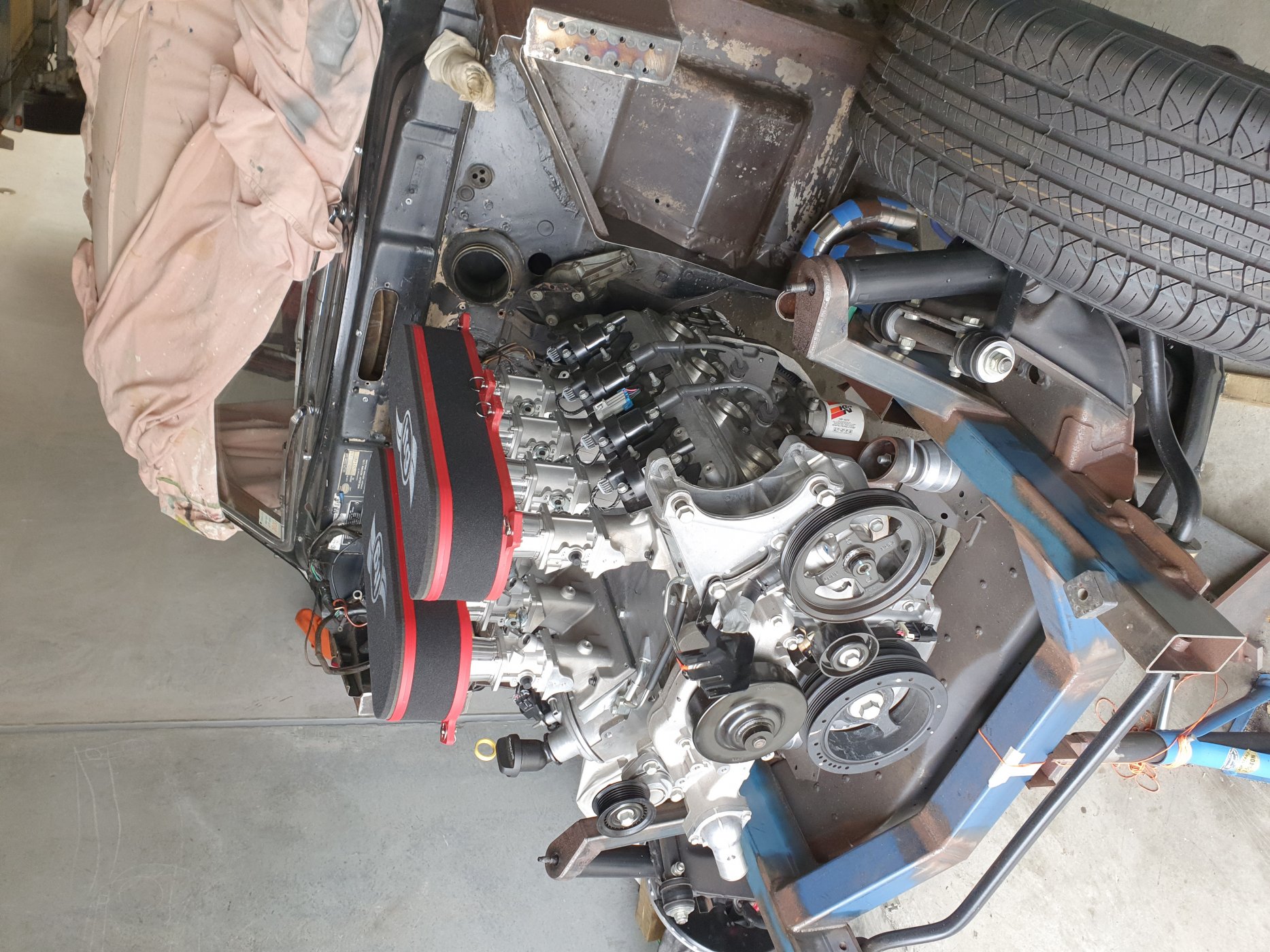

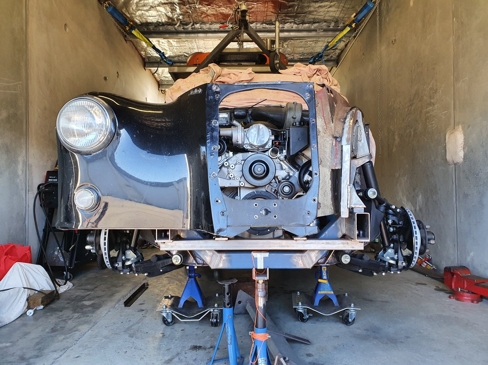

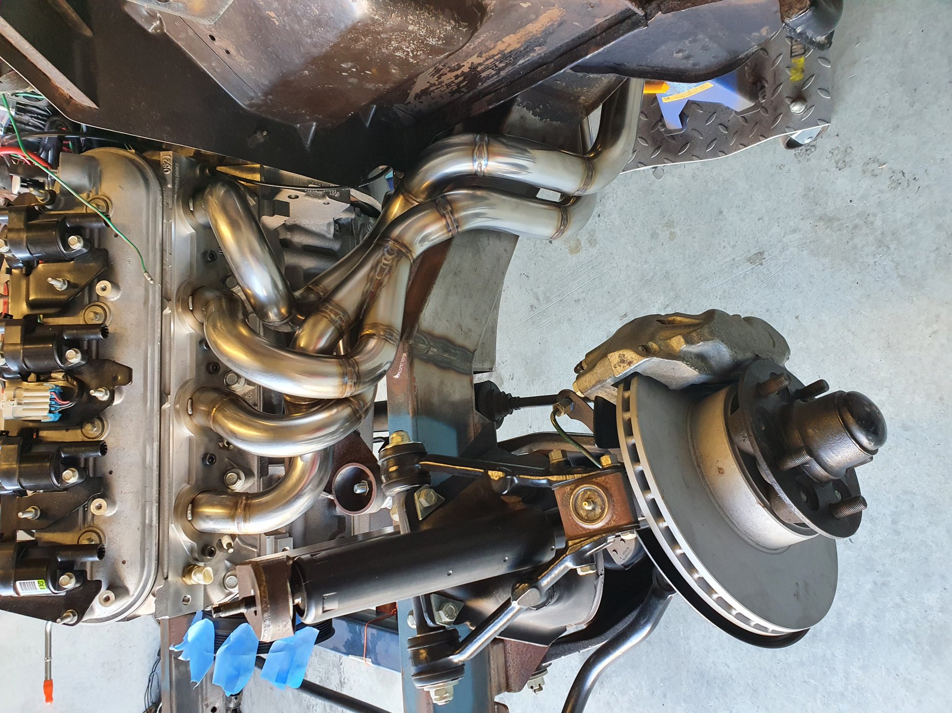

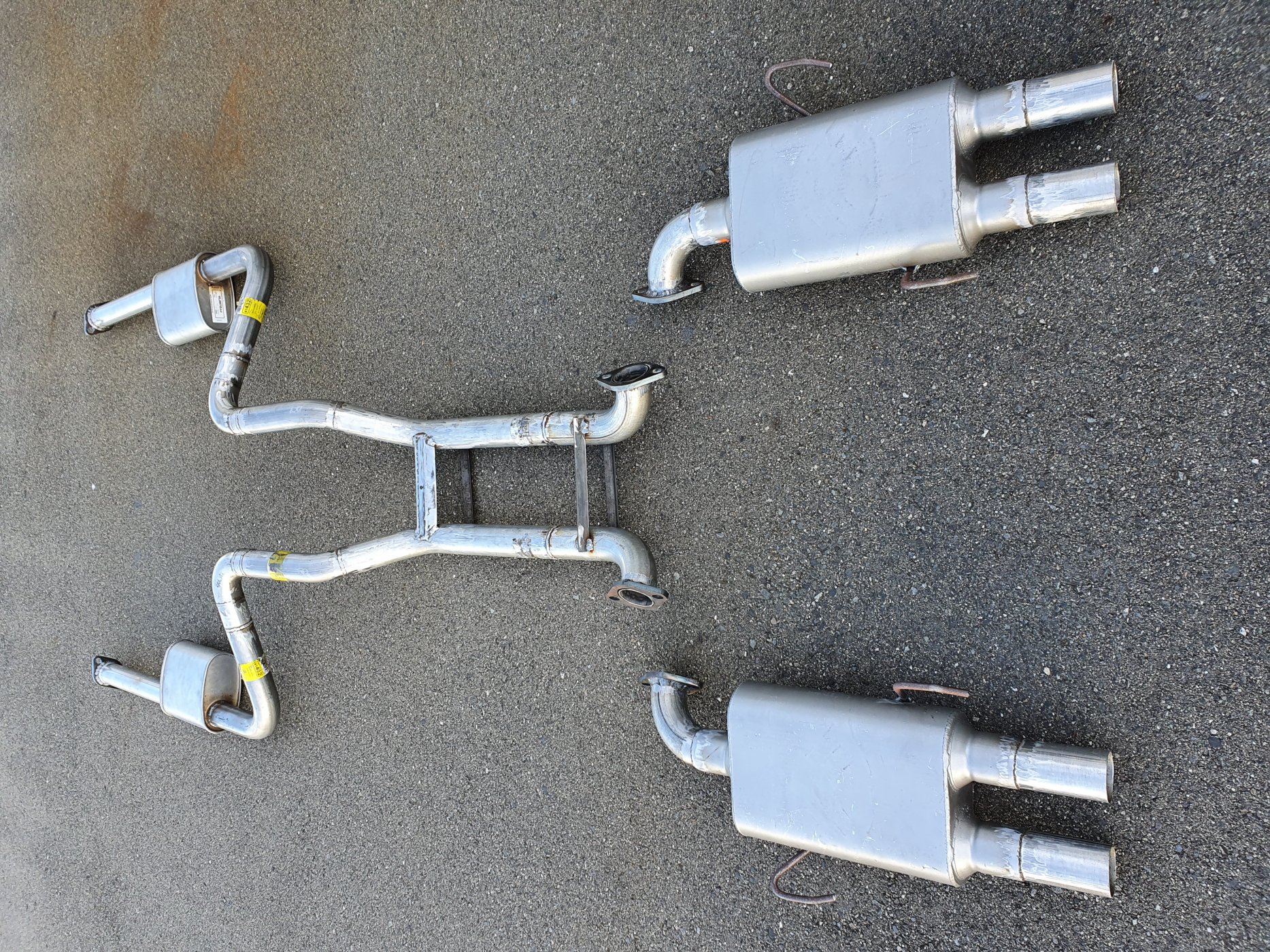

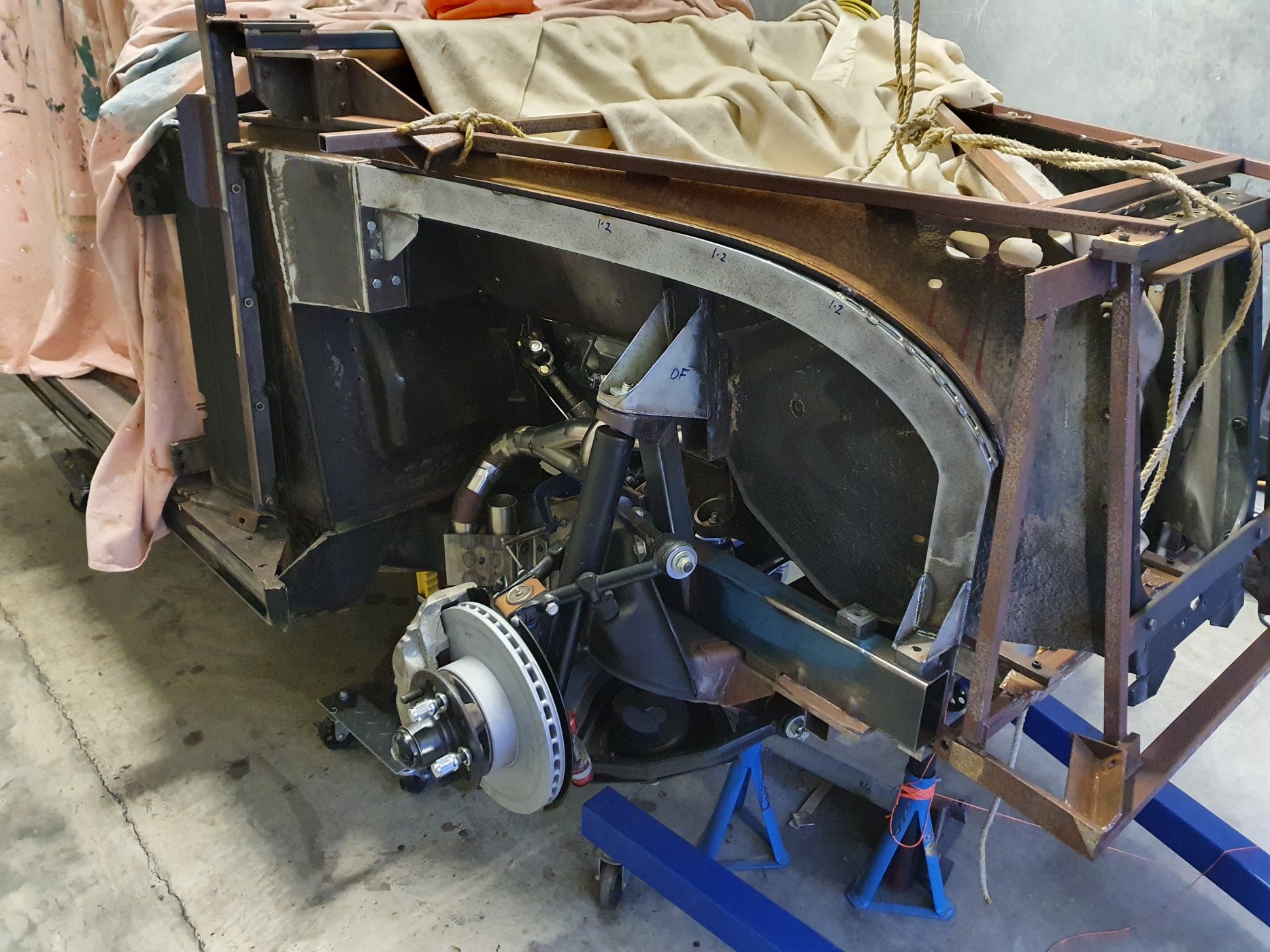

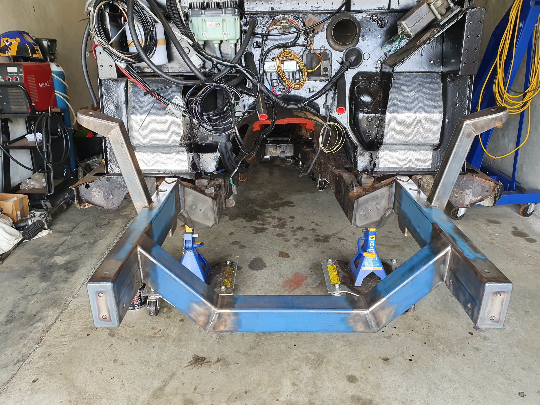

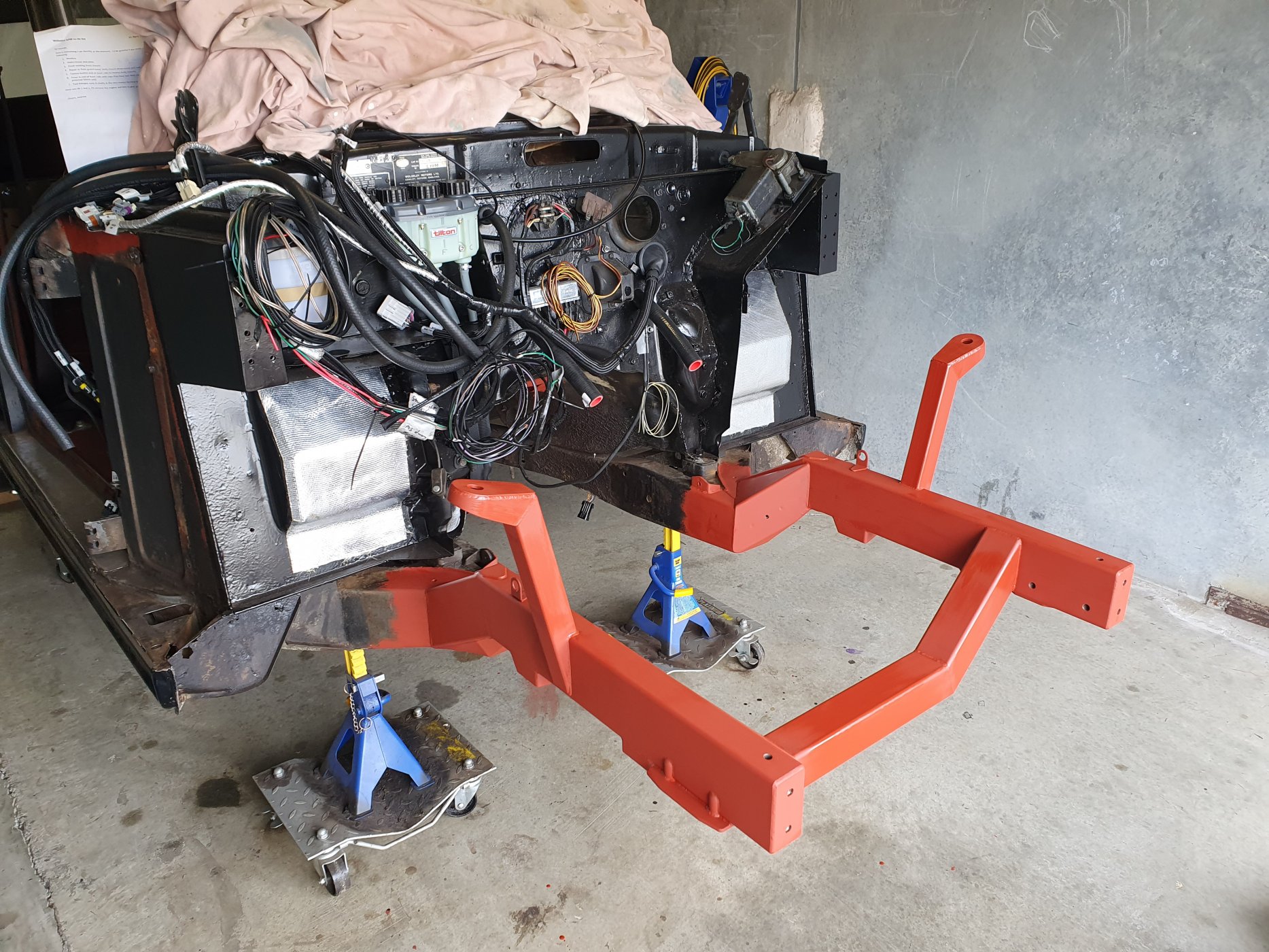

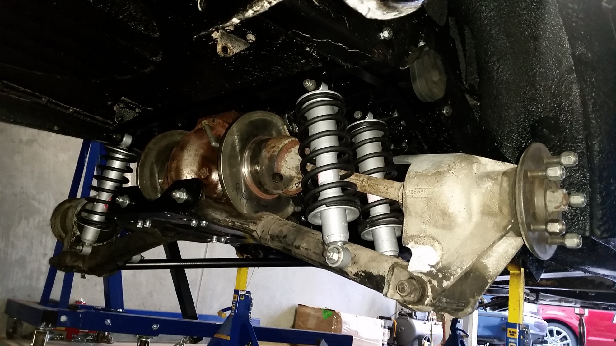

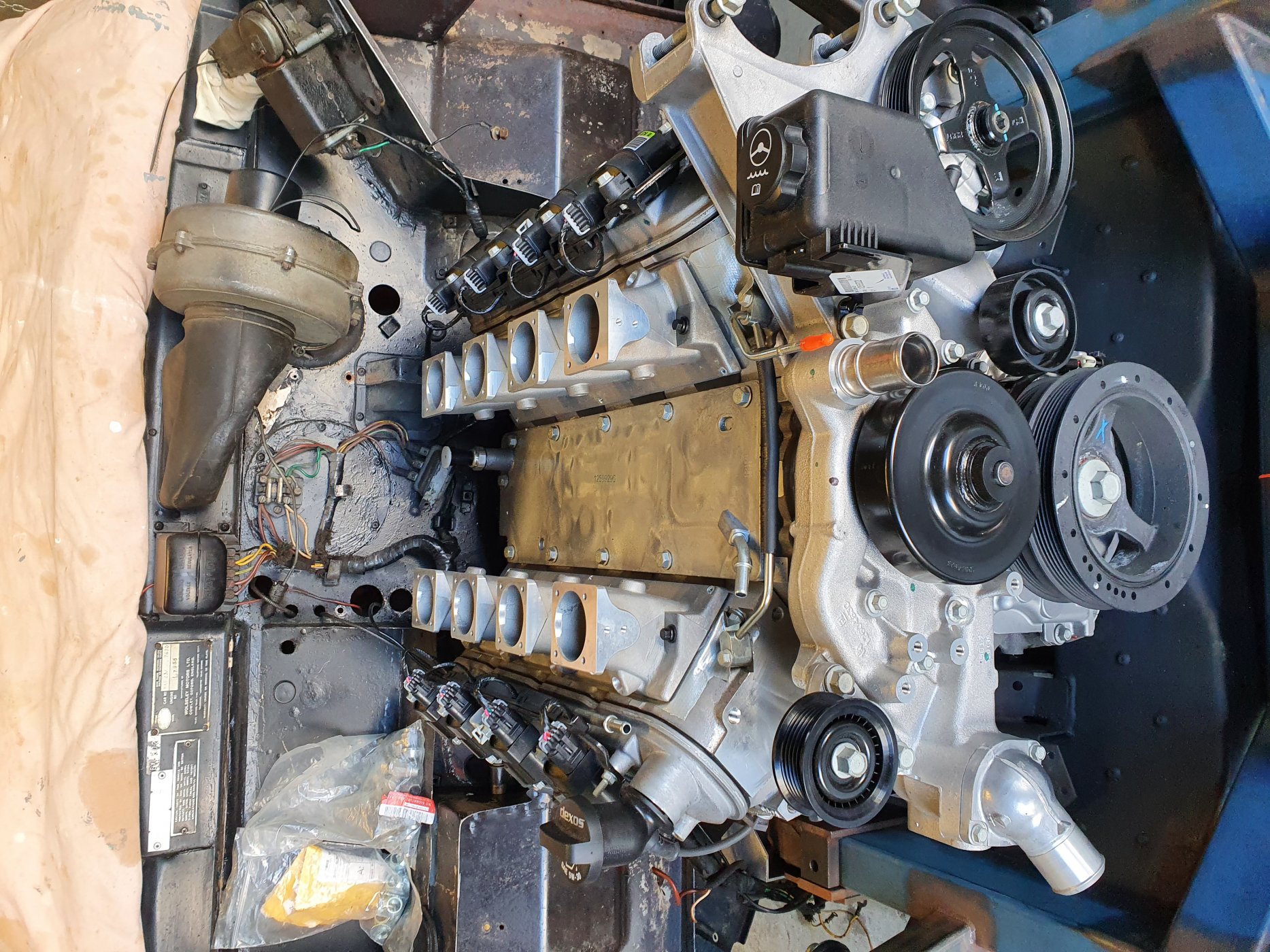

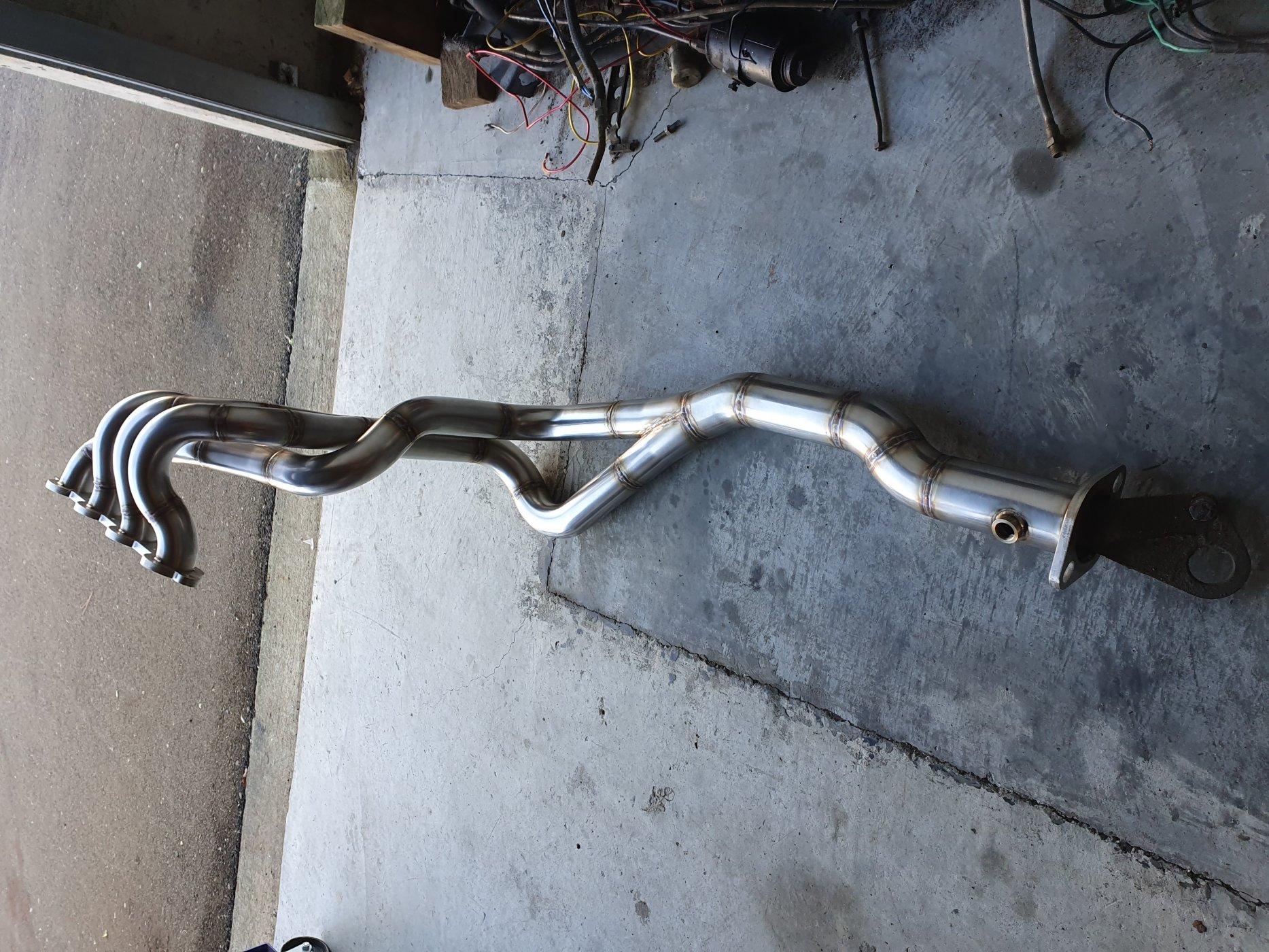

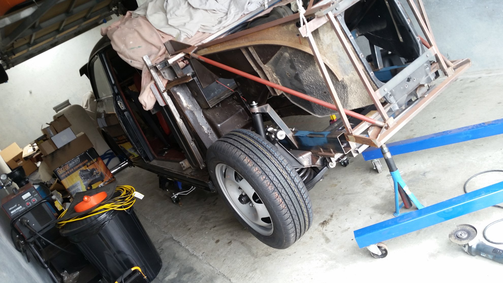

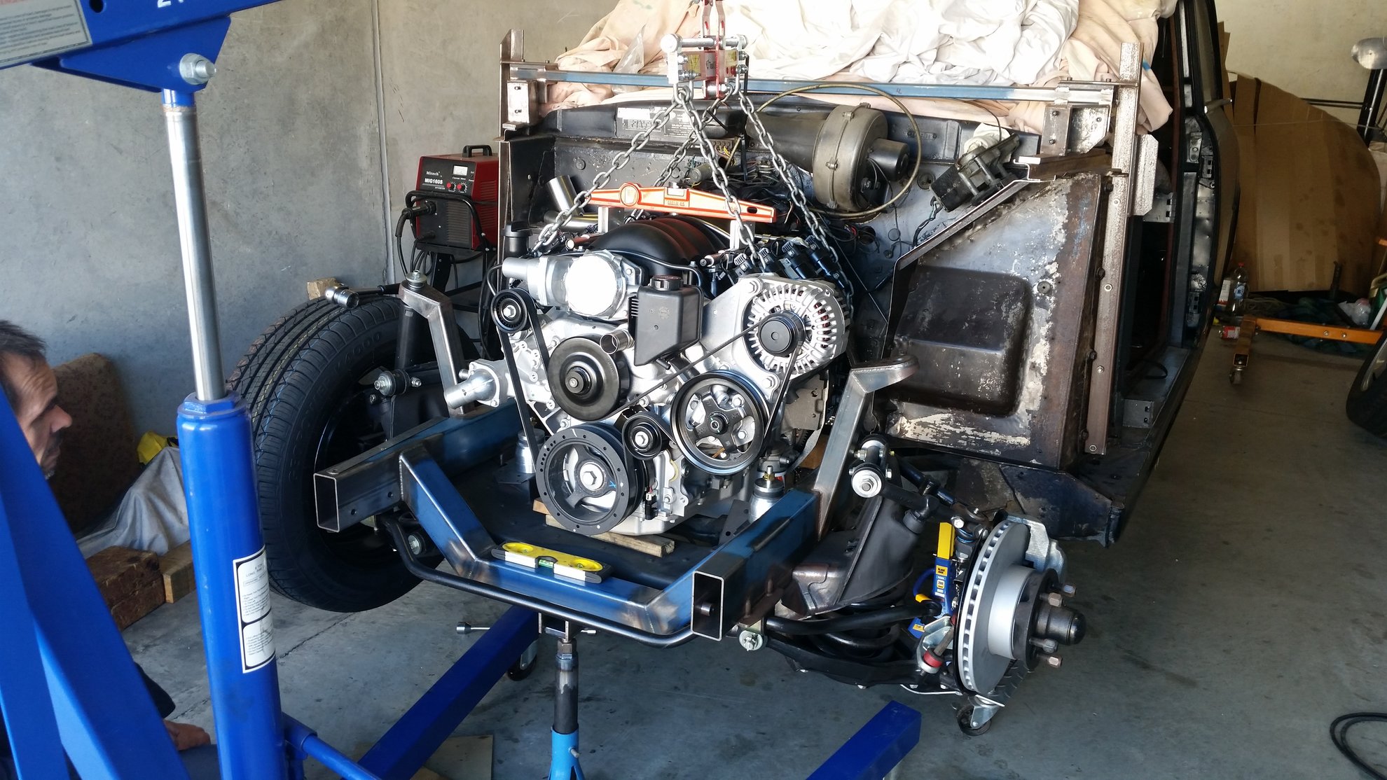

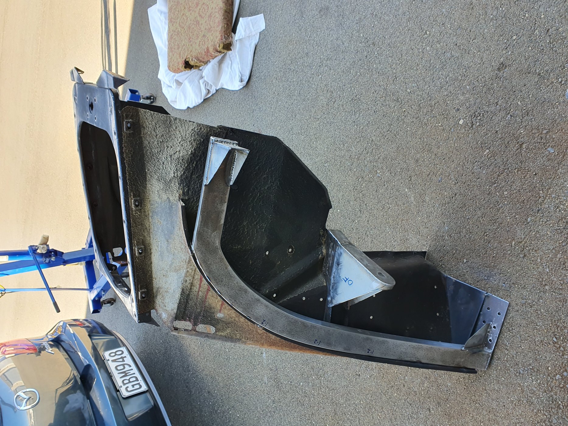

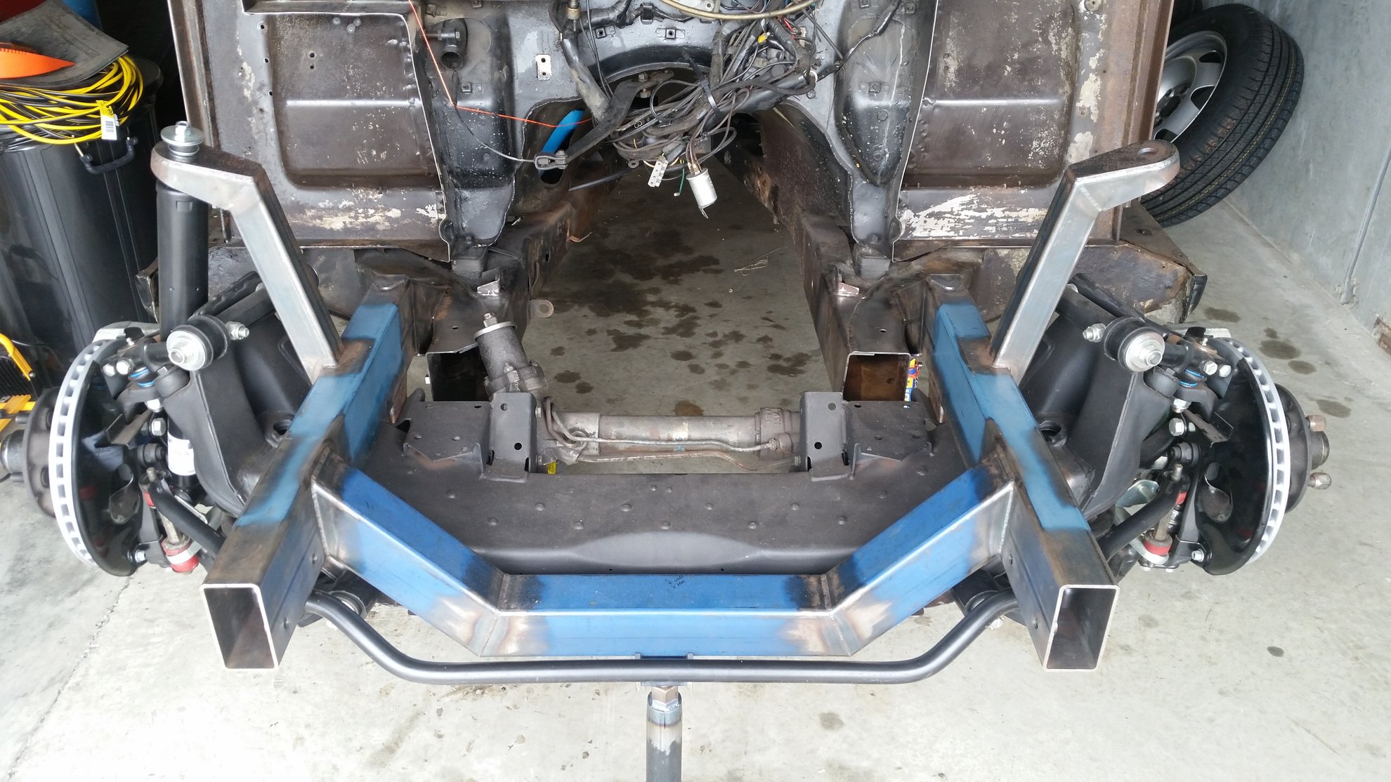

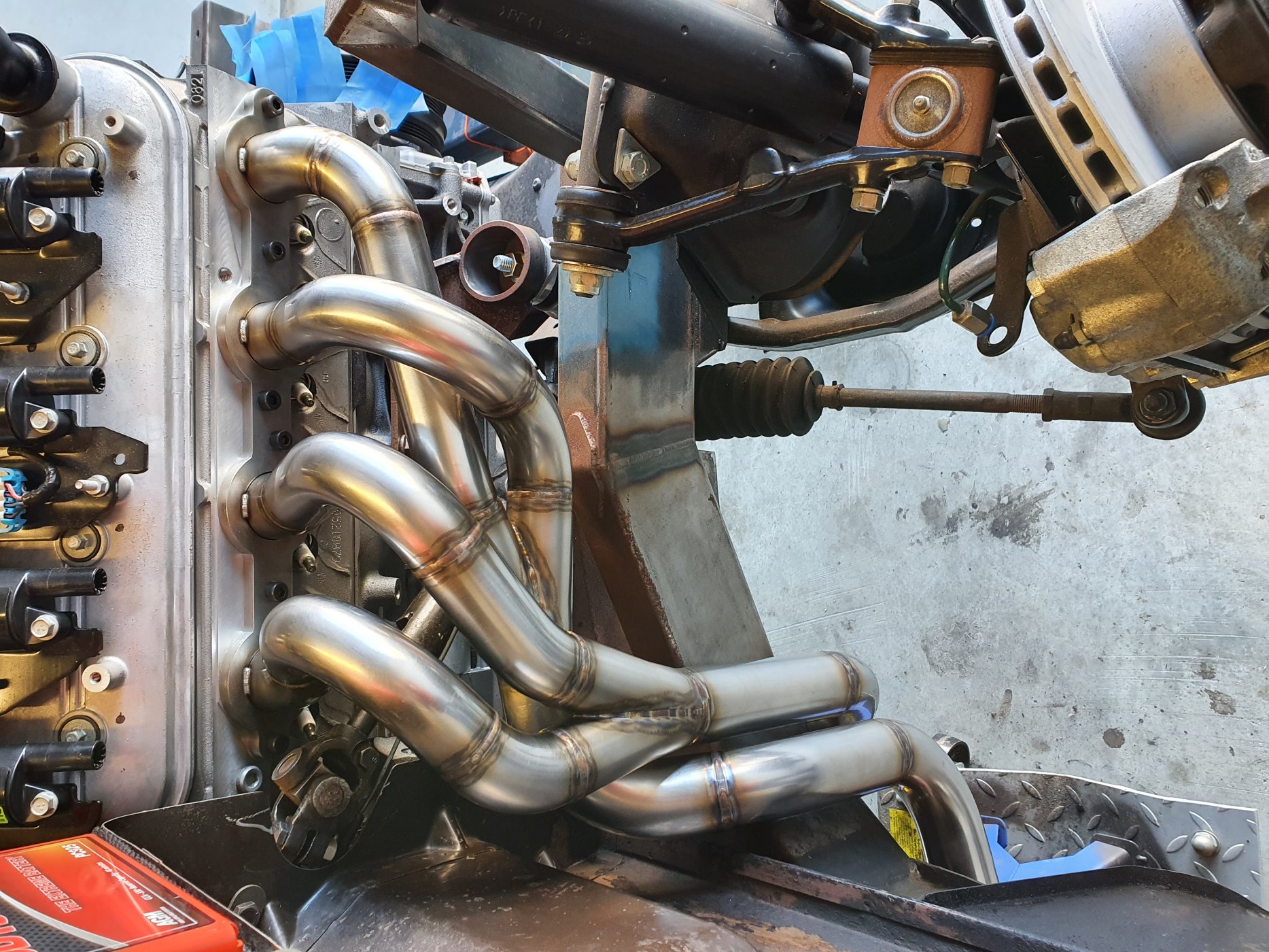

Once in Wellington I offered the complete drivetrain and suspension to the local branch of the Wolseley Car Club if they put a posse together to bone the car out over a weekend. They agreed and were excellent. Here are a few photos of the car after they were done.
