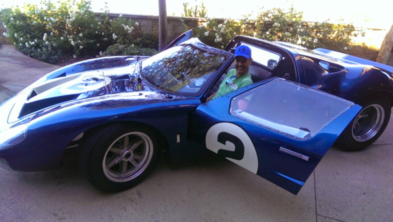

Hi,
I have just purchased a CAV GT40 and still have a large grin!! The car is running very rich. Does anyone have a good contact for adjusting weber carbs in the Bay Area? I suspect it might take me sometime to figure out how to get the carbs correctly set.
Thanks very much,
Karl
