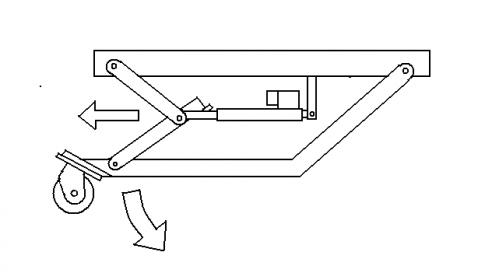

Hi Guys, I found this recently, and a linear actuator seems the way to go, they are not expensive and will easily lift the weight required.

HI Allan, the supplier mentioned was these guys,
1000 lbs Force - Linear Actuators, Linear Motors, Micro motors, Electric Motors or ebay was another choice, the mechanism shown with the retractable wheels only had these details attached ,so i guess it would be easy to make, the direct to lower arm option had a 1000lb LA and the retractable version was suggesting about a 240lb, might have to do the math on that through, hope this from the site helps.

I have dual 6" 800lb actuators on my car for the front lift. They work fine, but do take 4-5 seconds to fully lift, and 4-5 seconds to retract. It doesnt seem like a long time, but it feels like it sometimes.
I have seen several people put front rollers on their cars to keep the spoiler from scraping going up driveways. The problem is, in order for the rollers to be really functional, they need to hang at least 1 1/2" below the spoiler, and as close to the front of the car as possible. Its not hard to mount them like that, but the drawback is seeing those wheels hanging down (even though it just 1.5") from under the spoiler.
I came up with a system to make the wheels retract up into the chassis when not needed, then extend all the way to the ground (instead of 1.5") and lock into place when needed. This system with the rollers (HD castors) is good because it lifts the chassis, and the clearence you get under the spoiler is the same as the ride height of the car normally, meaning the spoiler never even comes close to hitting when going up steep inclines. Its a really trick system, and can be built and installed for well under $100 with the L/A included. I can post drawings if anyone is interested in doing it, its a really affordable alternative to mounting the L/A's to the control arms, and all the mechanics necessary to do it.
Heres the basic principal. As the L/A pushes forward, the lower arm with the wheel goes down into its position. When the L/A has reached full forward, there is a stop on the lower arm of the scissor assembly to keep the 2 arms alligned and straight. At this point, its a staright shot from the wheel to the frame (as far as load is concerned), and all the weight that is lifted is transfered to the chassis.
This is not meant to lift the weight of the car, its meant to lower a pair of castors well below the bottom of the spoiler. There would be 2 of these assemblies, side by side, about 30" appart (or whatever the dimension is between the chassis rails)
The L/A could be 12" 240lb, moving at 60mm/sec. It would be able to move this carriage from full up to full down in about 2.5 seconds, and then down to up in the same time. This system could support 2 tons easily,provided the wheels are rated for that weight.

Very clever and clean... thanks! And thanks for the forum and supplier pointers.
And the writeup makes me think of a little bit of heresy that might work. Thinking about speed bumps: what if one uses an actuator like yours bearing directly on the lower control arms (both ends of the car)? In that mode the car would have a "solid suspension" but as long as you went slowly and the actuators could take the additional dynamic load.... In other words, use the car's wheels as the "casters". This gets rid of the commerical lift system's requirement that you disassemble and modify the spring/shock unit and means that in normal use, as long as the actuator is completely out of the way, the car's suspension is completely original. Being based on $229 actuators is way cheaper. And it works at the rear whereas the caster idea might leave you "high centered" on the speed bump with the rear wheels spinning.
