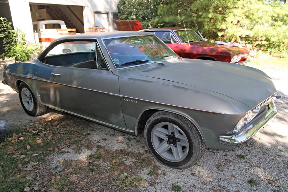

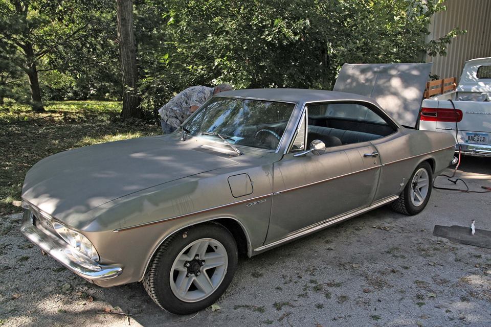

Hello, New to the forum and I'm getting great ideas for my mid0engine V8 Corvair build with a Porsche Boxster S transaxle and Corvette C4 rear suspension. Here's a couple pix before it came back from the bodyshop.

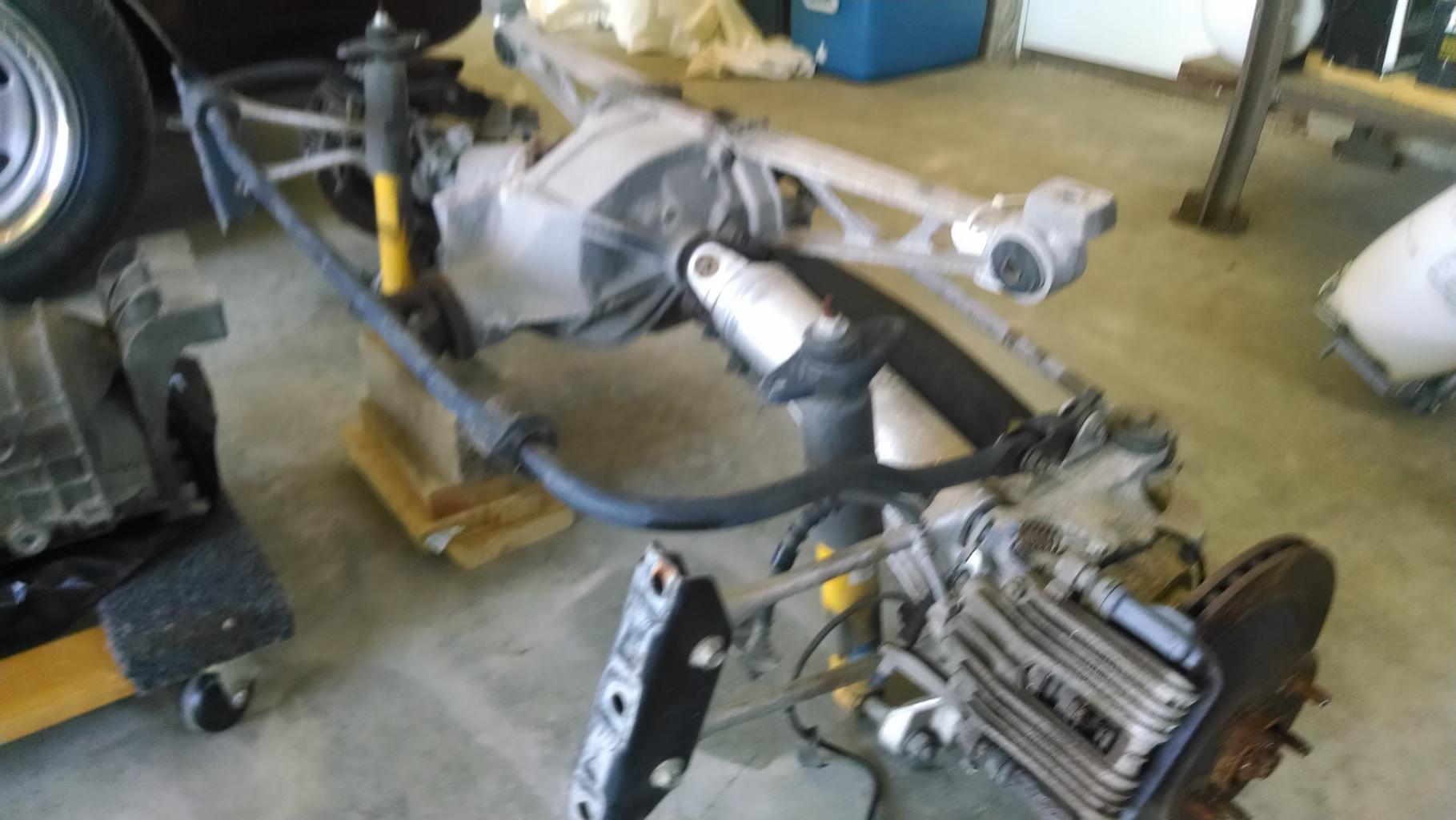

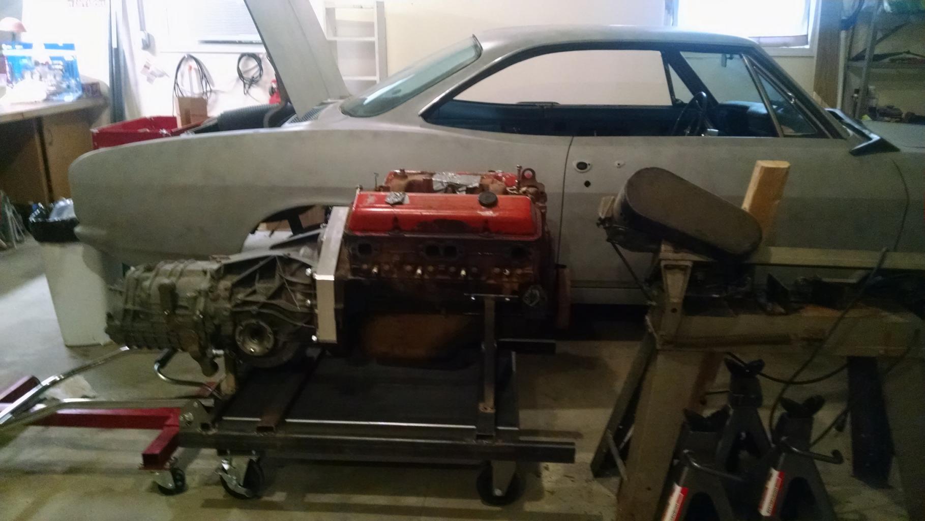

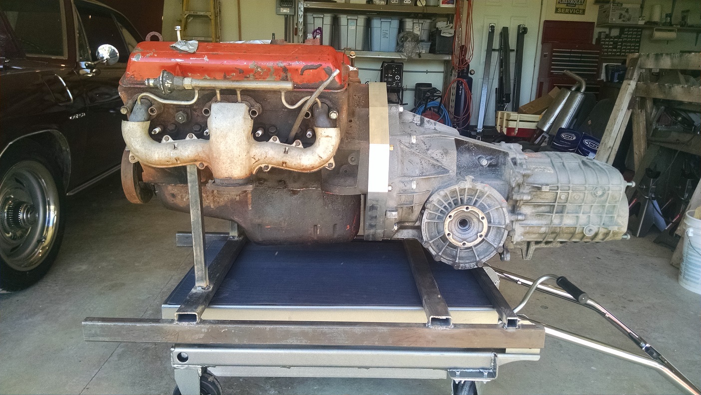

Some small progress has been accomplished. The transaxle is mated to the Corvette engine and a drivetrain cart has been fabricated to ease lifting it in and lowering it out of the car. A pic is included showing approximate positioning in the car, and the C4 rear suspension has been bought and dissected. I'm about ready to start cutting the body after a few more measurements, cleaning off unneeded underbody 'stuff' and final layout design work. Should have it lifted into place and maybe some crossmembers added by Thanksgiving.
