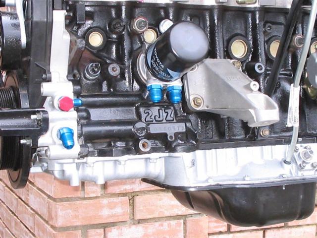

I've been running the Mocal version of that thermostat for nearly 7 years on my 2JZ Supra motor. Works well - no problems. You can see it on the right in this pic, taken in early 2004 just before the motor went in the car.
