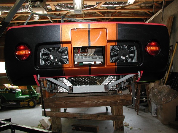

I got all my hoses and AN stuff off Ebay, but got the coolers from Earls(25stack, 10AN) and some 9"Spall units. Probably paid too much by the standards of the earlier post but they are killer looking. The spray bar and sprayers for the trans can be had from Aircraft Spruce. Haven't ordered mine yet. Still designing the mid trans mounts. Will pull the trans apart to lenghten the studs and drill for the sprayers at the same time.
http://www.aircraftspruce.com./menus/ha/fittings.html

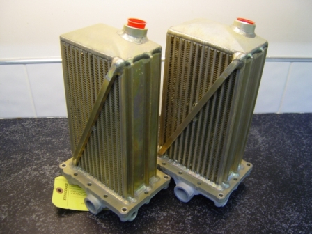

I fully agree with you that nobody should attempt to use a second hand aircraft oil cooler.
I bought three on the cheap from eBay but in my opinion they are useless unless you have them professionally cleaned and tested. The detritus from service is baked into the matrix and this required ultrasonic vibration and a chemical clean to remove (at great cost).
I had this done but did not trust the end results and ended up purchasing two new coolers from Pacific. I received substantial help there from Wayne who modified my coolers in manufacture by inletting nozzles into the tops prior to anodising.
James
