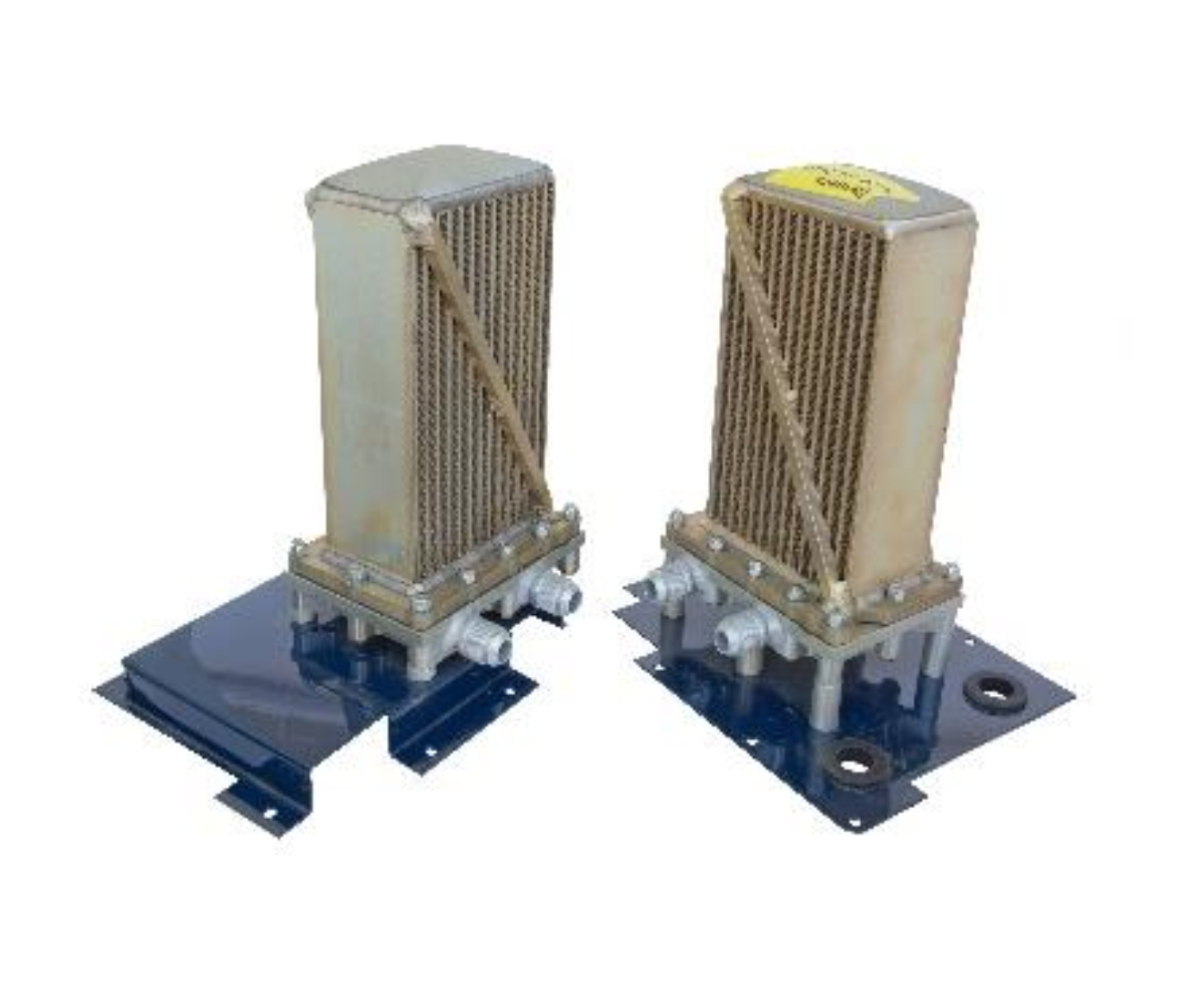

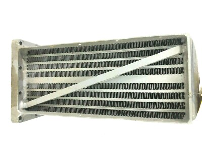

So I’ve managed to find readily available oil cooler reproductions of the originals. P/N 8000683

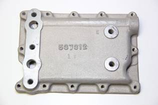

So that part is solved but the hard part now will be finding the bases with the inlet and outlet fittings at the bottom. The original bases I guess were modified to achieve this…? P/N 537312

I have 4 or 5 of these if you need a pattern drawn up. Cessna, Pipers… continental engines used various oilcoolers like these. Search for aero oilcoolers cessna, or harrison continental.

Billet based will have to be bespoke milled and tapped /drilled. Or just weld #10 bungs on original bases and weld up the other holes. Plentiful of these bases on ebay.

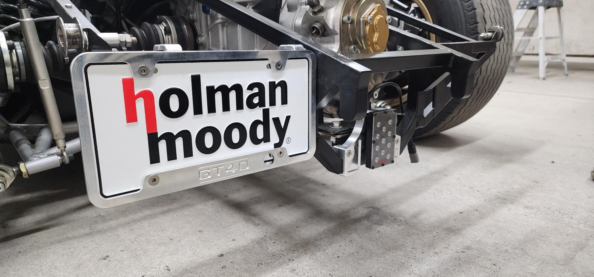

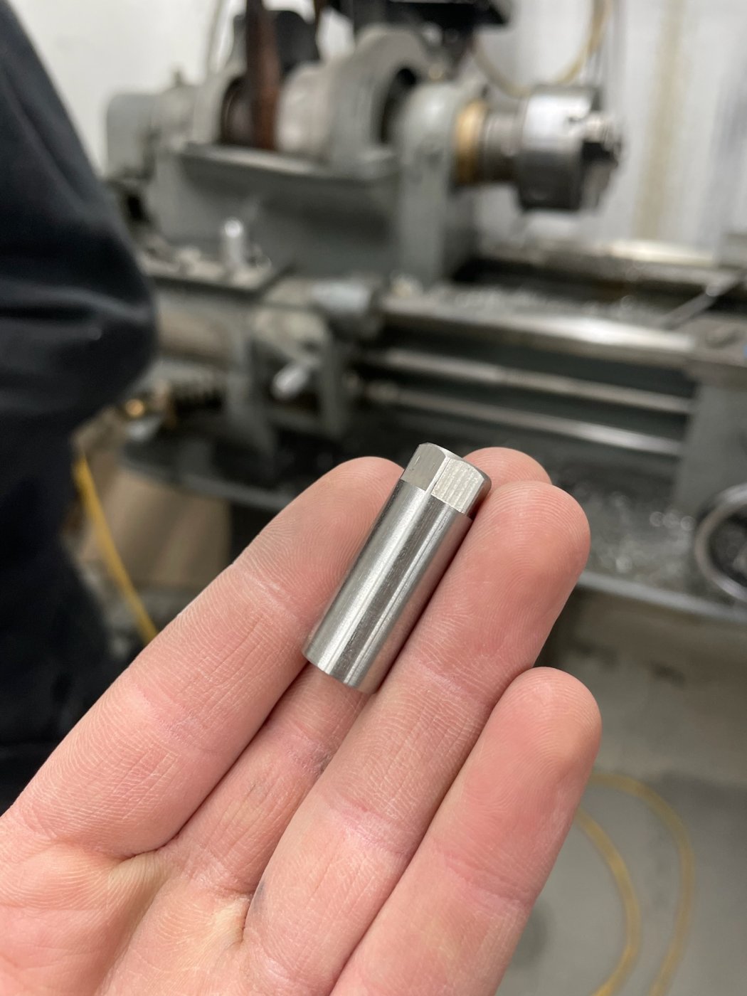

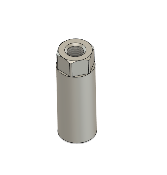

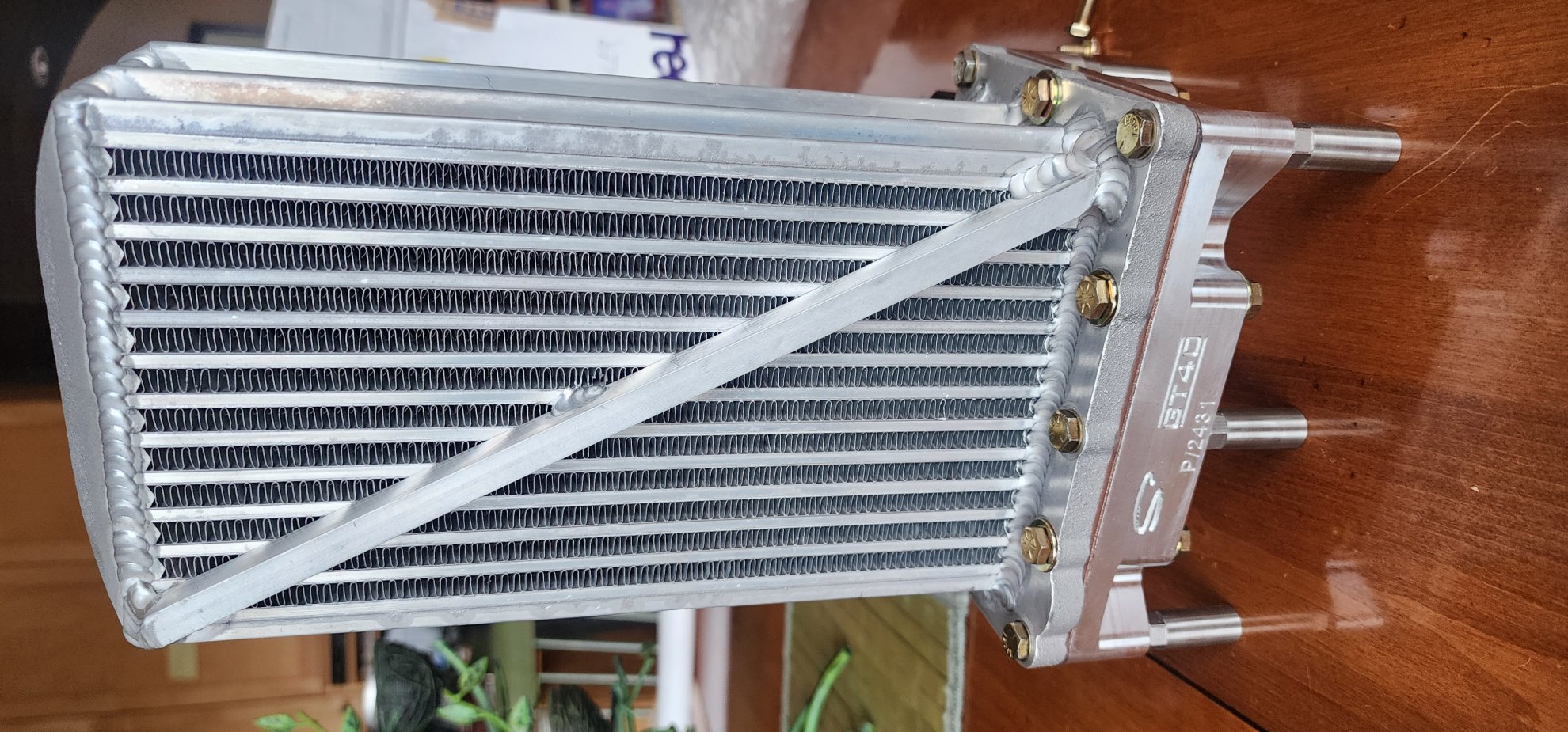

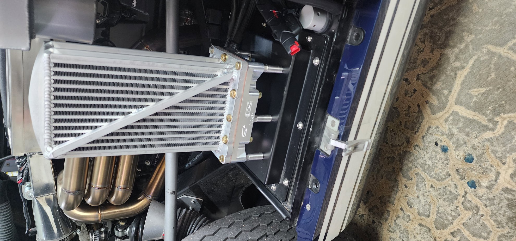

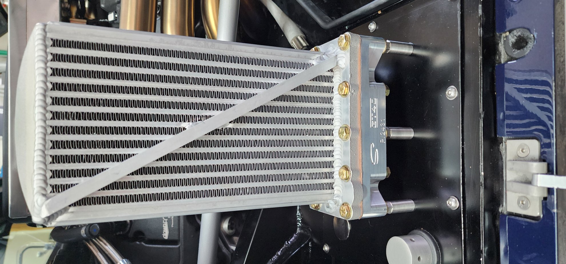

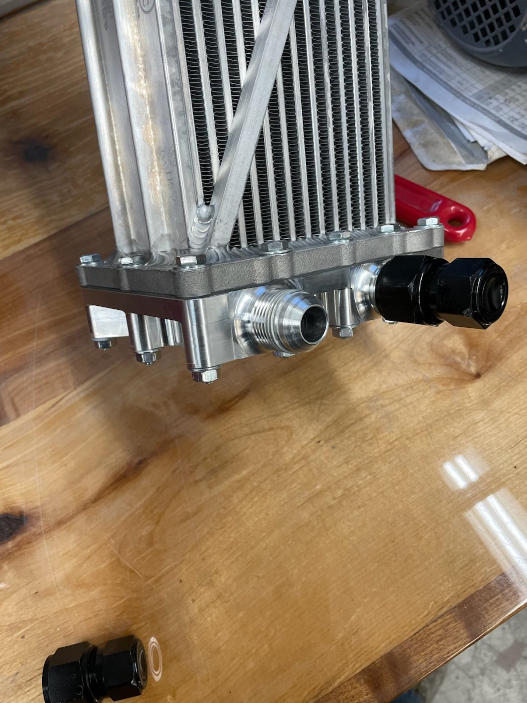

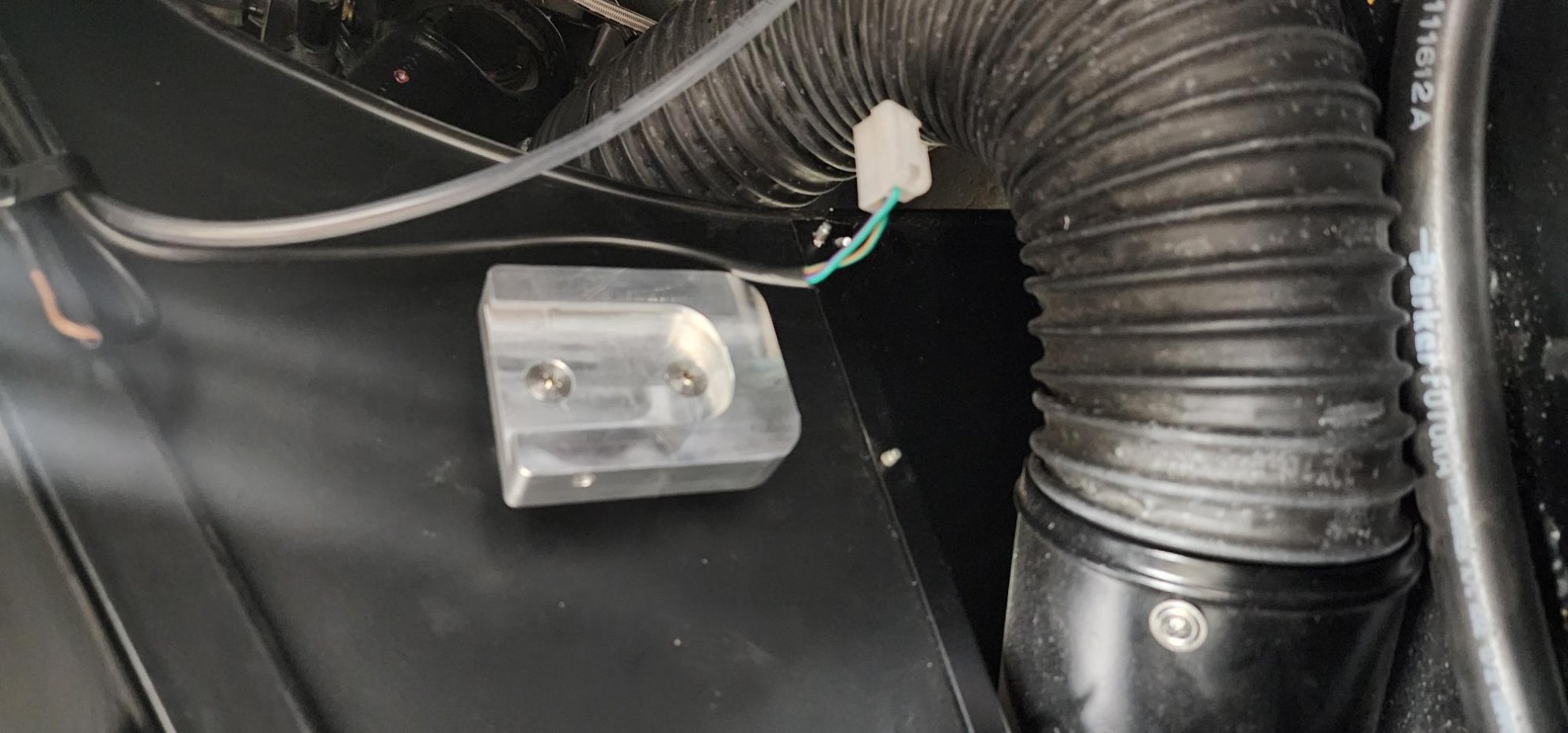

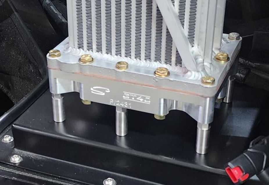

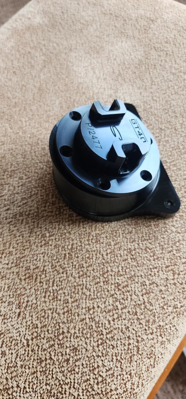

Sure, I had my Einstein fabricator nephews build a few things for me while they prepare #6 to ship to the Reunion in July. Examples - steering wheel holder and many other mods and improvements I have attached here. I had them do the oil cooler bases out of one piece aluminum block stock as the ones the cars come with can hairline crack and seep at the welded on A/N fittings shown in the photo : ( Also, I had them do openings on the blocks at 12A/N so that they would be universal to individual needs as its better to neck/adapt down than up when it comes to flow. I have all 10A/N oil fittings and just use a 12-10A/N Reducer. Feel free to contact Josh directly and can be reached at [email protected]. You will also see that they developed mounting stands that are fastened separately form cooler to mounting area as not to disrupt the torque settings at the cooler when installing or removing the complete unit off the car. for those who have done this they will realize the vale in that design feature,
The best source to buy the oil coolers are in buying directly from Aero Classics. Just call or email Wayne there at 909-596-1630 [email protected] and just mention GT40 and he will be all over it.

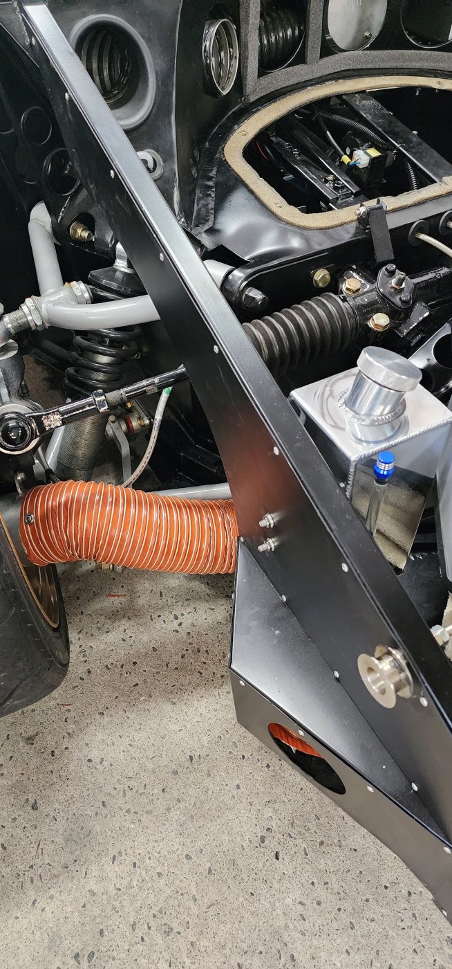

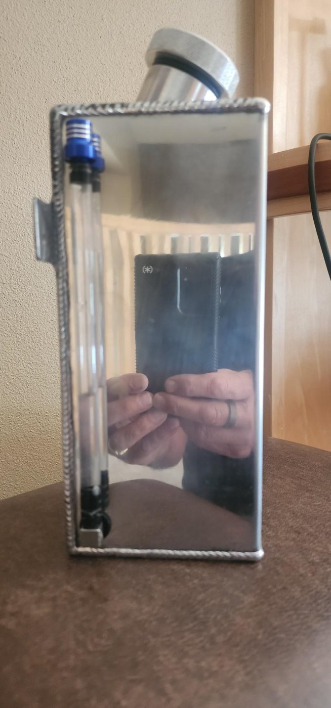

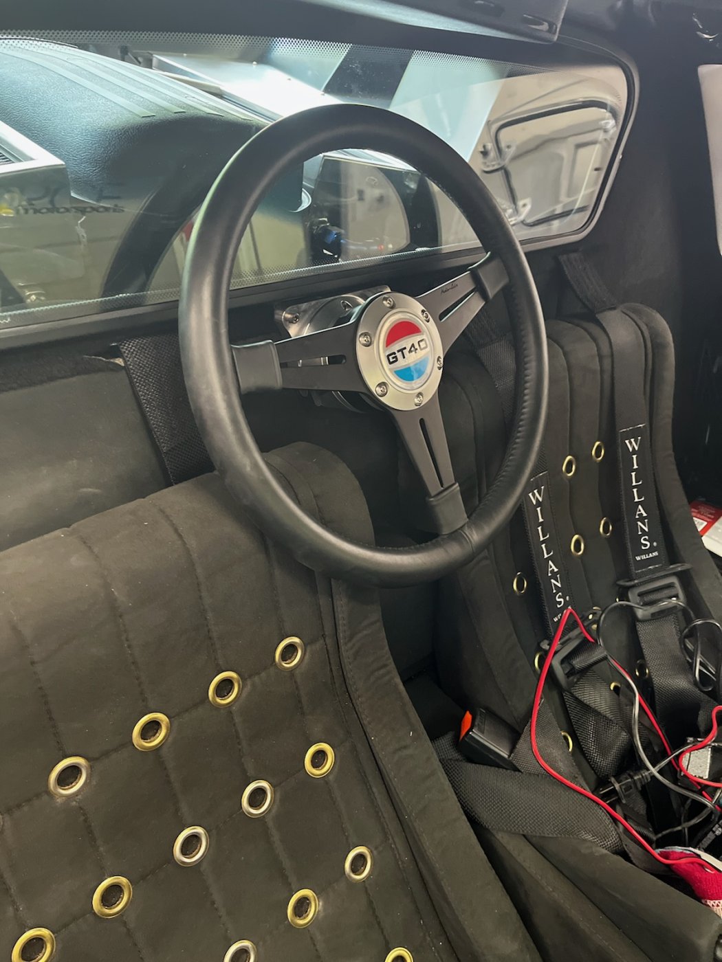

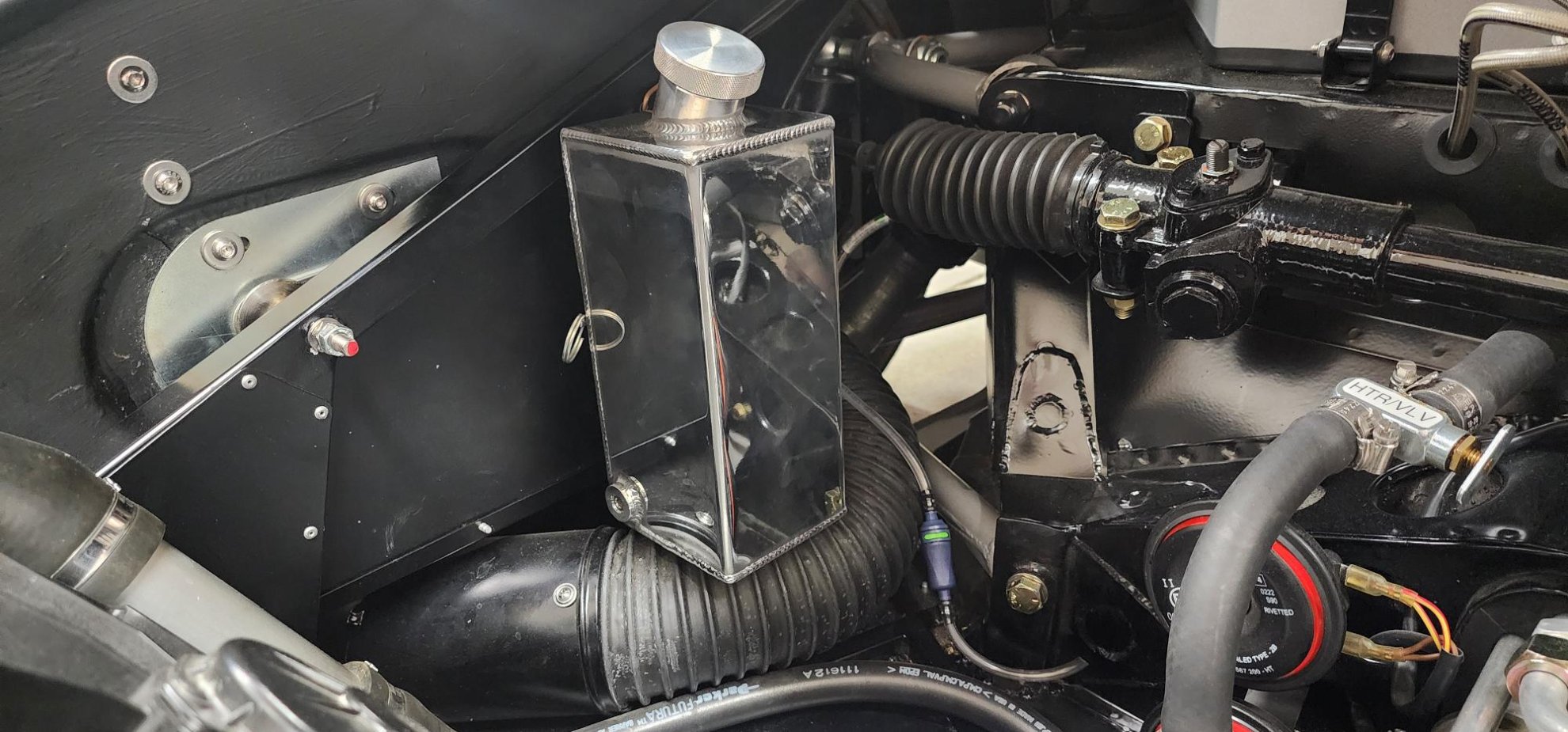

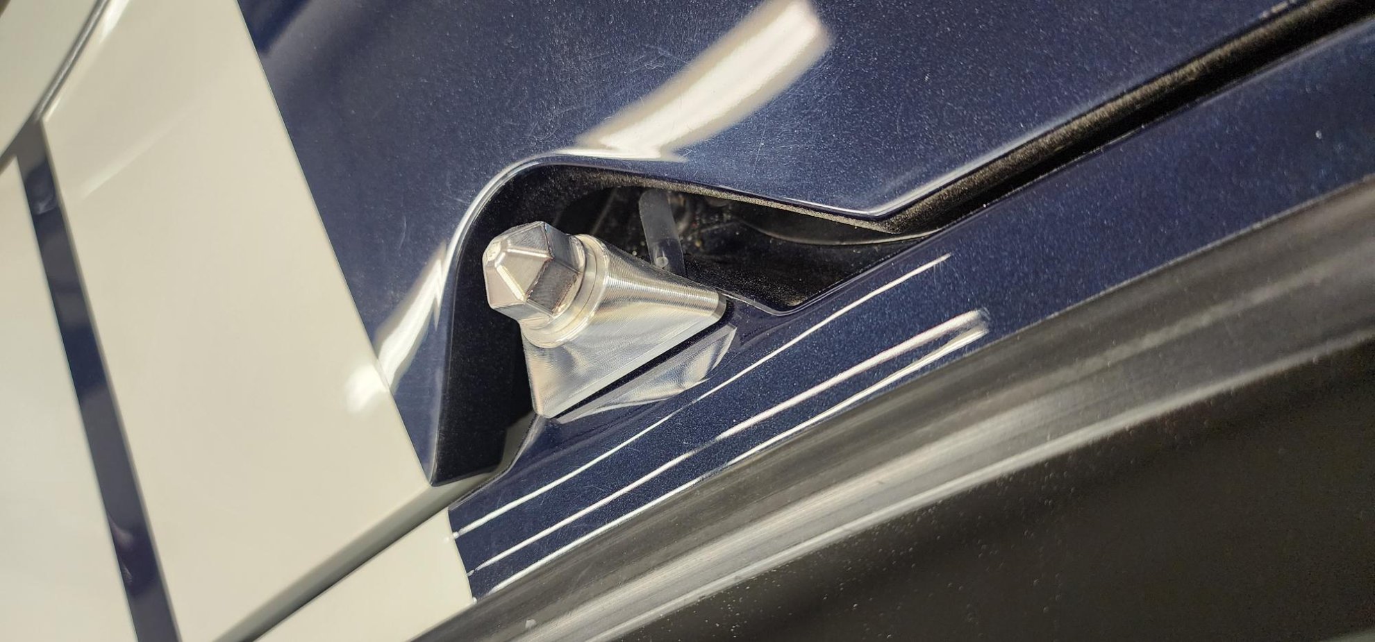

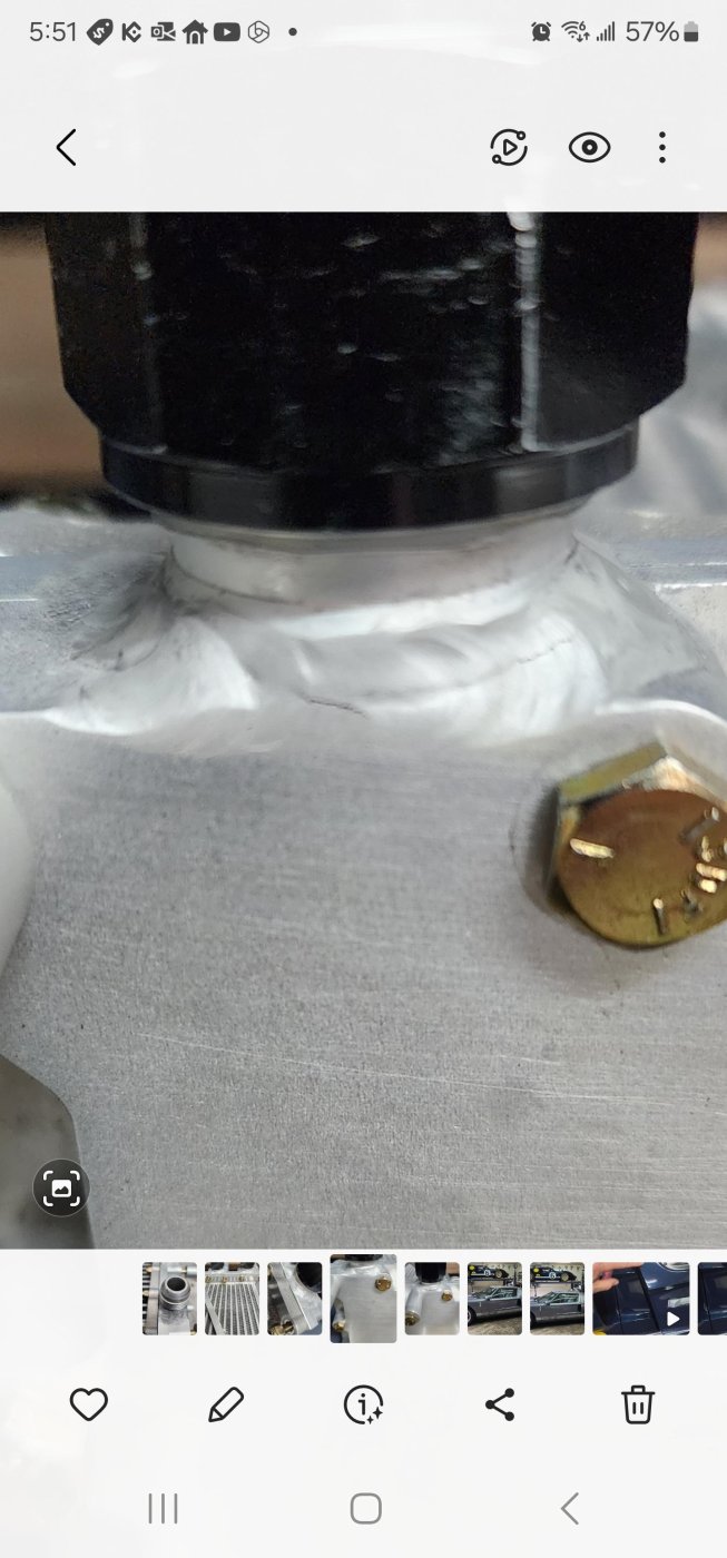

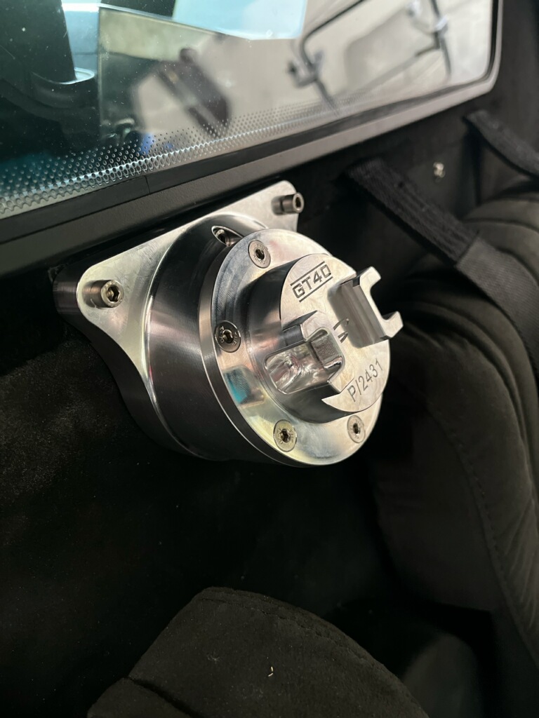

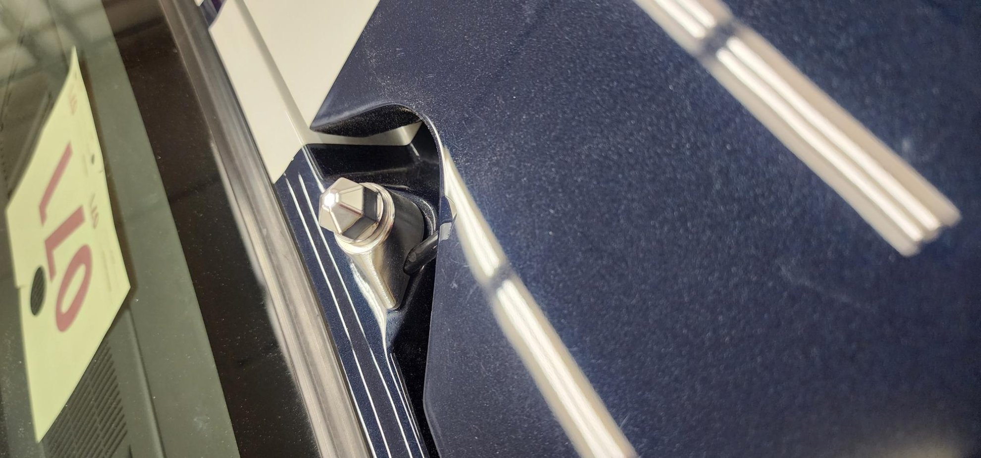

Here is the hairline cracks photo that may occur with welded on A/N bungs to the oil adapter plate which is why having they made as a mono-block part design is best. Also I didn't like having vision disrupted by the windshield wiper and designed a wiper delete and nut that also holds the washer hose from sneaking back down under the front end section. The aluminum washer reservoir has a site glass and uses the original mounting holes with fitted aluminum mount that allows rapid removal of the whole system. The steering wheel holder is shown in black anodized and mounts to the factory bolts that hold the rear cockpit glass to the bulkhead.

Also consider a matching cooler over the battery as a trans cooler even if you just block of the A/N's. It fills the void there nicely and looks very period also. : )
