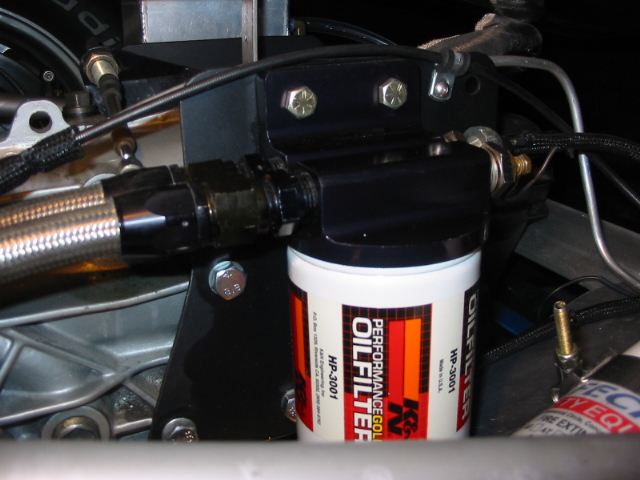

</st1:City><st1:place w:st="on">Canton</st1:place> oil filter bracket. A nicely machined piece. The mating surface for the filter is perfectly smooth. It leaks a bit around the seal between the filter and the mating surface. We have tried cranking it down really tight. At idle there are no leaks. But drive it a few miles and there will an ounce or so of oil on the pan below the filter and oil around the top where it meets the bracket.
<?xml:namespace prefix = o ns = "urn:schemas-microsoft-com
><o:p><FONT face=
</o:p>
Has anyone had a similar experience with this type of filter bracket? When installing the filter a bit of oil was rubbed on the gasket. Wonder if it should instead be cranked on dry.
<o:p></o:p>
Does any one use a removable sealant in this situation?
<o:p></o:p>
It would seem that the oil pressure us forcing oil between the gasket and the filter bracket.
<o:p></o:p>
Current filter is a K and N. Had the same issue with a <st1:City w:st="on"><st1:place w:st="on">Mobile</st1:place></st1:City> I filter.

Think you will find the problem is a very small leak at one of the threaded fittings. You are doing the right thing by installing with a smear of oil on the sealing ring.
Im with Jac . . . whatt sealnt did you use in the threads of the fittings?

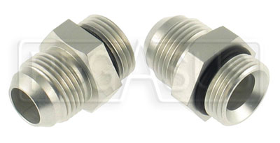

Just thinkingg here .. I dont have the Canton remote filter mount in my shopp bt I'm wondering if you shouldnt be using O-Ring style fittings on the bracket rathr than pipe fittings. THey are really close in size and pitch;
Chuck, if those are pipe threads on the fitting end (going into the filter housing), I'd try using a couple wraps of thread tape. Sealant like "Form-a-gasket" by Permatex will probably also work well too.
What he said. Tried NPT fittings on a Olberg filter and they leaked no matter thread tape or teflon sealant. Got the proper threads with the o-ring AN fittings, leak stopped (From Olberg, $$). The NPT stuff was close to the Olberg body threads but they were not NPT. YMMV.

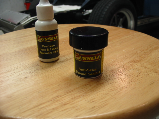

Went out and removed the reinstalled the two sensor fittings. Had not used any sealant on them for fear it would interefere with the electrical ground. This time I used Russell anti seize sealant, which has worked well for me in other locations. Also discovered it does not interfere with the electrical ground.
I usually use teflon tape, but was afraid it would insulate the electrical connection.
Business will take me from cold Illinois to Key West for the next few days, (no sympathy, please) so won't have a chance to run it for a few days. Will let you know if this fix worked.
Thanks for the good advice.
Finally had a chance to fire up the GT. Leak is gone. Thanks for the good suggestions. It must have been a small leak on one of the fittings per Jac Mac's advice.

My guess is you have a fitting leaking. If you want to you can check the "flatness" of the filter mount with a straight edge but I don't think its that. Oil on the filter seal before you twist it on by hand. About a 1/2 to 3/4 turn after snug should do it. Anymore and you risk a split O-ring.

The fittings used are Earl's. Only the sealant was Russels.
And it no longer leaks.
