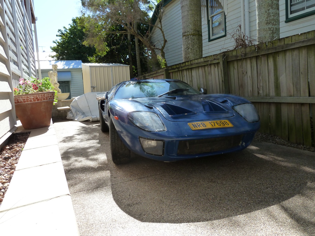

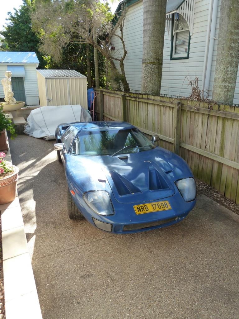

Hey guys/girls, first post for me on this forum.
I come looking for advice. Recently my brother was chatting with a workmate who mentioned he has a gt40 he wants to shift. We are located in Australia but the car was South African built and registered in the 1990's by his workmate who then moved here.

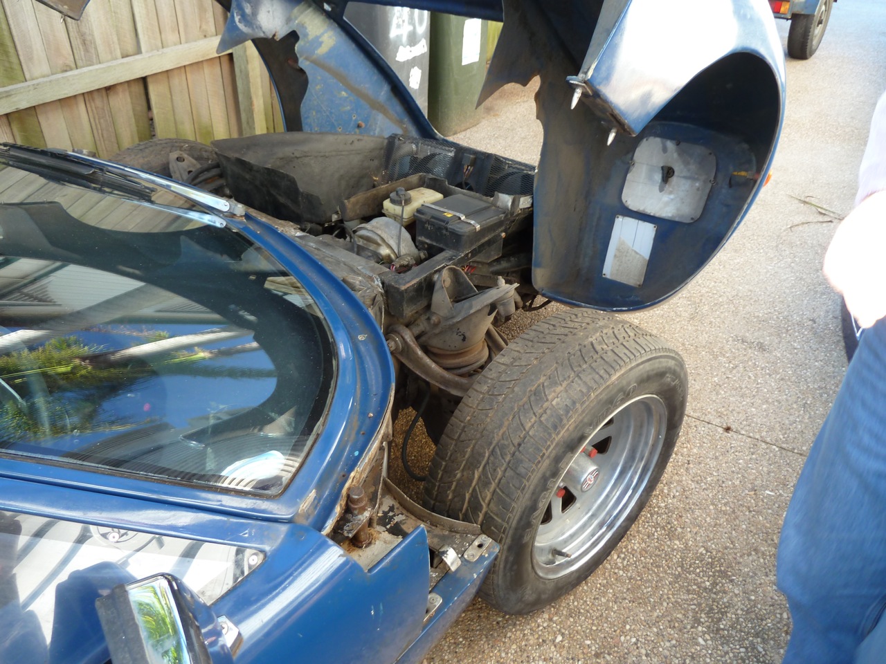

Not sure the kit, looks pretty low tech and older (KCC?), runs cortina front and granada rear suspension. It has been fitted with a 350 chev at some stage with audi box. Runs discs on all corners but overall the chassis does look pretty old in quality.
1. Can anyone shed any light on what kit it might be?
It is a pretty cheap option. The current owner is moving back overseas and wants it to go to a good home after the years of work he put into it building it. He is looking around the $5k AUD (~3000 GBP) mark.
My second question goes to the aussies
2. Any idea for registration options? It has never been registered here but was brought in as a private import which might make things easier. Would hate to the go the ICV route which would probably result in a repower by something newer. Not sure a chassis of this type could ever be registered as an ICV, I suspect the construction wouldn't be up to modern standards.
3. Would something with this suspension setup ever have a hope of handling remotely well? I think eventually we would like modernise it a little bit but that would be a few years down the track.

Tim,
At the sort of dollars you are talking, I would grab it with both hands. The bodywork alone is worth a deal more.
Can I refer you to the Australian Cobras forum, where two recent announcements by the authorities in NSW and Vic will hopefully mean a far less combative path to rego, especially for older builds (I think).
It could be worth checking how much steering lock is available. If an original KVA, I suspect they were dreadful, and could have implications for rego.

Sounds very KVA or a copy of. Talking to the owner / builder he mentioned it was asymmetrical or offsquare which seems to be a KVA trait.
We confirmed that the price will remain at that. The owner is keen for someone to buy it who will put it back on the road and not part it out. He reckons he put a lot of work into it and would be happy to see it back to 'its former glory'.
On the registration path we have had some progress.
It was imported into the country as a personal import and still has full paper work. For registration in qld it will need an LO3 modification plate which covers things such as belts, glass, neck restraints, lights, mirrors and general workmanship. Australian standards for glass may be an issue but I think Aussie sourced glass may be the best solution.
After that its a case of getting the import plate, a roadworthy certificate and registration.

Tim.
It looks like a KVA base to me. The semi-trailing arms can give similar geometry to an earlier 911 (may not be angled correctly, but CAN be OK) so handling can be quite good if you limit the body roll with appropriate anti-roll bars, and I don't know how good the front geometry is. Correct springs and dampers are required, of course.
I assume you want to register and drive this on the road (too low tech for racing), and it could be a really fun car. But please be very clear on rego requiremets. By the time you source correct seatbelts, lights, glass, mirrors, etc. it could really be troublesome. On workmanship, some authorities require photos proving safe installation of wiring in concealed spaces (eg centre tunnels), so be very cautious. Good luck.

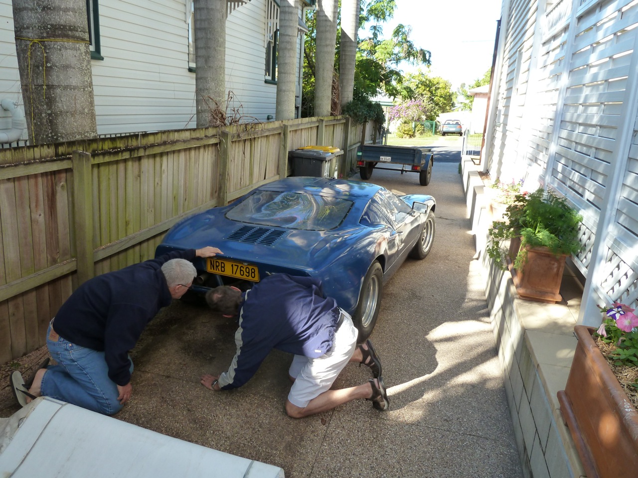

It certainly looks like a Kit Car Center (KCC) car.
They were based just outside Johannesberg in the Mid / late 1980's (next door to Pick and Pay in Benoni. Back then they offered a kit for R25000.
I spent a long time one Saturday morning in their shop drooling over their demonstrator.
And yes the KCC car was based on the KVA early type (not Type C) and a lot of the cars were made with 3 litre V6 engines and VW Transaxles. They used Granada suspension and from memory Cortina subframe on the front end.
There are a few people on this forum that have KCC cars - some modified to twin trailing arms and correct fron suspension. -I believe Southern GT over here does a modification set to chop off the front and rear ends and weld on their bits to make the suspension more like the originals (don't quote me on that but worth an e mail)

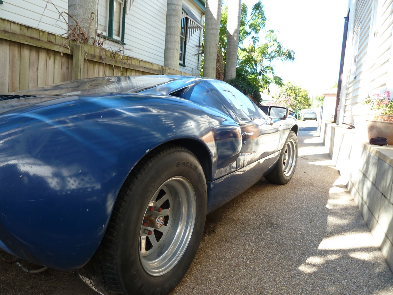

This replica is definiteley a KCC or a later Gt-D
Exactly like mine.
Suspension works well, ive modified mines with polyurethanbushes.
Brakes are a little to small on the track, on street use the work well.
( Racing for fun)
The weigth is high, 1133 Kgs with me inside. A lot of steel welded.
This price is ok! I paid a lot more for mine, it was registered in Switzerland.

Got the import approval papers today. Built 1996, imported 2001. Had a talk to a compliance / import company and things are for the best part looking ok.
Car is at home in the garage now.
