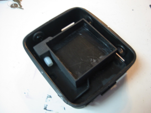

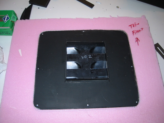

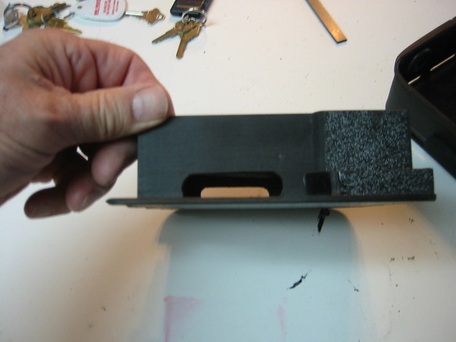

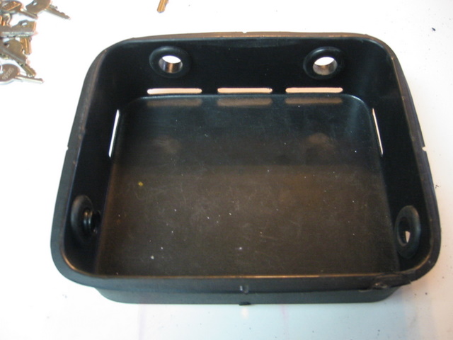

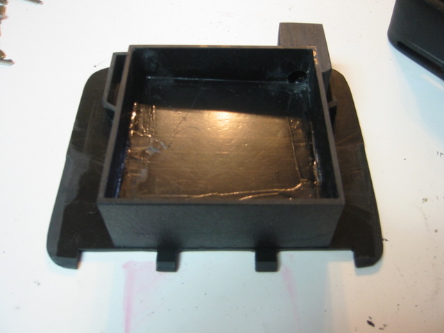

Rather than post a couple hundred pictures at once and boar you more than I already have I’ll start by posting details of the latest roof vent design in the “How To” section assuming I can still do that. Needless to say there is much more and I hope others will post their finding and fixes as well.
I think we all agree that the door seal or the lack there of is perhaps the largest single issue and recall hearing that Frank Cat had new and improved ones but that needs to be fixed by someone other than me. What I can help with is the problems I found with the front suspension mounts, almost every seam in the car, drainage of the cowl area under the window (drips onto the feet and ankles, sound familiar), control of the water coming off the roof and currently onto the top of the rear sponsons. So at this point since everyone is asleep or stopped reading a long time ago I’ll leave the rest for later.
I'll leave you with a few pictures of my new and improved roof vent. Don't ask me I only made the thing that other guy in my head designed it. ABS is great material to work with.

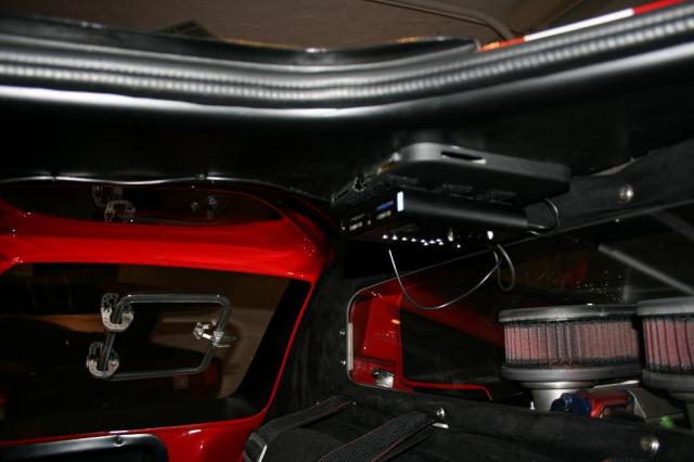

Richard I closed off the vents by using that dynamat and that little tub area holds one of the on board cameras in the car and also the mic. I also brought power up between the metal roof skins so its all pretty self contained and stealth. Good place for a interior light too.
Jack, figures you would be the first to answer. Ya the holes on the front and sides are for camera wiring and one for the drain tube. Did you close off the louvers on the top? How about some pictures, I'll show you mine if...... well let's not go there.

Grady, what roof vent fix did you do? Any pictures?
Jack great idea on the inside light, oh I know I'll use those map lights I took out of my 67 Mustangs overhead console, or maybe not. Anyway you must own a camera I'd like to see how you did your roof vent.

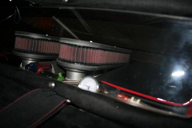

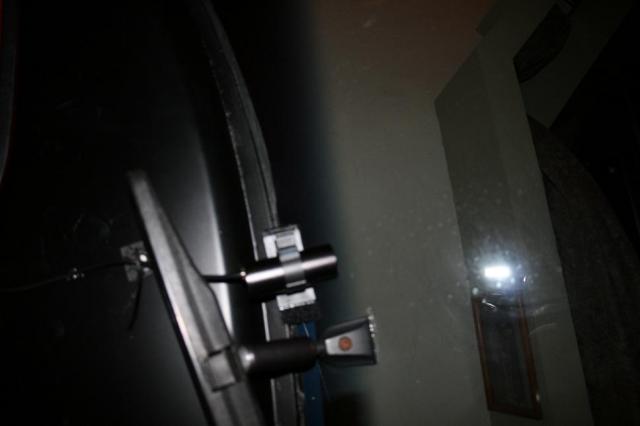

Mike is correct about the noise, the door eyebrows do make a lot of noise. Richard here are the pictures, the wires are not tucked away, got it installed the night before RA and parked it when I got home. Camera #2 is the second picture Also here is an idea I used, its a manual fuel pressure gauge you can see from the rear view mirror. Backwards of course but still you can see if you got pressure or not. The electronic gear hanging down is a dual channel DVR. I don't recommend it, seems the frame rate is so slow for good video. Oh no drain tube the vents are sealed off with the dynomate, its the stickyest crap I ever used.
