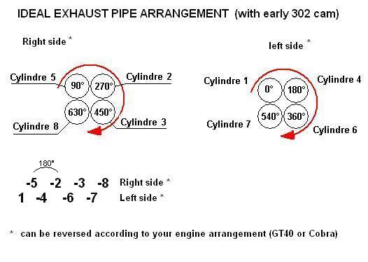

Sorry, I didn't describe my problem very well I think..
By 180° tri y I meant that for a usual firing order of e.g.13726548 you can pair
23 primary collector
with in secondary collector
58 primary collector
and
14 primary collector
67 primary collector,
which would give 180°/720° in the primary collectors but in primary AND secondary it would give 180/180/180/180. Sorry if I gave it the wrong name.
Can anybody of you tell if that will change the engines noise (I presume it does, as Russ wrote above)?
thx

Let me get this straight, are you saying you are going to merge the secondaries for 2/3 and 5/8 into the one collector? And 1/4 and 6/7 into the other? That's an interesting setup!
Is the idea to merge the secondaries across the back of the motor as with a normal GT40 crossover system but of course needing to find space for only four pipes not eight?
Should work OK, will be slightly better than a tri-y setup where they are kept bank for bank, may even build a bit more mid range torque on street application. Wont sound quite as even as 180° 4 into 1. Has been used before in circle track application with 180° type where rather than connect the 4 pipes into each collector as one they split thru two merge collectors before combining into each tailpipe- this was done to try and build some mid-range power and used as a tuning tool for different tracks. Have also seen setups where they run 4 tailpipes, this has a very distinctive ' multiple Harley type ' sound.

Right, Russ, that would be the benefit of this layout - you woudn't have to go straight cross the induction system or something else like that and you would save a lot of space in the rear. But I think the pictures of the headers of Mike Trusty in this thread at page 1 are absoluteley the same thing I am talking about.
Russ Noble
Duh.. Old timers disease! I'd forgotten about the pipes in that photo. Only a year ago too!
Keith that is the same as the Schematic ( Colour coded ) I posted of Adam C's. These are for 180° 'normal ' GT40 etc.

need to resurect this older thread, because i checked on my exhaust system in regard to my firing order and got confused.
Again
attachment.php
attachment.php
Your answer was based on the two pics above. By checking again i think although it is the correct pairing in both colletctors and the right side also has the correct rotation order, the left side is not following the recommanded rotation order. Adams system is like this
6--1
7--4
This way it is "ZETTING" instead of rotating.
So either 1 or 4 need to exchange incoming positions in the collector or 6 and 7 to achieve also the correct rotation order.
Or is there any other reason why it is built that way ?
Thanks for your help
TOM
Your right Tom, we will have to give Adam a nudge :), although there might be a good physical reason given the primary pipe size of the 427 motors, or perhaps they did not have as much time to think about it as we do now:) Adam recently sold a set of those via ebay, or did Fran buy them?
