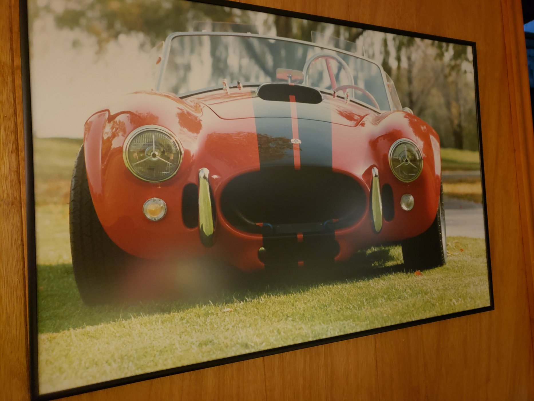

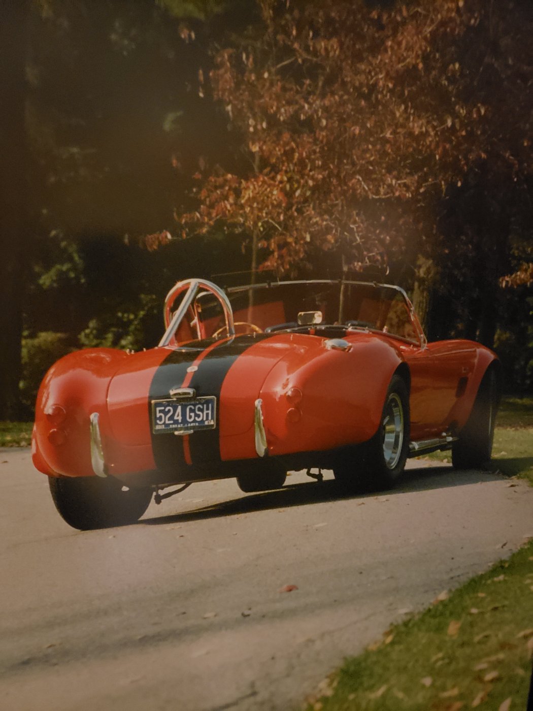

Hi Rick, you brought me way back to my youth by mentioning Ford Motor Company's Answer Man, John Vermeersch. I met John in the early 80's when I built my ERA 427 Cobra (#076). John's shop, Total Performance, was a frequent stop for me to see what hardware was there on any given day. Frequently I could see Bob Glidden's Pro Stocker, GT40s (my fav's) or just soak up some of John's vast knowledge. He could quote numerous part numbers off the top of his head and his advice helped me build the 427 FE motor with a big input/big output Top Loader 4sp. trans for my Cobra. As mentioned, John's shop, Total Performance on Groesbeck Hwy. was a great place to visit. John always made himself available to Ford fans such as myself. I had my Cobra entered in the SAAC 11 car show in 1988 (took 1'st place in my Replica Cobra class) when my car suffered some "minor" front end damage, I was devastated. John Vermeersch had to remain at the show so he gave me the keys to his shop, along with the alarm code so I could get his car trailer to take my Cobra home. This is the magnificent person he was, I feel very fortunate to call him my friend! Eventually I took my car back to ERA in New Britain, CT, and Peter interrupted production to have his body shop repair the damage. I took it back to Detroit for painting and a happy ending. Here is a photo of John Vermeersch, just as I remember him. Also a couple poor quality shots of my Cobra photographed on the Ford Estate (getting on that location for some quick photos is another story) as well as the award plaque from the show.
