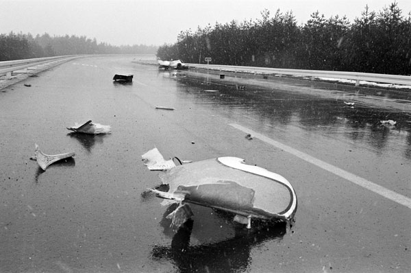

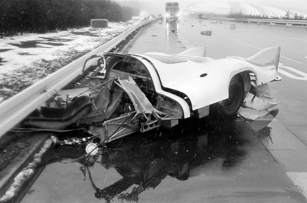

Just to help on your excellent demonstration and advises these are some pics
very very significant !! isn't ???
And also some information about modern LMP cars ; tank is in beetwen the engine and driver seat but this fully homologated rubber tank is inside the carbon fiber monocoque , that means there is behind driver a thick wall of carbon fiber plus 25mm honeycomb and again carbon fiber , then the reservoir then another thick wall of similar composite ( 29 mm thick in total )
On those cars engines are directlly bolted to that firewall thru hudges aluminium or titanium insert both side and these drives any compression due to a frontal choc and coming from the inertia of the engine
Special test on a FIA homologated jig is done to check all this area as well as pusching test on top of rollbars taht are fitted just top of that fuel tank .
What we are building are replicas for hobby and we all know that sport car hobby is something "risky" so beside the fact am always as Graham thinking about safety ( chocks or fire) we will always have in the cars we built a small part of risk we cannot manage ( Rain , breaking of a hose or mecanical bit)
All 917 's manufacturers have tried to avoid or minise this risk with different solutions and this is something intersting to analyse as each solution have positives points ;bravo to them
Just reminding what happened recently to one of our super nice German member a Gt40 is perhaps safer but life is life ... A 917 project just add more risk but depends how carefull the owner can be with his own life and the one of passenger in case of track day parad or watever.
