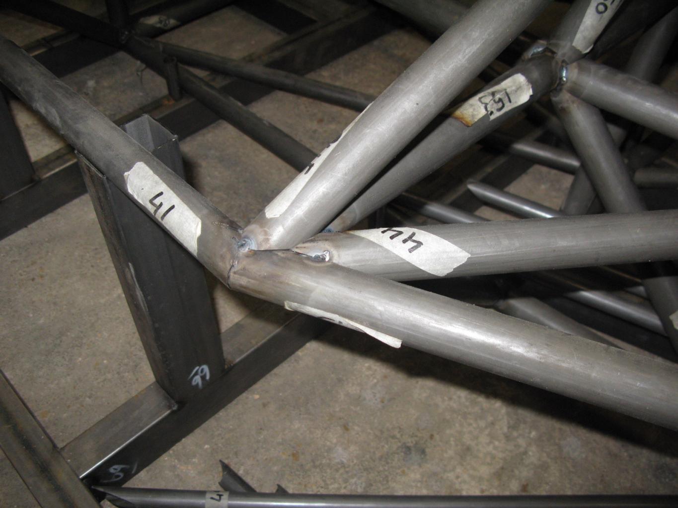

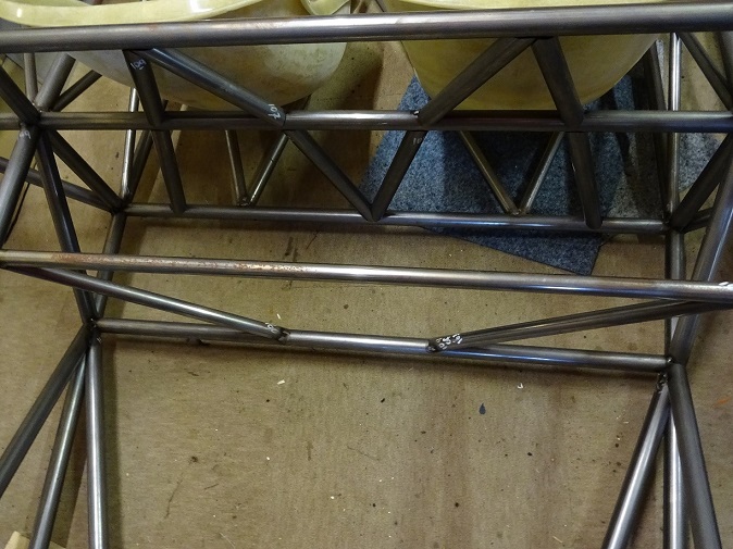

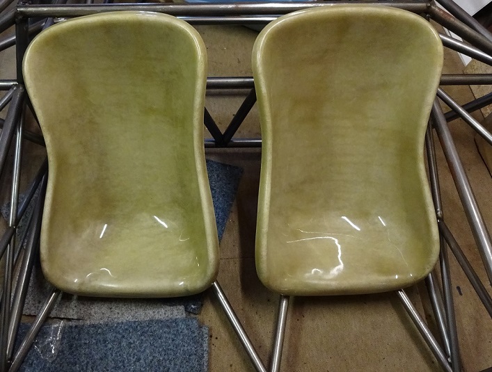

A big difference between the other 917's and the one Chris (MrNoo) and I ( Faroux Sports Cars) are building is that we have room for 2 seats.
Howard mentioned that he didn't want to drive alone.
We made the side pods a little smaller, so the is more room in the interior.
Here is a picture of our seats in the chassis.
A we use the Boxster or 911 engine we have plenty of room where a 12 cylinder ones was.
We decided not to put the fuel tanks in the sills as the originals have, but behind the rear bulkhead.
We put in some extra tubes to separate the engine from the fuel tank.
This gives extra strength to the chassis, but also protects the fuel tank.
You can decide which material (aluminium, carbon/honeycomb) you want to use to make a separation.
Our chassis is made using only round laser cut tubes.
Chris TIG welded his chassis, normally we use MIG.

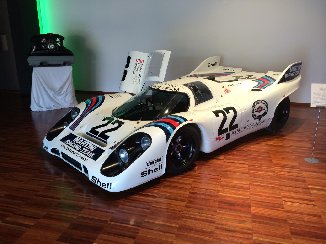

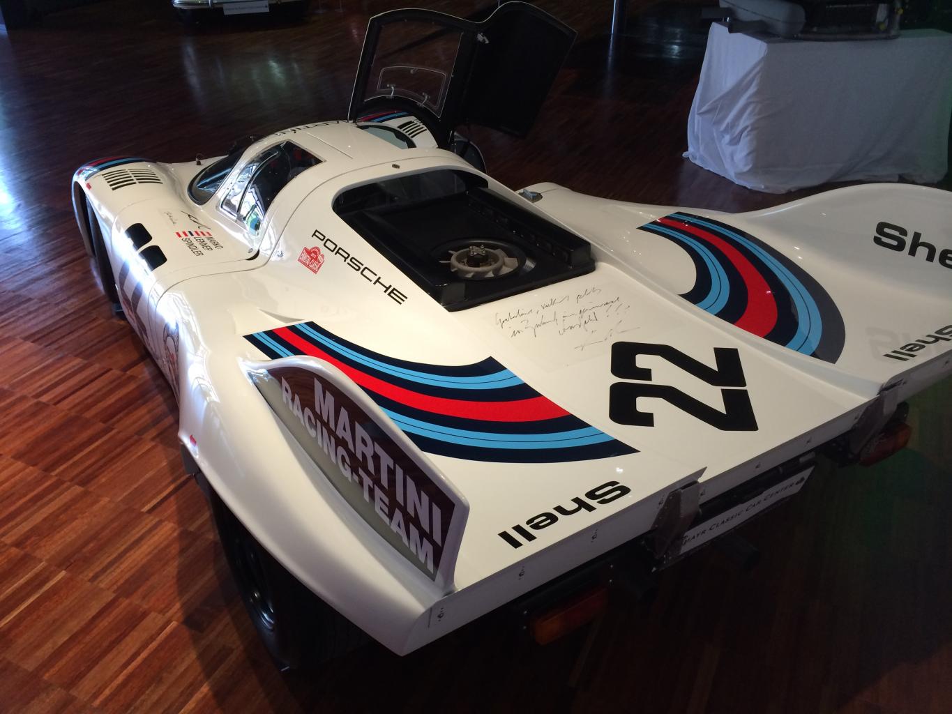

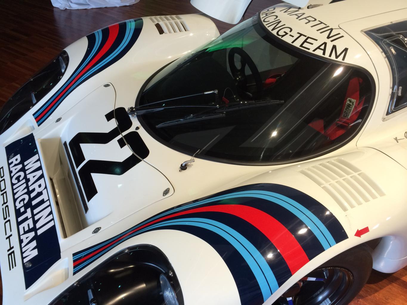

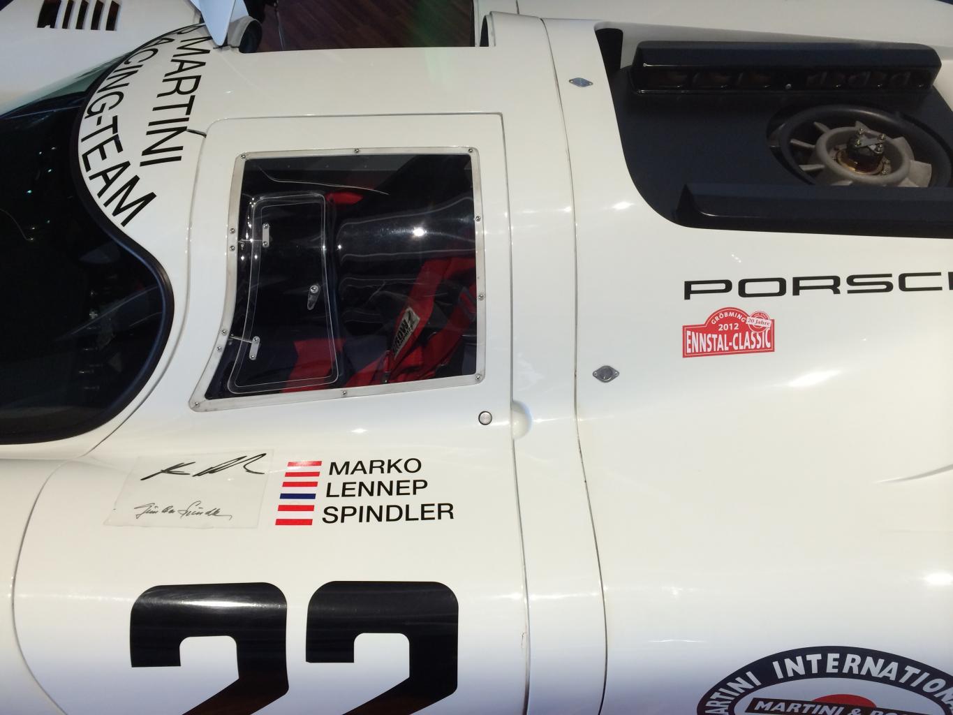

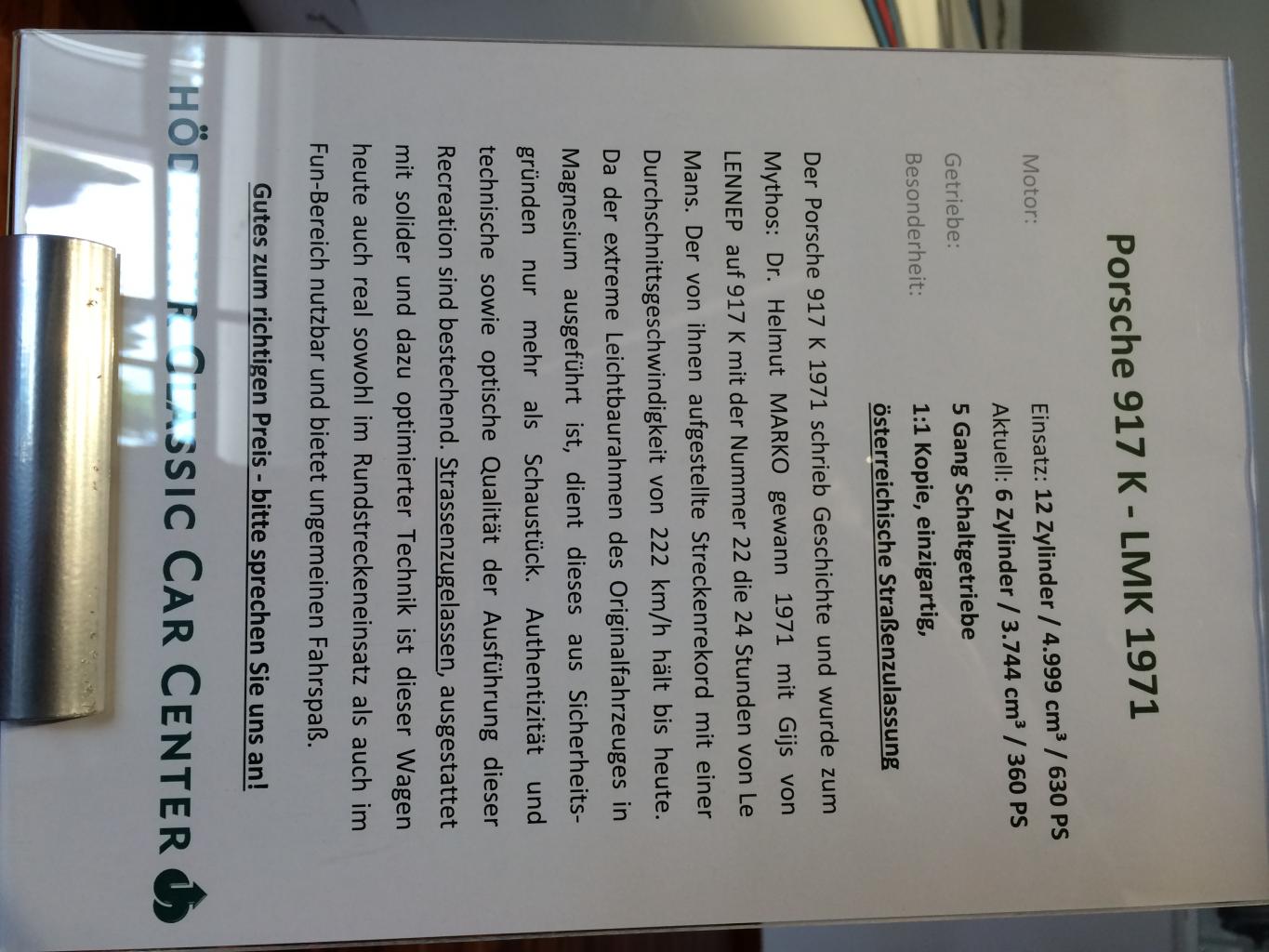

Just came across this very interesting thread and thought you might be interested to hear that there is a very nice P917K-LMK1971 for sale in Austria. It stood right next to my CAV GT40 which I bought there this June.
It is an authentic replica of the 1971 Le Mans winner, car no 22 with the Austrian Driver Helmut Marko and Gijs von Lennep.
I could post some nice pics I took with my iPhone when picking up my GT40 if you are interested. I can also put you into contact with the seller.
It even has a road licence for legal road use in Austria which is a unique exeption. Don't know the price though but I am sure I can find out.
Here you go with a link to the dealer's Website - unfortunately there is only one photo (while there were 78 for my GT40 when it was up for sale (in fact it's still there but marked sold ;-)
http://www.classiccarcenter.at/aktuell-im-angebot/personenkraftwagen/porsche-917-k-lmk-1971/
Thomas
Here you go with the pics I mentioned above

Is it Ottokar Jacobs 917 ?
Good guess but no, it's not.
But I can tell you (and Trevor in particular) that it's a Kraftwerkz replica at its best. It has an air-cooled 3,8 l 911 engine and 5 speed 911 transmission.
WerkzCars "Manufacturer of the Porsche 906 and Kraftwerkz LMK 917 replica"
I have a 8 pages article of this very car where the original price is quoted with roughly EUR 180k but unfortunately it's only in German. The owner has a lot of other Porsches (all the others being originals) and I am sure the sale is not about money same as it has been the case with the GT40 I bought just recently which allowed me to negotiate quite some discount from the original price also because it's just such a narrow market. On the other hand, and similar to my GT40 this 917 is registered for road use which I am afraid will not work in the future so this makes such cars the last opportunity for potential sellers (I originally wanted to have my own CAV GT built but no more chance to get it registered and the one I bought was the only registered one for sale for years)
Trevor, as discussed via PM I will try to get more facts and a contact for you on Monday.
Thomas

The 180k were mentioned in the magazine coverage and I guess this was the original price to get it built by the first owner (it's by the way still with the first owner) but I hope to be able to find out the current price early next week.
And then it's always the question whether you'd rather want an almost 1:1 copy or only a look alike and from what I can see from the manufacturers website this is as close as you can get and also in the article they are saying that only an expert would recognise the difference (except for the engine and transmission and also the sound is said to be very authentic.
