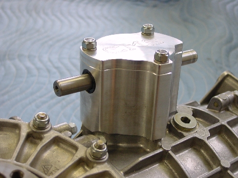

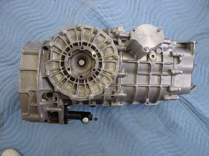

The G50/52 can have an 1" taken off the bell housing, then clearanced on the inside for the flywheel. In addition, the input shaft must be reduced that same 1". It then matches the G50/50.
Nose piece can be shortened, probably by most Porsche trans builders.
The picture in the previous post shows both, bell housing reduced and nose piece shorten on a G50/52
I looked up a lot of DRB pictures with the G50/52 installed, and it looks like the bellhousing shortening, flywheel clearancing, and input shaft shortening (just removing an inch off the end) could be done pretty inexpensively at a machine shop. Please correct me if I'm wrong. On the nose cone, it looked like a guy had just cut off part of the triangular extension for the doughnut mount, and simply shortened the gear shift selector. Am I reading this correctly? I spoke with Simon H. who did a G50/50 in his RF and he said he had about 3.5" of space between his nose cone and rear clip. Would shortening the nose cone of a G50/52 with the above method create a nose cone with the length of the G50/50 nose cone? I know that the G50/50 nose cone can be fitted to the 52, but I would imagine you'd have as hard a time finding the nose cone as you would finding a G50/50.

Correct, but not sure what the situation does for the gear shift selector. It may remain the same or it may need shortening, not sure. My gear shift selector hole was plugged closed due to the side shifter unit.

Not sure on this either, but I'll bet it's very close. Not sure where you live but if your in the US you might call Bobby Hart - California Motor Sports 928-855-5755 He would be happy to answer your question.
"On the nose cone, it looked like a guy had just cut off part of the triangular extension for the doughnut mount, and simply shortened the gear shift selector. ""
There's a seal in the very end of the case and behind that there's a roller slide bearing. So when you hack the back off the case you have to machine the shift shaft bore to two different sizes, for the bearing and the seal. Luckily it's made to do this , whether intentional or not, the bore is smaller behind the oringinal location of the bearing/seal, so all you do is open it up to the bearing/seal size further back. The unmachined bore about 14mm dia ID, the bearing is about 16mm OD and the seal is about 20mm OD. I don't see any real reason to go to side shift unless you have some different clearance issue. Lots of the G50's have been run with rear shift, unless the 50- 50 or the 50 -52 is longer even with the nose hacked off.
