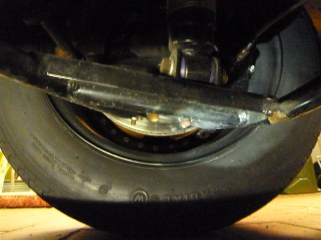

Guys,

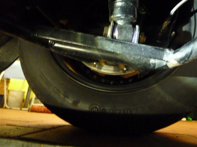

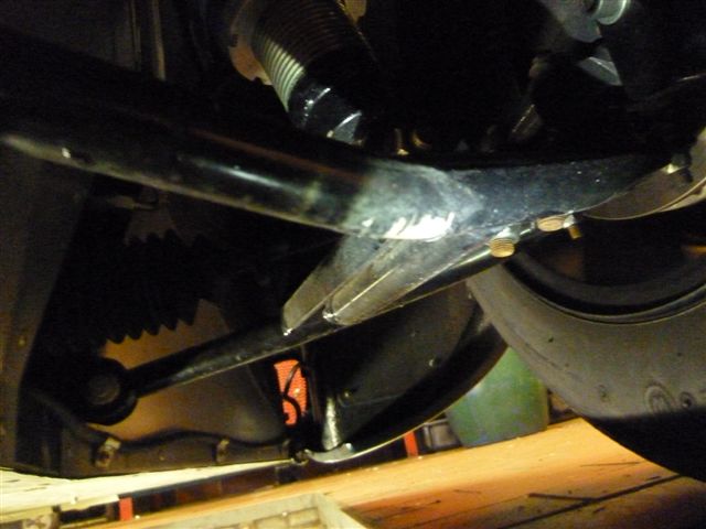

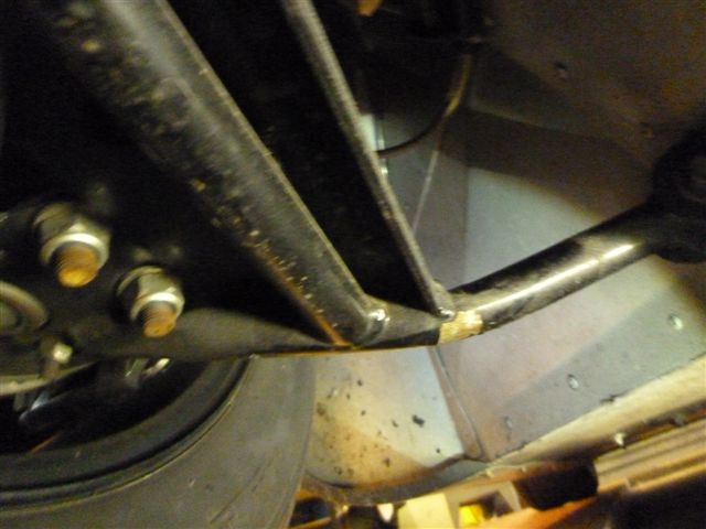

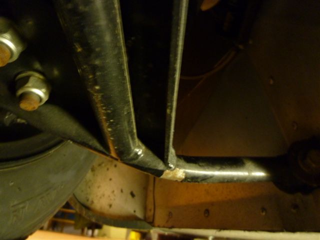

a some of you might know I sold my Tornado this year (pics below) to a guy here around the corner who is a professional race-driver. He owns around 12-14 vintage cars, many of them are raced by him, including 24h race on Nuerburgring. Including Porsche 911, Jaguar MKII convertible, Triumph, Mercedes, Renault Alpine 110 ( both FIA approved) and many more....
He knows exactly what he is doing, so please no questions about this.
I did build a stronger engine for him with around 400HP and after the break in period he drove the car several times around the GP track on Nuerburgring ( the track F1 cars race) and the car was behaving O.K. ( saying O.K. not good ). Yesterday he was about to drive the old circuit on the ring ....and right at the carrousel (kind of a steep turn, a bit bumpy) ....see what happened ...the right control arm gave up under load ....any other part I would say nothing, but this is more then just "ok....this sucks", this is unreasonably dangerous, could kill you and others, or best case just cost you a lot of money ...However ...it is far away from being a professional design, not even over engineered for safety.
The part is a complete faulty design and wrong choice of material. Just wrong and weak ...

This is not a new or unknown occurrence, read all previous articles on these failures.

Hi Carlos,
As Frank stated this is a known issue on Tornado’s and upgraded wishbones are now supposed be supplied as part of the kit. However when these new parts were introduced has never been made public, perhaps Andy Sheldon would like to clarify this. What year was your kit supplied, as obviously not by this date or the updated design is still marginal
Chris Hale had a similar problem (see link below) and I plan to change mine (post IVA) as a matter of precaution.
http://www.gt40s.com/forum/gt40-tec...ls/35173-new-front-suspension.html#post346089
Andy

I have often been told of this fault and I know that some other people,, no names.
upgrade these parts accordingly.
In fact I have seen batches of these upgraded parts being made, so it's not the odd one here or there.
No one likes to say someone elses work is not up to scratch but when it's common knowledge with so many, it should be addressed. I personally think tougher parts should be standard. This is not F1.
I suppose when someone dies it might get resolved.
But yes let Tornado say there bit !
If it were a main manufacturer it would have been a recall, perhaps Tornado will replace anyone who has ever bought a car with upgraded parts F.O.C.

The same thing happened to Des Finnan's car on track at the club AGM day at Donnington. The lower arm bent and then broke. As Frank says it is a well known issue with Tornados when used on track where the stresses are much higher than on the road.
However using any road car on track it is necessary to consider whether it is up to that job without modification.
I am not aware of whether there is any specific factory recommendation about the use of Tornados on a track or any advice as to what strengthening may be needed if so used.
It is fairly clear however that at least the lower wishbones should be replaced with much stronger items if track or severe use is to be envisaged.

I upgraded my wishbones to the Southern GT items last year after seeing my lower ones had started to bend in exactly the same way as others on here have. I know quite a few owners who have also done the same.

As others I see now have mentioned, I think this was supposed to be corrected by Tornado, but if not, or you don't want to go that route, I thought that my builder offered a conversion to a stronger suspension (know they offer various upgrades for the Tornado) but I won't swear to that. I'd post a link to their components but I don't want to violate any rules.
FWIW, I think you should probably talk to the builder before subjecting any of these cars to racing. I know that Tornado offered some things to strengthen the car for just that purpose.

The standard wishbones are for general road use and light track use. They are not intended for competition use.
For hard track use we have always offered a suspension upgrade which includes fully rose jointed suspension.
The standard wishbones have been upgraded sometime ago but as we have been manufacturing these cars for 23 years there are some very old cars out there.
I am sure other manufacturers will face similar problems when they have been producing kits for such a long period of time.
