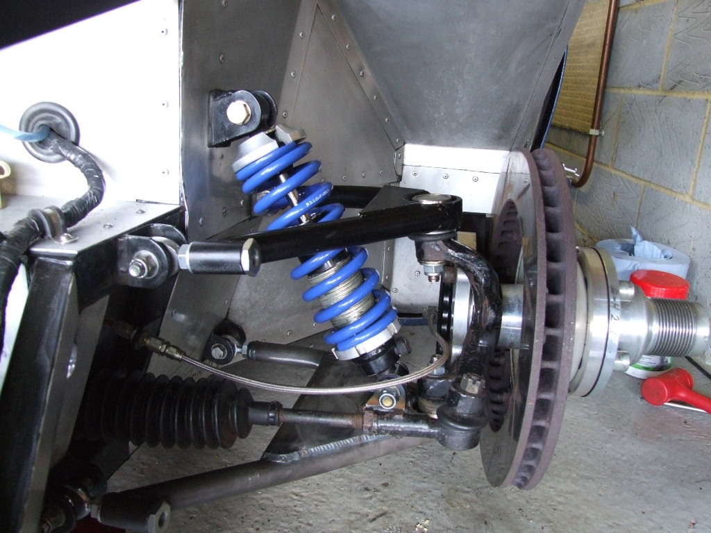

You will see in the attached picture that the alternative lower wishbone unit ( not a Tornado product ) carries the weight of the car as close as is physically possible to the outer upright swivel joint, which prevents any bending moments or stress in the wishbone arms, Frank

That looks perfect !
