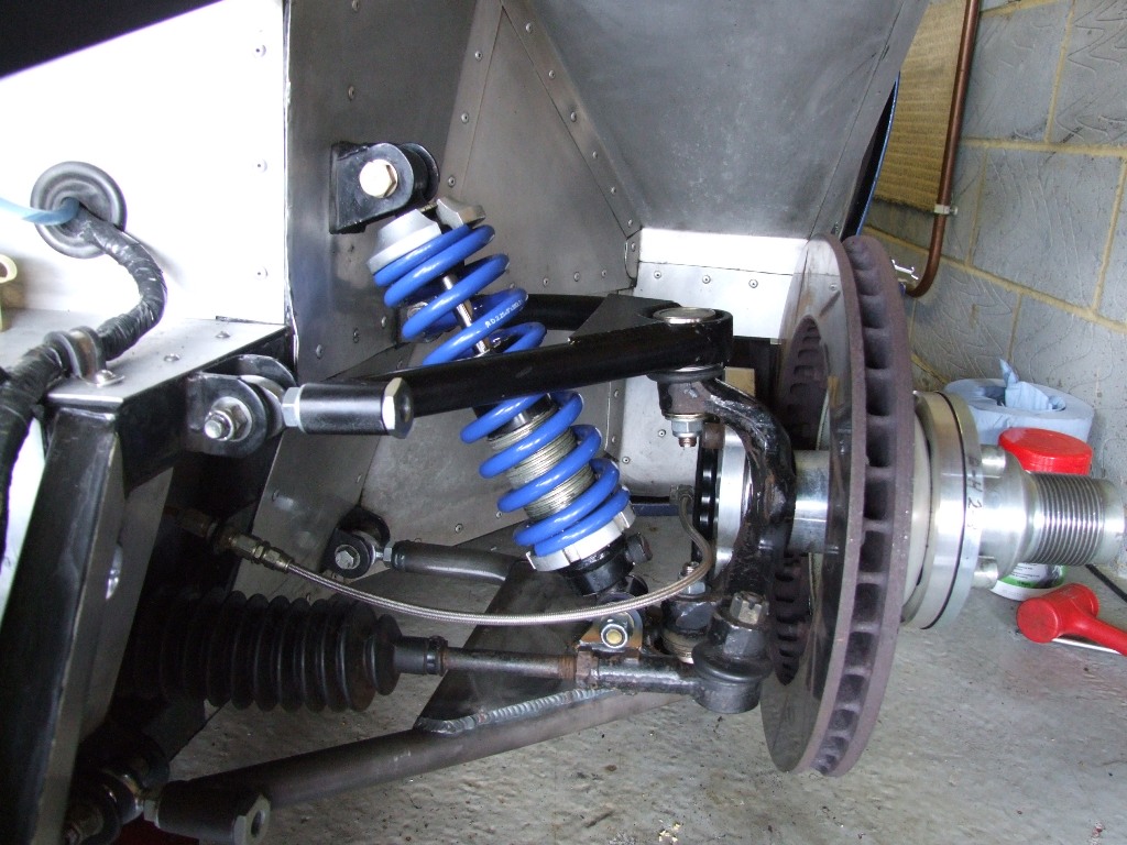

What is the wall thickness and OD of the lower arm.
If I had one fail I would have run it threw the bandsaw.??????.But thats just me.
You can clearly see the shock is to far in,maybe they are trying to chase shock ratio or there is component clash on turn
Has anyone made a shock bracket that fits onto the lower ball joint mounting bolts or do they wait till it breaks then put the same part back on.
It may require a longer shock and a change in spring rate due to ratio change.

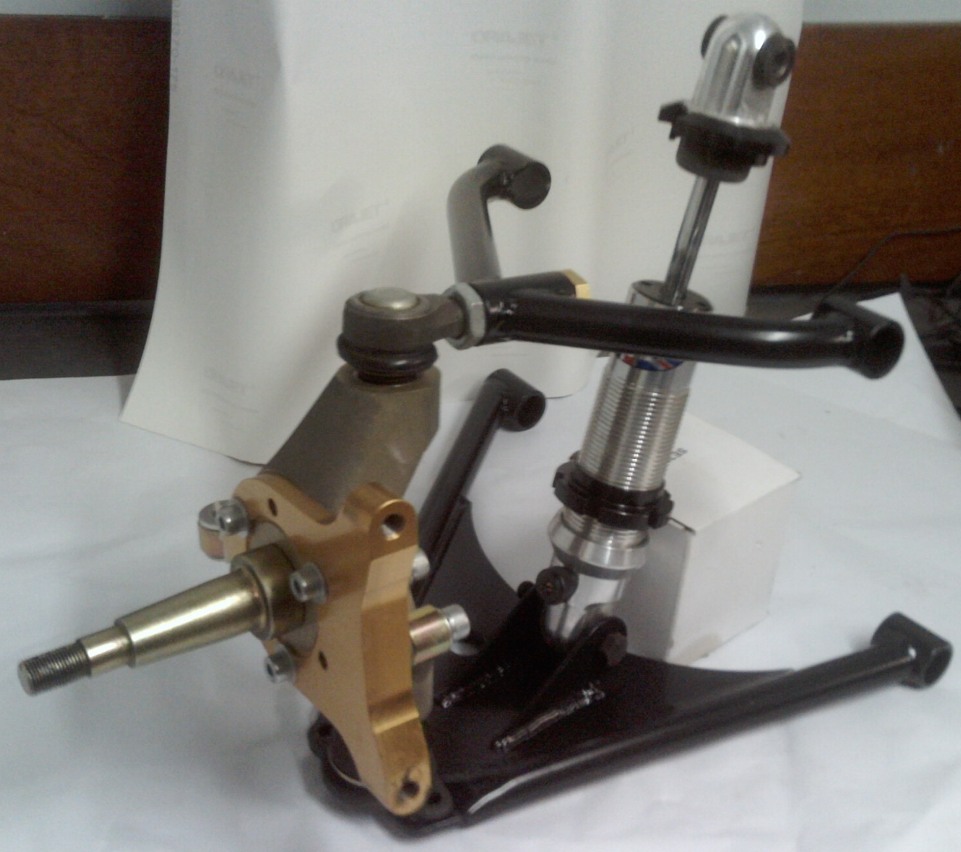

The picture posted by Frank earlier shows a much better lower shock mount position. As Jim say above, what is the material thickness of the tubing used in the standard lower arm?

that looks indeed better, the schock as close as possible to the point/wheel of the lower arm, so the stress comes there and not 'half-way" the arm so that every load works like a lever on that point were it can bend the lower arm...

maybe they choose that "wrong" point for fixing the shock because of this option?>>
that way it looks like the shock has to go more away from the ideal point see>>

maybe that system is "wrong" takes to much room? and makes the stress point go to the "weak" point of the arm, instead of mounting the shock as close as possible to the outer point of the arm, the shock is mounted almost half way and so much stress on that point (lever arm acting manner, wheel to shock point) Hope you understand my limited way of explaining what I see in English :D
also, Tornado uses the other wheel things, and then you see that the shock could be replaced more to the wheel if you want...(remake those) their is some room left to get the shocks closer to the wheel/point.
Putting the lower coilover mount so close to the center of the A-Arm is like supporting a 2x4 on each end and piling a ton of bricks onto the middle of the board and expecting it not to break. This is exacerbated by the gusset plate only extending back a tiny bit from the lower mount location. It creates a hinge point- pretty much a predefined fault line- at which all of these A-Arms are bending/breaking. This is adequate design for a custom street/show car, but very poor design for a car driven every day on bumpy roads, let alone a track car.

It is very clear that these arms are still inadequate after the redesign, unless wall thickness was tripled and the material was changed to moly or something much more suitable for this type of component. I would not be looking to Andy for news on which type of A-Arm they have- I'd be waiting for a new design from him, or fabricating a jig to make my own. You can't expect everything on such an affordable kit to also be designed to the nines.

You will see in the attached picture that the alternative lower wishbone unit ( not a Tornado product ) carries the weight of the car as close as is physically possible to the outer upright swivel joint, which prevents any bending moments or stress in the wishbone arms, Frank
Carlos
There is your sollution post # 32, ring Frank.

Jim, and others who have asked, the bent OEM Tornado arms that I have seen were made using 16swg ERW seamed tubing.

A bend in the rear leg of the front lower wishbone is usually caused by fitting the wrong shock absorber, spring or incorrect adjustment. There is a warning about this on page 30 of the build manual.
The shock and spring combination controls the suspension travel. If the spring becomes coil bound the shock load will go to infinity and something will bend. In this case the wishbone.
The wishbone can easily be replaced but the chassis is more difficult to repair.
Looking at picture 5 in the original post the bottom platform on the shock absorber looks to have been wound right up which will cause the spring to become coil bound during suspension travel.
The platform should only be 1 or 2 threads from the bottom of the shock.
I have seen mentioned that moving the lower shock mounting outboard removes the bending load. This is not true and would only reduce the bending load by approx 10%.
Moving this mounting outboard will soften the spring rate and more easily cause a coil bound situation to occur. If the wishbone is manufactured in gas pipe like some I have seen it will damage the top shock chassis mounting. Those who have fitted them be warned!
