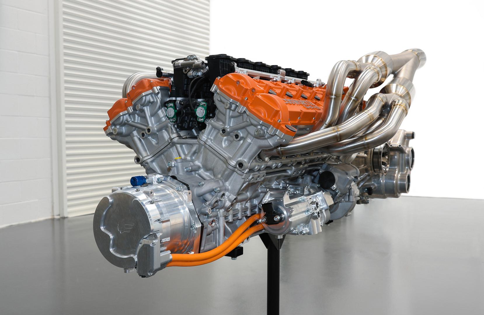

Gordon Murray Automotive T.50
Cosworth V-12 engine
Notice the 48 volt integrated starter/generator on the front of the engine. It does away with all belts on the engine, it starts the car, it runs the spark plugs, it runs the fan at the rear. It saves several pounds of weight. Up in the nose of the car, they have a 12 volt battery, a 48 volt battery, an inverter and they all weighs less than one 12 volt lead-acid battery.

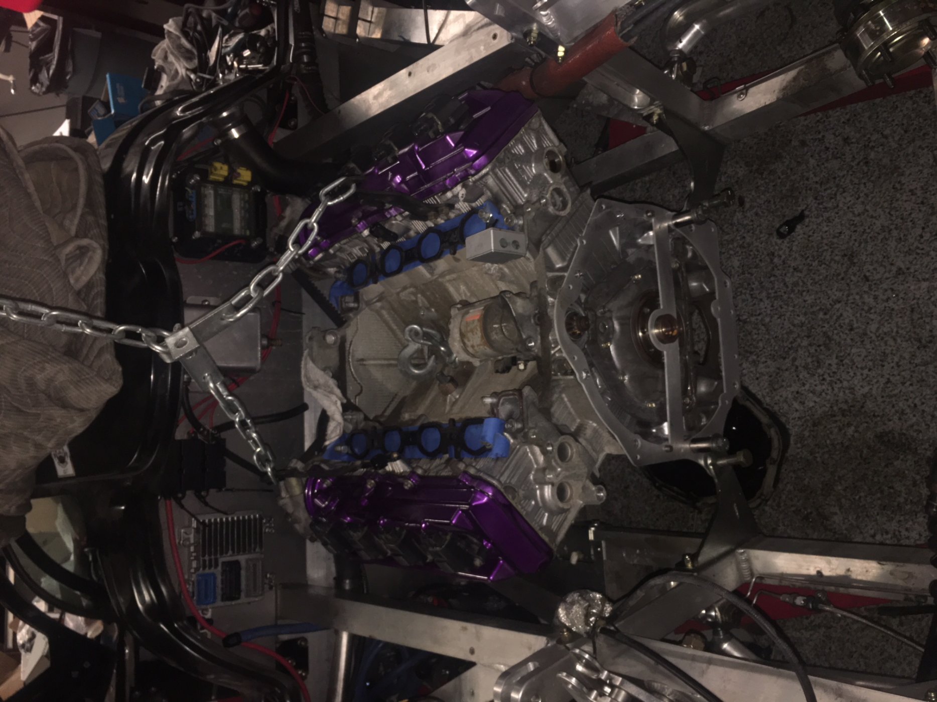

How bout some pictures of the engine compartment with all this cooling PITA plumbing? Don't get to see the Yoter in an SLC ... much.
Sorry for my slow reply. Have not been on in a while. Mine sees little around town driving. When it does it usually involves lights and a discussion about not having plates, insurance, etc. Don't have any great pics that show cooling. Here are some general ones...

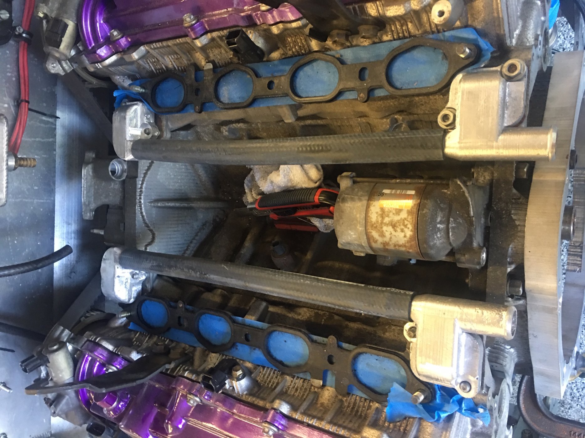

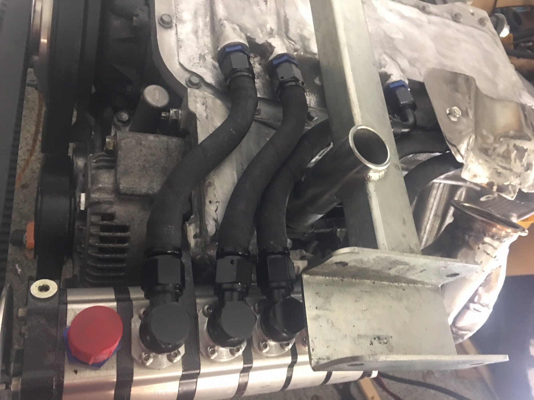

Fitting oil pump and exhaust around the mounts/cross-member.

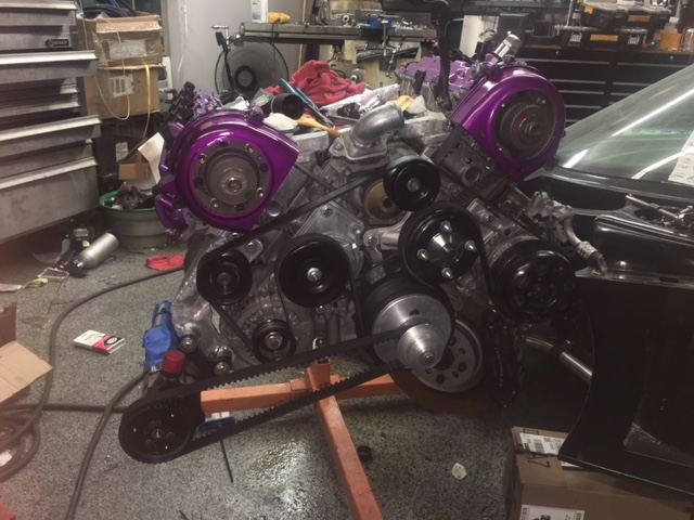

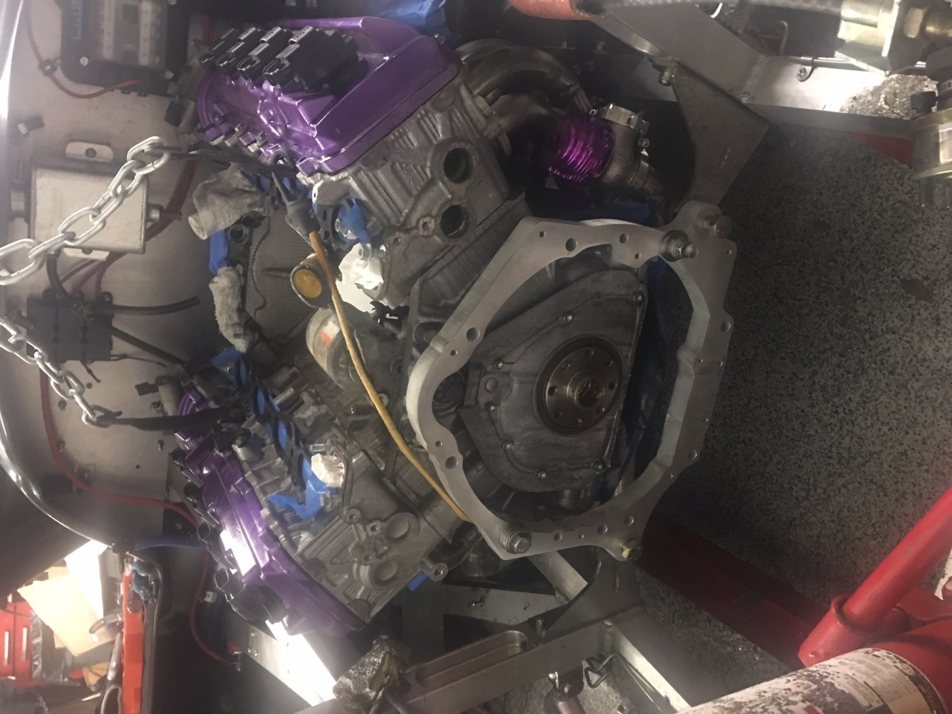

Motor in with adapter plate

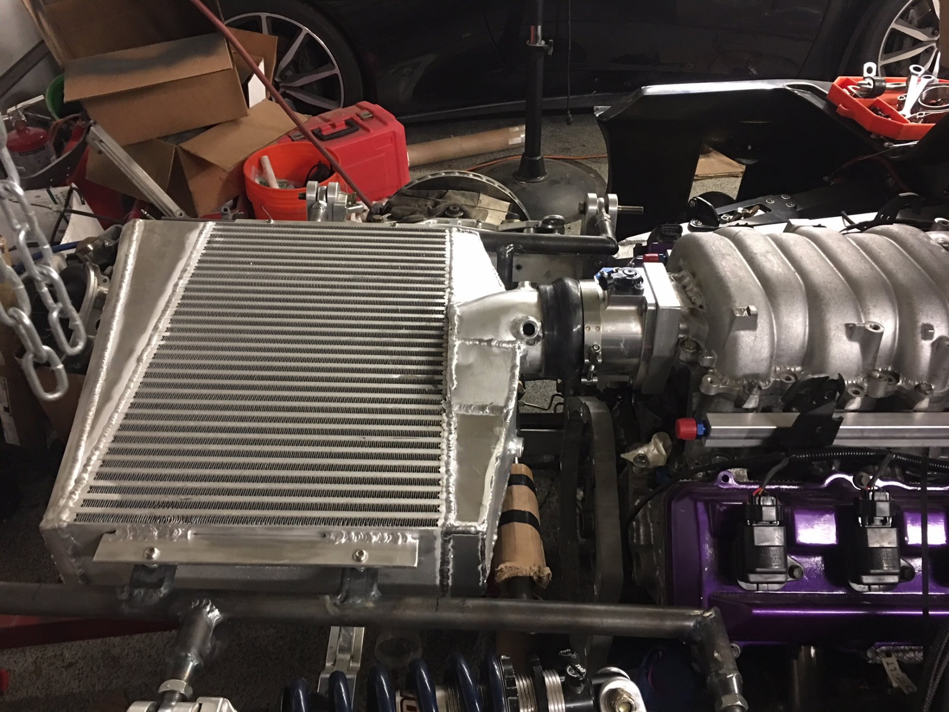

Intercooler which sits over the Graz. Fed by the street tail rear scoops. Does a great job of keeping IATs down.
Coolant 'hot side' plumbing. Fittings are investment cast at home. If you are familiar with the 1UZ VVTi cooling you will probably realize the number of hoses/pipes/fittings this replaces.
Motor ready to stab. Needs to go in without the intake.

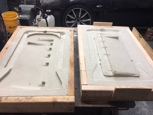

Sand mold for dry sump oil pan. It's shallow enough the exhaust goes under the pan without hanging below the frame.

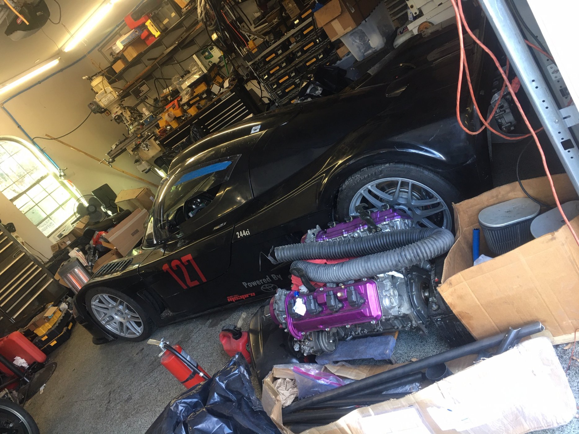

Spare 1UZ next to the car. I tend to keep one ready. Makes it easier to crank the boost up on the one in the car.

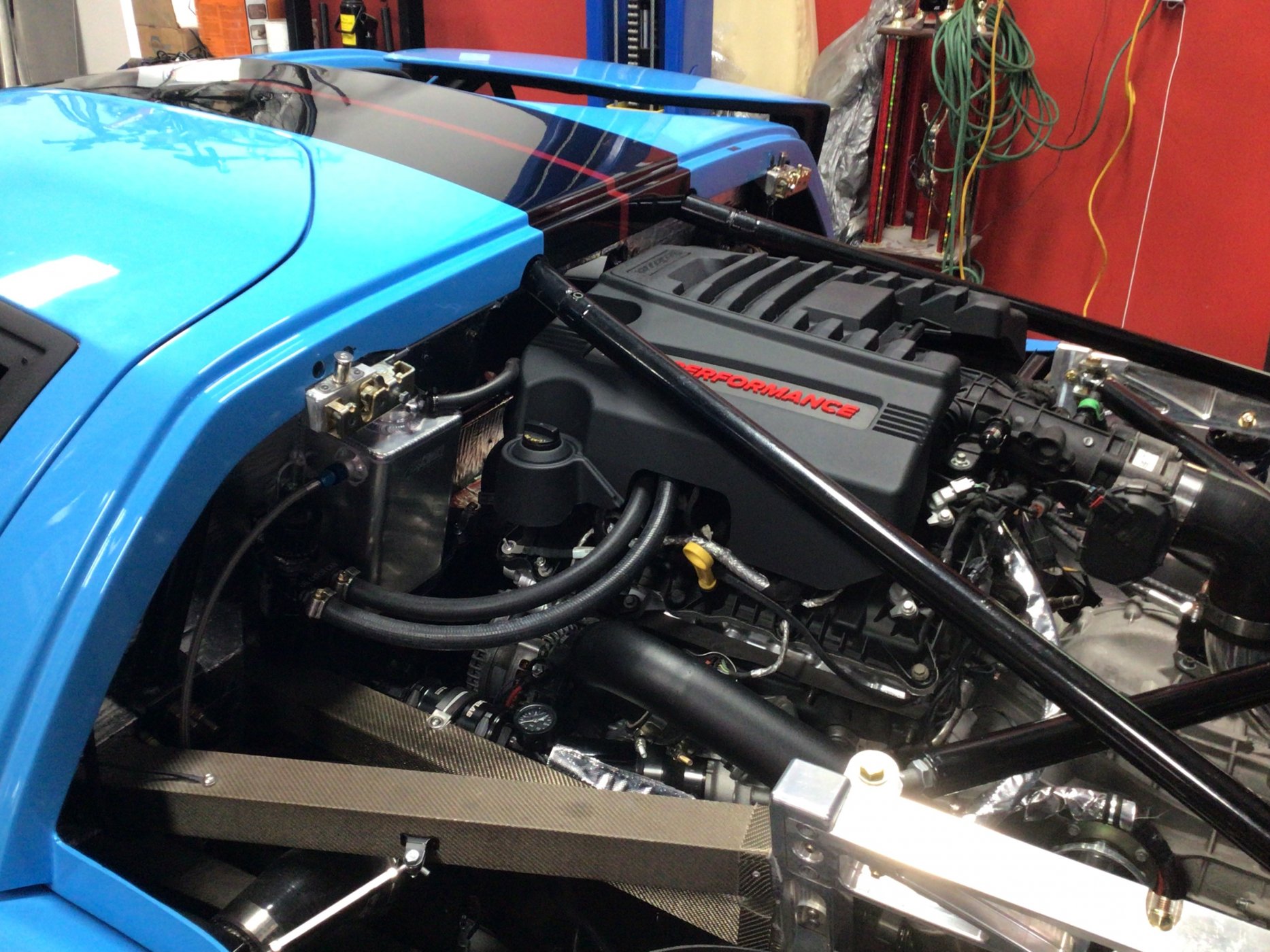

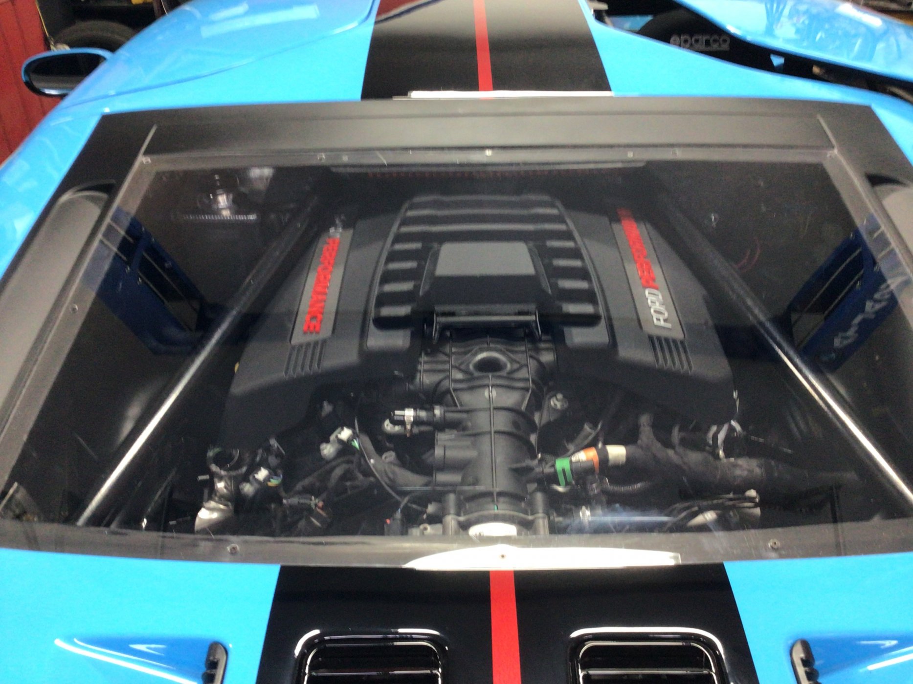

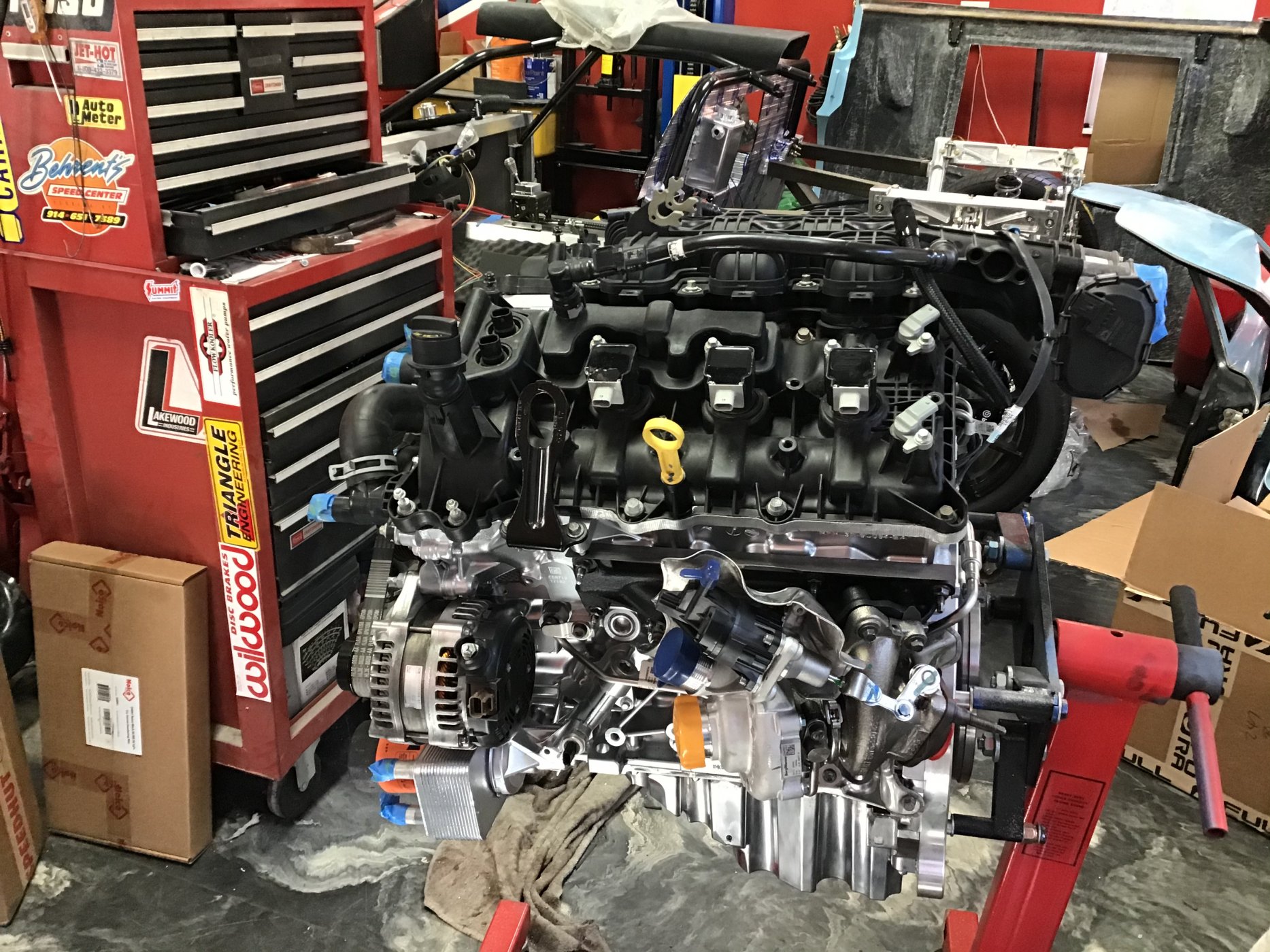

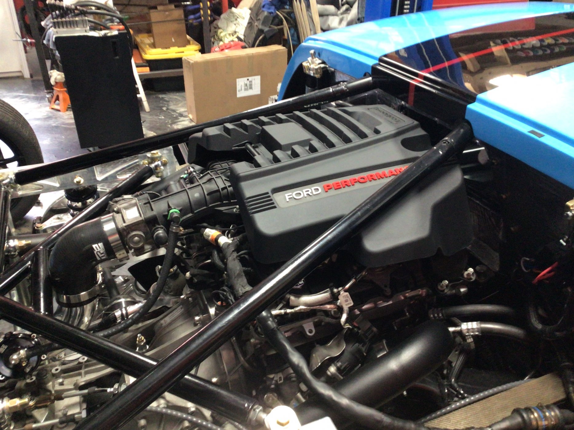

If you want a great power plant with way more than enough power to more my GTR along the 2017 Ecoboost Motor with Raptor Twin Turbos and inter cooler setup is just the ticket without modifying one internal part the engine produced 558 HP at 6200 rpm at 14 lbs of boost and when I tell you hit the gas pedal and hold on when the turbos kit in it’s a heck of a lot of fun
