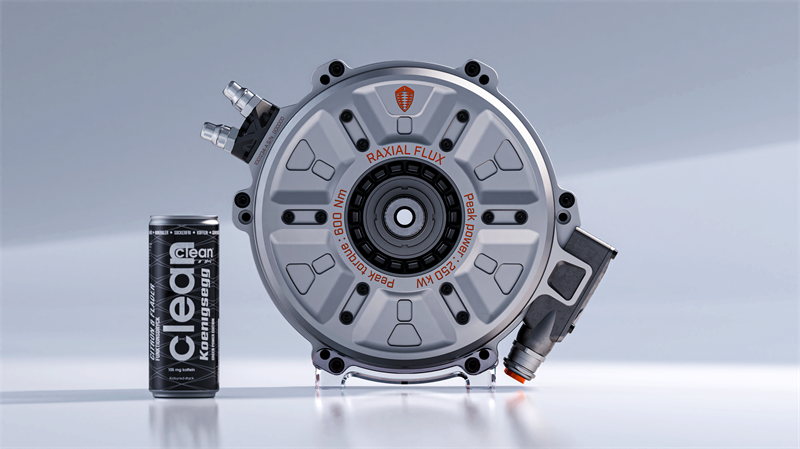

Koenigsegg wants you guys to have his new Quark electric motor, " . . . it just makes sense to share it as they're very modular and can fit many different needs."
image from Koenigsegg
Also, " . . . he says the company will license the motor design to interested parties."
The Quark is expensive, but "It's also possible to create a less costly variant of the motor that doesn't require as many exotic materials—as it sits right now, the Quark uses Koenigsegg’s own CarbonCore hollow carbon fiber and motorsport-grade high-strength steel for the rotor. Using more conventional materials would reduce peak RPM by about 700, says von Koenigsegg, but 'it would still be amazing, and, of course, drastically less expensive.'"
Here is the original article: How Koenigsegg’s Tiny, Ultra-Powerful Electric Motor Works.

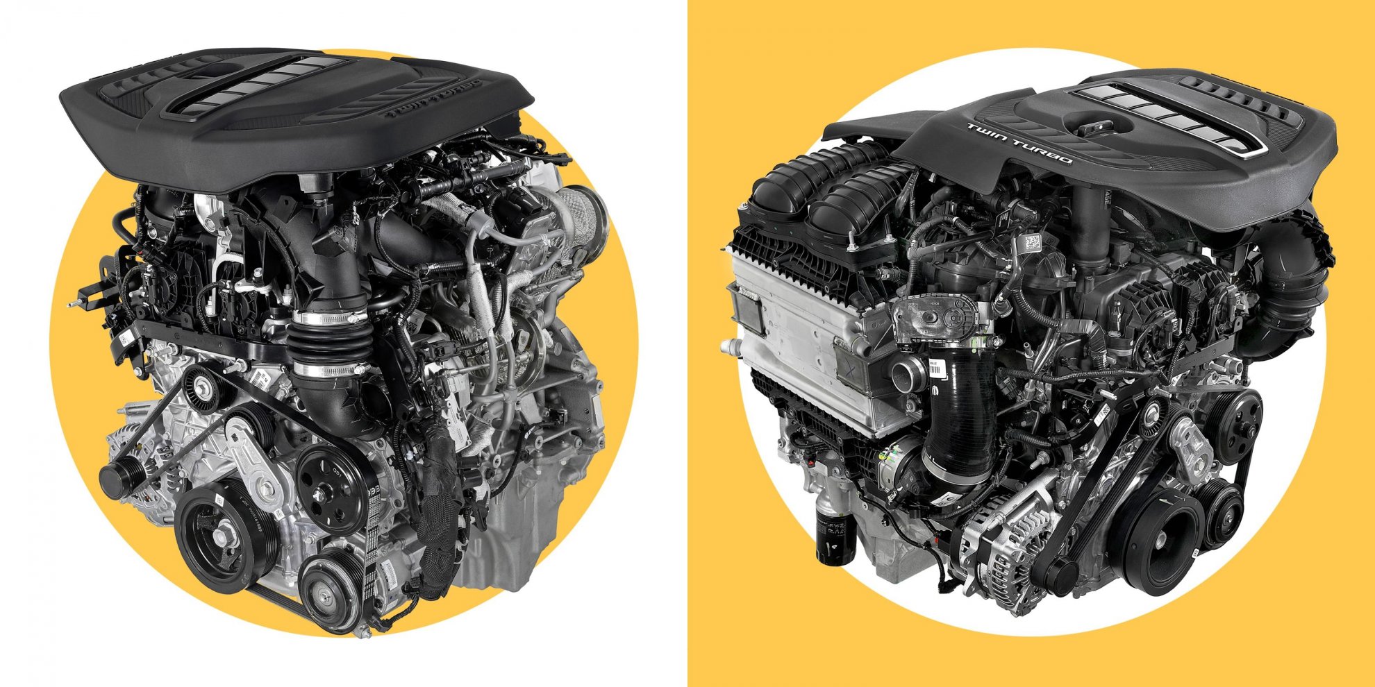

New engine from Stellantis
Stellantis Whips Up a 500-HP Hurricane
Autoweek
"Stellantis propulsion chief Micky Bly says the Hurricane will work well in every engine bay currently occupied by a Hemi, from Dodge Challengers and Jeep Grand Cherokees to Ram 1500 pickups and Chrysler 300s. The engine is intended for north-south installations in rear-drive vehicles . . . "
Stellantis Hurricane I6 Hemi Replacement
Autoblog
"The new I6's advantages go beyond basic power output. Every Hemi family engine currently in production is based on an iron block design, so they're heavy. The aluminum-block I6 shaves weight off the total engine package, even if some of that gets added back thanks to the turbos and their associated plumbing. The standard-output I6 weighs 430 pounds, Stellantis engineers told us; the high-output adds just another 11. Fully dressed 5.7-liter V8s are in the 550-560-pound ballpark, and 6.4-liters close in on 600 pounds.
" . . . the standard output Hurricane measures 33.4 inches x 28.7 inches x 32.7 inches. The high-output checks in at 33.9" x 29.0" x 33.4"."
Here is a photo.
"The standard-output I6 weighs 430 pounds, Stellantis engineers told us; the high-output adds just another 11. Fully dressed 5.7-liter V8s are in the 550-560-pound ballpark, and 6.4-liters close in on 600 pounds. "

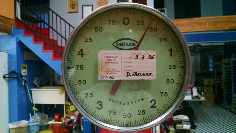

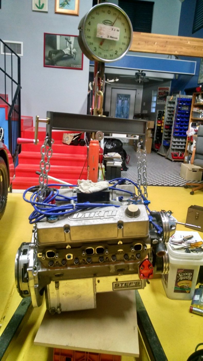

Another data point- my complete (minus carb) Donovan 383 engine weight is 390- 400 lbs. This engine has a very heavy Lunati crankshaft so you could probably knock off 15 lbs by using a lightweight crank. Power output is around 550- 600 BHP which, in a 1950 lb mid-engine car, is plenty. A lightweight engine has many, many advantages!
