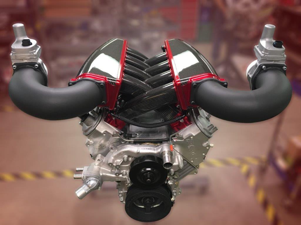

I looked at putting the Kinsler carbon fiber cross ram and the Harrop ITB in my SLC. The Kinsler is over-the-top cool but it hits the rear window -- could probably be made to work. The Harrop has been done twice that I know of. The issue is filtering. There is no room for a proper intake manifold so in both cases the builders went with filters on the trumpets which typically cancels any power gains (you still get the cool factor though). After a lot of back and forth I went with a Harrop supercharger instead.
I am having Katech build the motor for my GT-R. We are starting with an LS3 block, adding Texas Speed LS7 heads, Katech valve train, a Performance Design Carbon Cross Ram Intake with Custom Throttle Body Adapters. Katech modified the Oil Pan and the Water Pump. The motor is built, waiting for the dyno. After it checks out, the Carbon Valve covers will be added and sent to SuperLite. Thanks to Katech and Fran for mocking up the motor in the GT-R to see what custom mods were needed to make this fit the space. The photo is the motor pre dyno.
