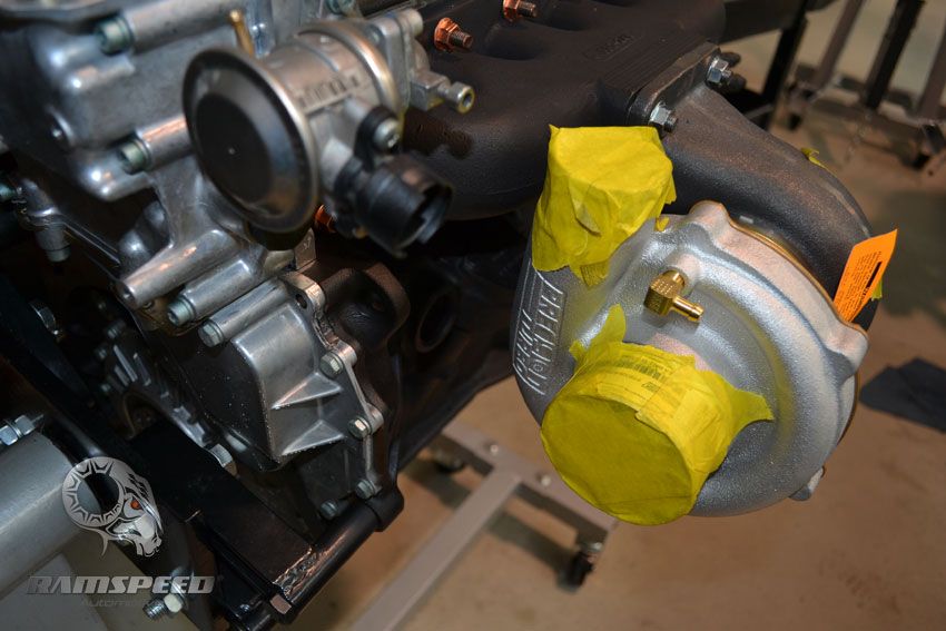

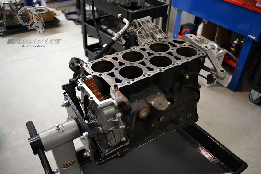

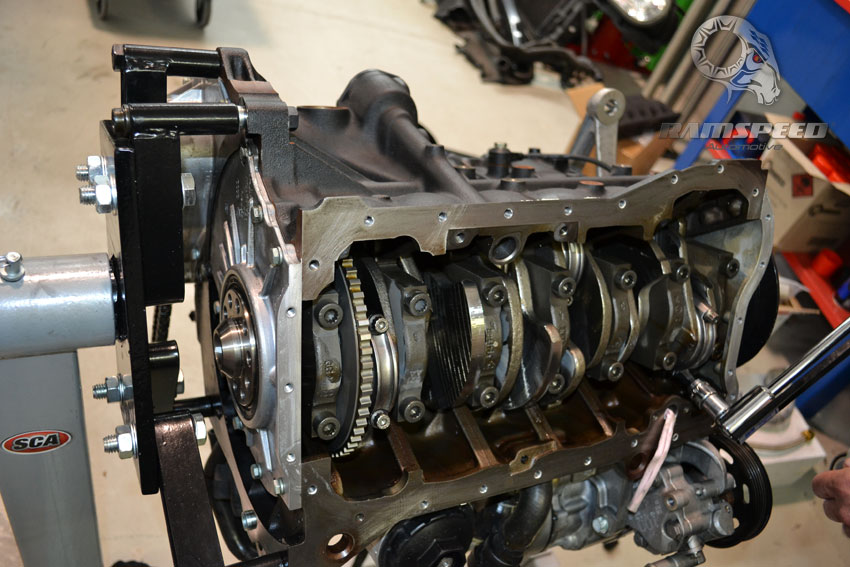

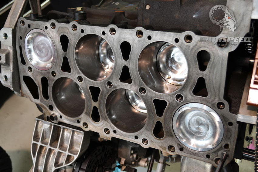

fran, would this be able to fit into a SCL vs a inline 6 ? its a VR6 from a VW r32 golf. im thinking that it should be able to. the block appears to be shorther than a v8 or any of the ls series engines that everyone is installing into the SLC, by the looks of it it should fit fine with the turbo to the right, right ?
No those motors can really sound killer.
It will also fit into our nemesis family of cars
i know you've said alot of times before that anything can fit. you just need to have enough money. so just to be clear, you are you saying that this VR6 motor will fit into the SLC, as well as the nemesis ? is that correct ?
Yes. Both.
Regarding the SLC, you will probably have to send the engine up so they can fabricate the mounts/transaxle plate for it.
I think theres no Problem , had much to do with VR6/R32 in the Past - and they are very compact - i binned all the Stuff i had before i move into my new Shop so i cant test / measure it . Length- and Width-wise should be no Problem - only the Height with the stock Intake can cause some Problems i think...
Yes. Both.
yes, i know, as that would be extremly difficult to program thier cnc, or cutting machines to fab up that plate and mounts with out a motor they dont commonly deal with. They could probably do that for a ls3 or any ls series engine for that matter, since its the most widley used motor out there for slc's but, yeah, that would be pretty killer to have this motor, i think. i just wouldn't want to run the risk of purchasing a motor, and find out that its too wide, or too long, ect.. so thats why im asking every chance i get about every single thing that i can think of, lol
