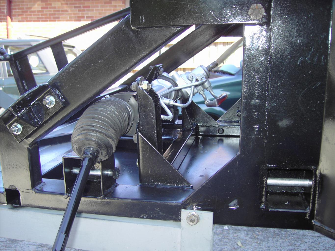

In the 40 I am building for my lady I am fitting power steering as she finds driving my 40 a bit too heavy at slower speeds or tight corners.
This is a photo of the power rack I have fitted in her 40.
Dimi

Hi Dimi,
what was the rack type you used? looks good the route i took was the same as the Rally builders are taking on the content. They are installing electrically operated columns to reduce the risk of failure or addition power loss & weight.

Hi Mick
The rack came out of a 96 Toyota Spacia/Townace van and required no modification as the width is perfect for the DRB with corvette front suspension and fits the Corvette rod ends.
I prefer the hydraulically operated rack due to the fact that the rack works as long as the engine is running.
With electrically operated racks there is always the risk that if power fails, blown fuse or bad connection, there is no assist and usually always at the worst time.
Dimi

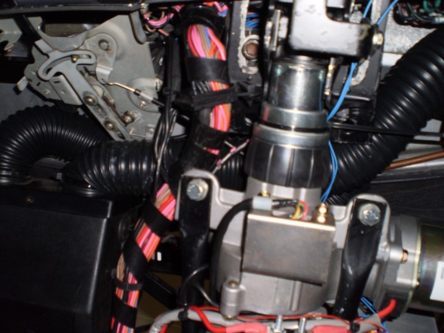

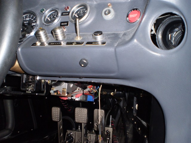

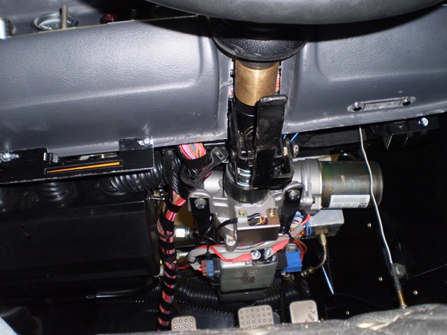

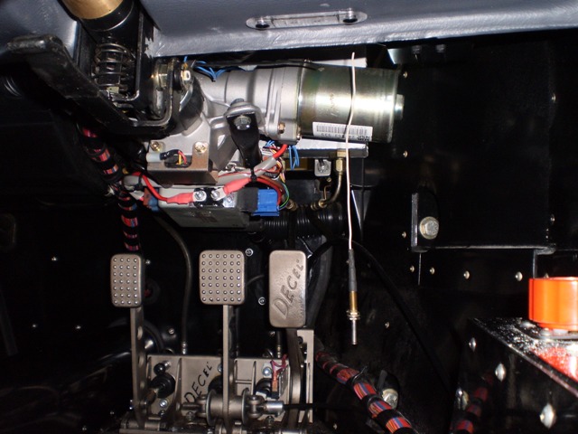

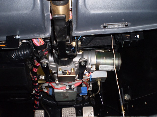

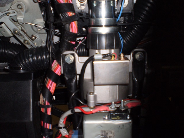

Couple of pics of the power steering column installed. The variable control is to the RH side of the steering wheel easily accessible. very simple install hope like hell it works.
Mick

What size shoe will fit between the floor and the bottom of the steering power jobbie and stuff. Just looks a bit tight on toe room for my size 11 boats!
The pedal height would be about the top of your shoe Ian my foot is 8.5 and the heel is of the floor, however the end bracket on the column can be raised or lowered to suite. It looks lower than it is.
