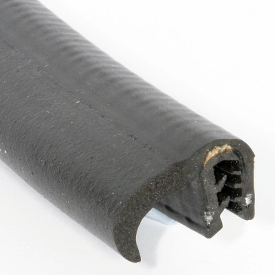

Hi Nick,
I used seal profile ETS60 from Seals Direct, which is also sold by CBS under part number TRMDRL. As it is not a bulb seal, I found it more compliant and easier to use, as it was not trying to lift the door, as the sealing part of the seal takes up less space when compressed.
I still think you’ll have to grind down the thickness of the edge, but probably not all the way to 3mm, as the design specification
Andy
