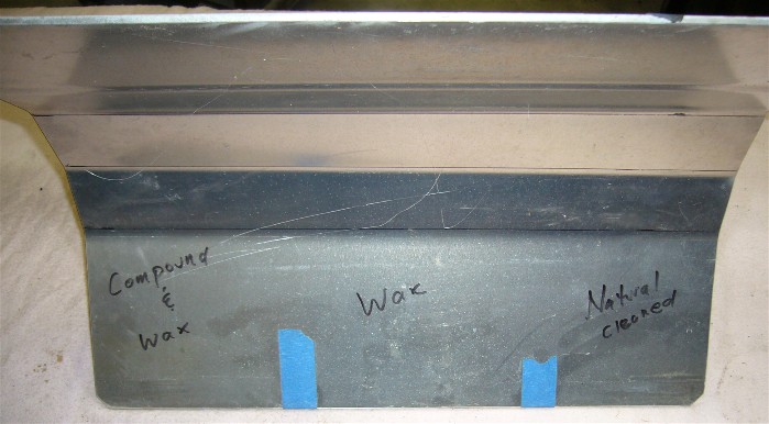

Hey guys....Time for an update from my 07-26-06 posting earlier in this string. Well... much to my wife's pleasure I have removed the aluminum test panel from our back deck. It has been sitting there now since April. Bottom line: There is no visible difference between the three sections of the panel.
Once again, details: I took a sample panel divided into three equal sizes and treated one with brake clean only, another brake clean and rubbing compound and a third brake clean rubbing compound and a good coat of wax. I set the panel on my back deck on April 15th.
I am sold......do nothing and enjoy that sexy aloooominium!!!
Rob
