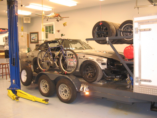

BTW, the trailer looks like this:

Looking at the photo of the trailer, yes there is far too much weight forward of the wheels.
The best solution all round would be to stay with two axles not three and relocate them forward till you achieve the right hitch loading.
If too much weight is rearwards of the axles then this makes the trailer unstable with a tendancy to fishtail.
Weight forward stabilises the trailer but too much weight will cause structural failure of either the trailer or the tow vehicle.

Firstly bear in mind that the recommended tongue weight should be no more than 15% of gross weight (and ideally around 12%), so assuming you have the typical car trailer with 2 x 5,200lb axles and even if its fully laden you are over that and the weight distribution on the trailer is too far forward, no matter what your hitch rating. I'd recommend you get a gross weight on the trailer and work on distribution from the above angle of % tongue weight.
There's being prepared, but how many tools are in that box? The T70 shouldn't be much over 2,000lbs and weight is over the axles, so what is all the weight?
I would not see a third axle as a solution on the trailer pictured, shifting the axles further forward would probably be the way to go IMHO.

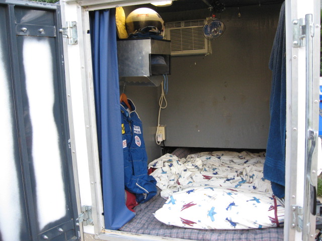

Gross weight is high, around 7200 lbs but there is a lot of stuff on the trailer in that configuration - 2300 lb 260Z, 12 wheels/tires, 30 gals of gas in the fueling rig, that box is steel and has the air compressor, tool box, sleeping bunk, AC, two marine batteries, 1500 W inverter. The under deck steel storage lockers are 7ft x 2 ft x 1 ft and there are three of them, chock full of spares - drums, alternators, brake calipers, drive shaft, clutches, etc. two spare trailer tires on the rig, three fire extinguishers, spare car battery. Cooler and grill mounted on one side of the trailer. Stereo in the box, TV in the box, etc. It adds up.

I may be wrong, but there appears to be some room behind your car... can you not move the car further back and move more weight over the axles of the trailer?
Dunno for sure... can't really tell from the pic. You may not have that flexibility.

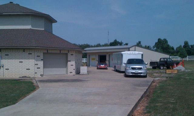

PS: Crummy picture, but you get the idea of my truck and trailer.
That's Mike Trusty driving his GT40 for the very first time at Jack's house back in July!

Ron, perhaps add some more structure to your tire rack extending back to the rear of the trailer...and then shift weight back to the rear. In other words, a rack that goes all the way to the back of the trailer...you can strap stuff down to it (tires) shifting the weight rearwards. Side benefit of it is that you can lay a full length tarp over it when you're at the track and essentially have a covered and dry area to work on the car if necessary (or just keep the car and you dry).
