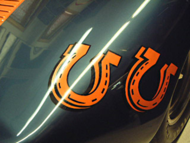

I had an extra set of horseshoe decals so I put them on to see how they look. What do you think?
Bill D
Too small Bill, looking at chassis 1049, you need larger swag on there.
My $0.02. or $0.013254 CDN

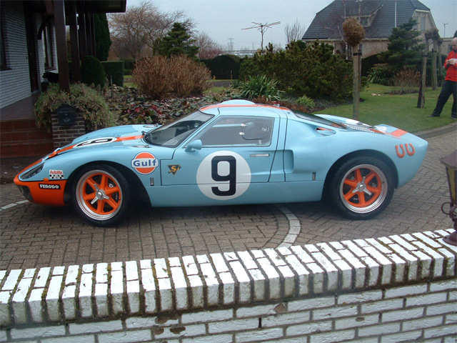

The horseshoes were from the #9 car as I'm sure those are the same one that came the "I say ding dong" Fellow on EBay. I think Gerrard (gait1969) was the one that had done the art work on them and I hooked him up with Tony the ding dong decal guy in the UK. They are definitly smaller and in a differnt place on the 9 car then the dark blue car. Probabally would not be a big deal for him to print them up in the larger size, he was a nice fellow and turned them out really fast from the art. The art was vector based so just a matter of changing the scale the re-print and cut.

Thanks Sandy. I did get them from that vendor on eBay.
I am going to have my painter paint them on and make them 20-25% larger than the decals.

The measurements I gave in the earlier thread are 100% accurate. It is better to have the logo in cutted vinyl, which looks absolutely better and lives longer. You can have that done by any local shop, so it's easier. Post me if you'll need the files. Here is how they look on my car.
Nice work Bill! As popular as the Gulf cars are it'd seem like a good idea to get all the necessary files, send to a good graphics person, and produce a few sets all at once for public consumption. A group buy deal.
