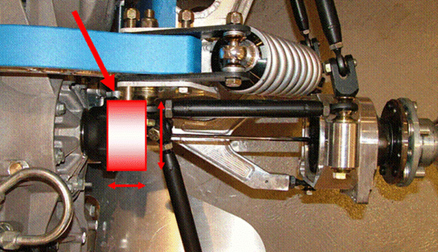

Not much luck in getting detailed replies to emails from RCR for the last few weeks. I'm wondering if a current RCR owner can help.
I'm trying to move my engine as far forward as I can and would like to know if someone can tell me the dimensions of the CV joint on the STD drive shafts supplied by RCR. I have had them on order for a while and I'm really not sure when they will be sent but would like to position the engine before they turn up. The diameter and "thickness" as shown in the image below would be a great help to me. Thanks in advance.

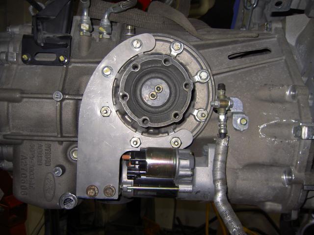

Check out the link below to my website as it has some of the information / pictures you are looking for Jason. If you have any other questions I'd be happy to try and help as well.
Driveline:
GT-Forty.com

Hi Jason,
I'm sure they are Porsche / Commodore (and various other manufacturers use them) CV's, I have some you can use to set up the trans / eng before your axels arrive ?
There are 2 versions with slight differences in spline length only, this may account for the 2 vs 1 circlip attachment on bogfoots axels - we have had to do the same with new old stock parts.
Regards Paul

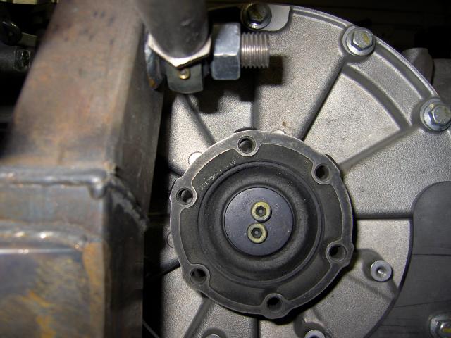

Received my 12.5" long drive shafts originally purchased from RCR last week (supplier was very helpful in sending corrected length shafts). Just fitting them at the moment and shaft length is now good (13.5" was too long), outer CV bolts up fine but the inner CV will not fit to my Ricardo transaxle output flange. I believe the RCR stub axle bolt circle diameter is 94mm and a 10mm bolt is used (108mm OD CV joint), BUT the Ricardo output flange bolt circle diameter must be different! I did not specify this with the supplier as they were originally ordered a year ago with my car from RCR.
Does anyone know what a Ricardo output flange bolt circle is? I measure it to be ~95.75mm. The 10mm bolt fits in one hole but it looks like the bolt circle diameter is NOT 94mm (its slightly larger). Looks like a different bolt circle diameter is required, I may be wrong?
Help from anyone would be great as if the outer race is not correct on one end of the shaft I do not know what to do.

They are from the "drive shaft shop" in the USA. As they were ordered for this exact installation I will try to get some info from RCR on Monday. Just wondered whether the Ricardo bolt center radius I measured was standard? If it is not the only option I can see to use the CV's I have would be to have the existing holes elongated about 0.8mm radially (in a milling machine with an indexing head. It will only leave 1mm at the edge of the hole and CV outer but this may not be a problem. Or drill another 6 holes in the CV, but I will try to get some that should fit the application they were ordered for. It may be VERY hard to drill them. I hope I'm not doing something wrong!

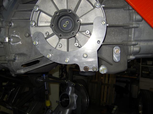

Hello!
I have the same problem. I measure it to 96mm. I show some picture of my driveshaft place.
Where is the best place to bay cv and drivshaft to my car?
I have more building picture here. Picasa Web Albums - Magnus

I just tried a 930 cv on my ricardo flange and it does not fit. on my Porsche buggy trans the cv fits into a recess on the drive hub. are there any pics of the stock ford drive shaft on the trans end. does the stock cv fit into the internal bore of the ricardo drive flange? it does not seem right to just bolt up to the flange with no way to center the 930 cv except the bolts.
I will post a pic of how the 930 dimensioned CV fits onto the Ricardo....as mentioned I use driveshaftshop CV's as part of the custom axle assembly..not stock Porsche CV's...not that it should make any difference
The Ford inner CV becomes more problematic when you have the Factory Ford inner flange badly machined as shown in a previous picture by Magnus...
