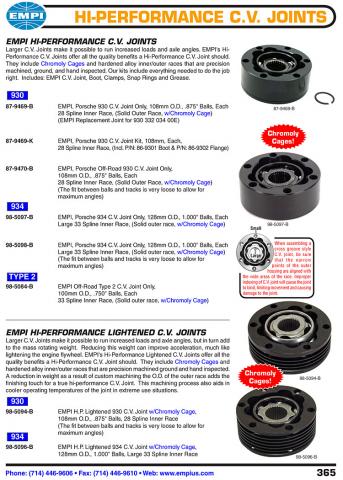

The ridges on the outside are how this replacement set came from RCR's supplier, its not a polygroove, looks similar I guess! Fran is checking why, only reason I can see is someone thought they looked "pretty" like this or they were a little lighter (offset some of the mass of that 100,000 pound Ricardo gearbox)! Personally as long as I get them to fit and this does not make them weaker I'm happy.
the grooves are to make them lighter. the off road guys use them for racing. does not do much for weight. does a lot more for the price they can charge. they do seem to hold up well even with the grooves.
As the groove appears to be deep(look at the top pic and the groove is as deep as the bolt holes) me thinks they might be cooling fins to extract heat from the joint.

The regular ones from EMPI are $57 and the lightened ones are $114
