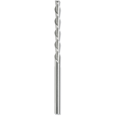

bryanf
For small cutouts like the NACA ducts on the front clip a multipurpose cutting bit on the Dremel works well.
