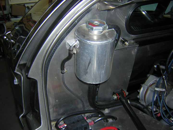

Peter My tank is 270mm up from the top of chassis (following the bulkhead angle) and 70mm in from the lip on the clip.I have no bulkhead or clip mods.

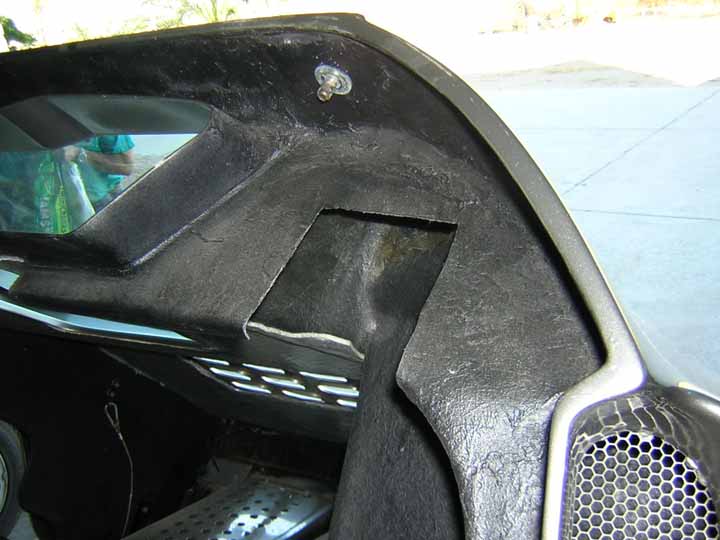

Here is where mine is mounted. And here is where I cut the rear clip inner panel so that it would fit. This is how all are done to my knowledge.

Hi Hersh I do have a clip cutout similar to yours so I may have modified it and forgotten.Well it was a while ago.Hope That didn't throw you Peter.My tank is pretty much where Hershal's photo shows though.The top of my clip cutout is rounded like a spanish doorway.

You guys are better than a build manual, I suspected that cutting a pocket in the bulkhead was the answer but wanted to see if anyone else had encountered the issue. /ubbthreads/images/graemlins/confused.gif
I will make the cutout for now so that I can move on with hanging the body but when I get to doing the acutal body work I will use the lost foam method and mold a fiberglass pocket around the cutout.
