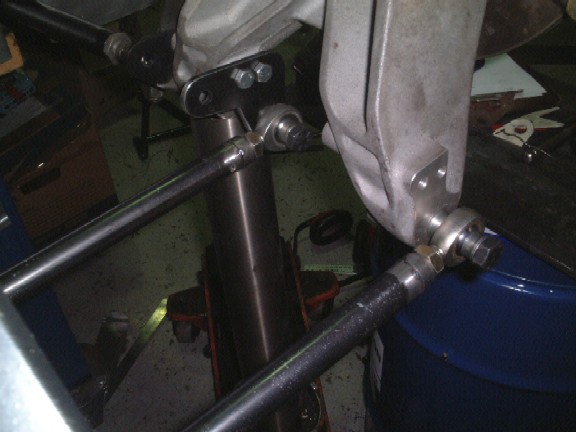

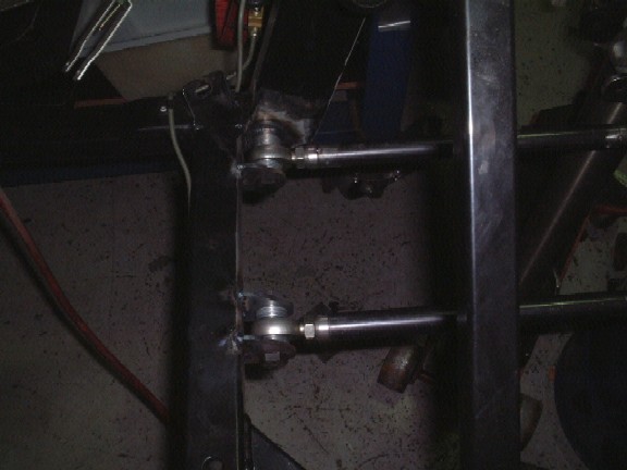

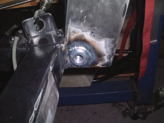

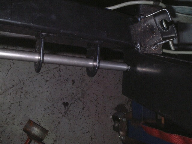

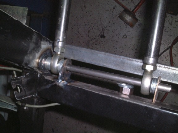

This is how I went about it.
Pic 1 made a punch to mark the spot using bracket as guide.
Pi2 machined spud with thread & weld in hole.
Pic2 Make brackets.
Made aligning tool to locate rear brackets.
Pic3 links.
The front lower rose joint did go between the shock bracket & the upright.
To get it to line up to the chassis it had to be moved to the other side of the bracket & a spacer is fitted where it used to live.
I drilled all the link bolt holes in the upright to ½ “& put larger bolts.
If this can help anyone good luck.

Jim has fixed his bump steer by fitting solid lower links to the front and rear of the upright but with zero castor the T/arms will still be trying to alter the upright angle and this is why I suspect there will be some suspension binding.

Ok I see what you mean.
No it doesnt work that way with the seperate links with all rose joints.
If I remove the trailing links I can rotate the upright anti c/w & clockwise due to rose joint swivel.
When connected and it goes through its suspension travel the top link cancels the movement from the bottom link.
If you start out with zero caster you pritty much end up wth no caster change as I see it unless your trailing links are different lengths or a front location problem.
Like I said Im no expert on this I suppose if you have caster to start it will increase on bump as the top link
gets longer & the bottom shortens it rotates the upright back at the top and induce anti-squat as Ross explained.

The pick up point has been moved but only further apart in effect it is still in the same spot.
It is still on the same plane.
Instead of being in the middle it is now 165mm apart.
The reason the bump steer goes with seperate 2 single links is the chassis the 2 links & the upright goes from a square to a parallelagram when pushed rear ward by the t/arm..
The single pivot at the centre as per std arcs back as the t/link length changes.
What it is doing by changing to 2 lower seperate links & yes all the others are rose jointed (no bushes).
It is changing the dynamic path of the suspension from arcing to parallelagraming if there is such a word.
With the original system you have to pull 7 deg to fix the problem which is fine.
With the 7 deg you are left in a position if you wanted to adjust how much squat or anti-squat (not moving front link hieghts) it cant be done at the back by adding or subtract caster as it will change bump steer.
With the links it allows you to change the caster to get squat & anti/s with no ill effect on bump steer.
It is the shape the 2 different designs travel through.
If Im wrong on any of this Im man enough to admit it but it seems to have
worked out.
